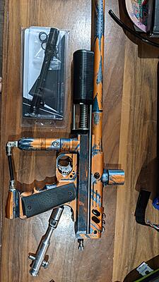

    I was trying to buy a new bolt for my 98 STO, apparently I goofed thinking it would be just a pre-2K bolt. Anyone know for sure what bolt I'd be after on this guy? I'm thinking it's the evo. Silver bolt on the right is the one that fits.
    • 4509
    I don't know for certain, but that absolutely looks Evo p-block to me.

      Wow, sweet gun! You need an Evo/STO length bolt.
        Thanks, it's my baby. Haven't played in years and it's the only one I kept. Doing a little work so I can play with it again.

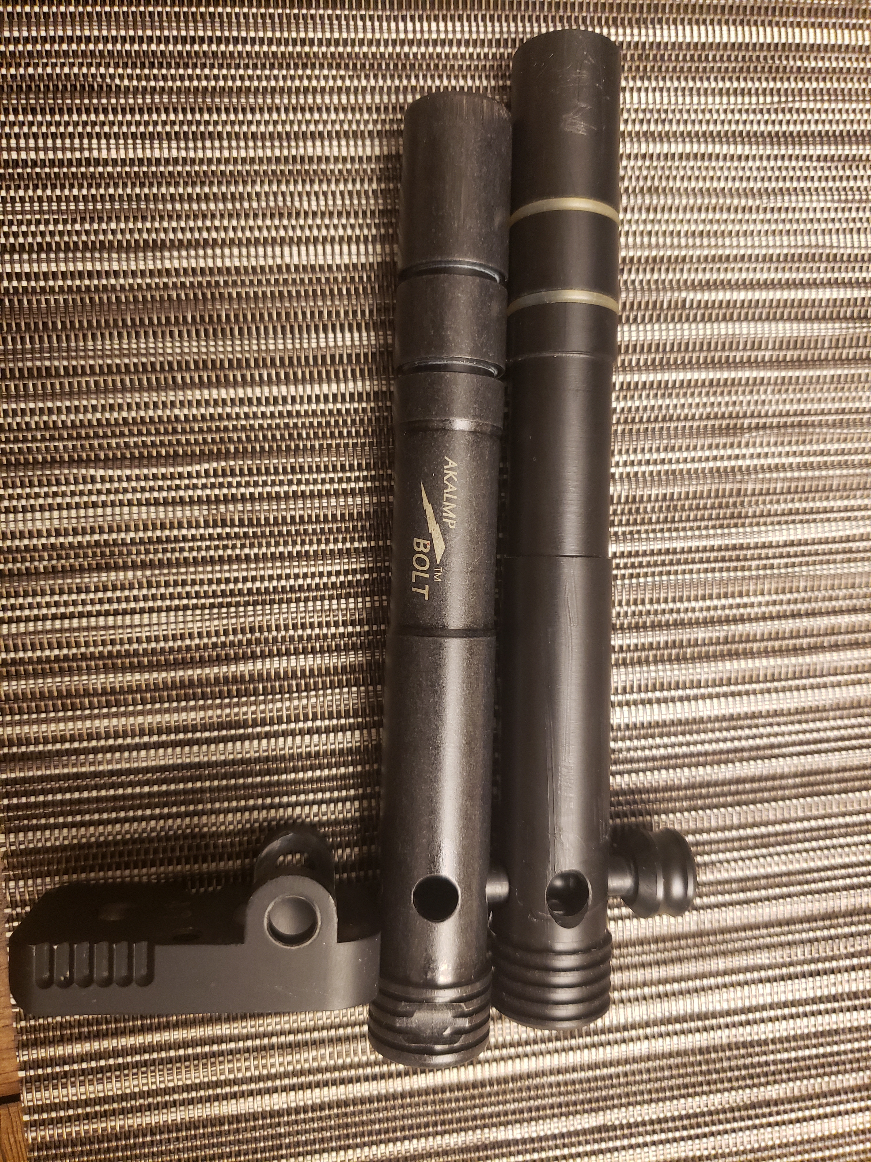

                            Visual aid. Longer is 2k, shorter is evo/"sto"
