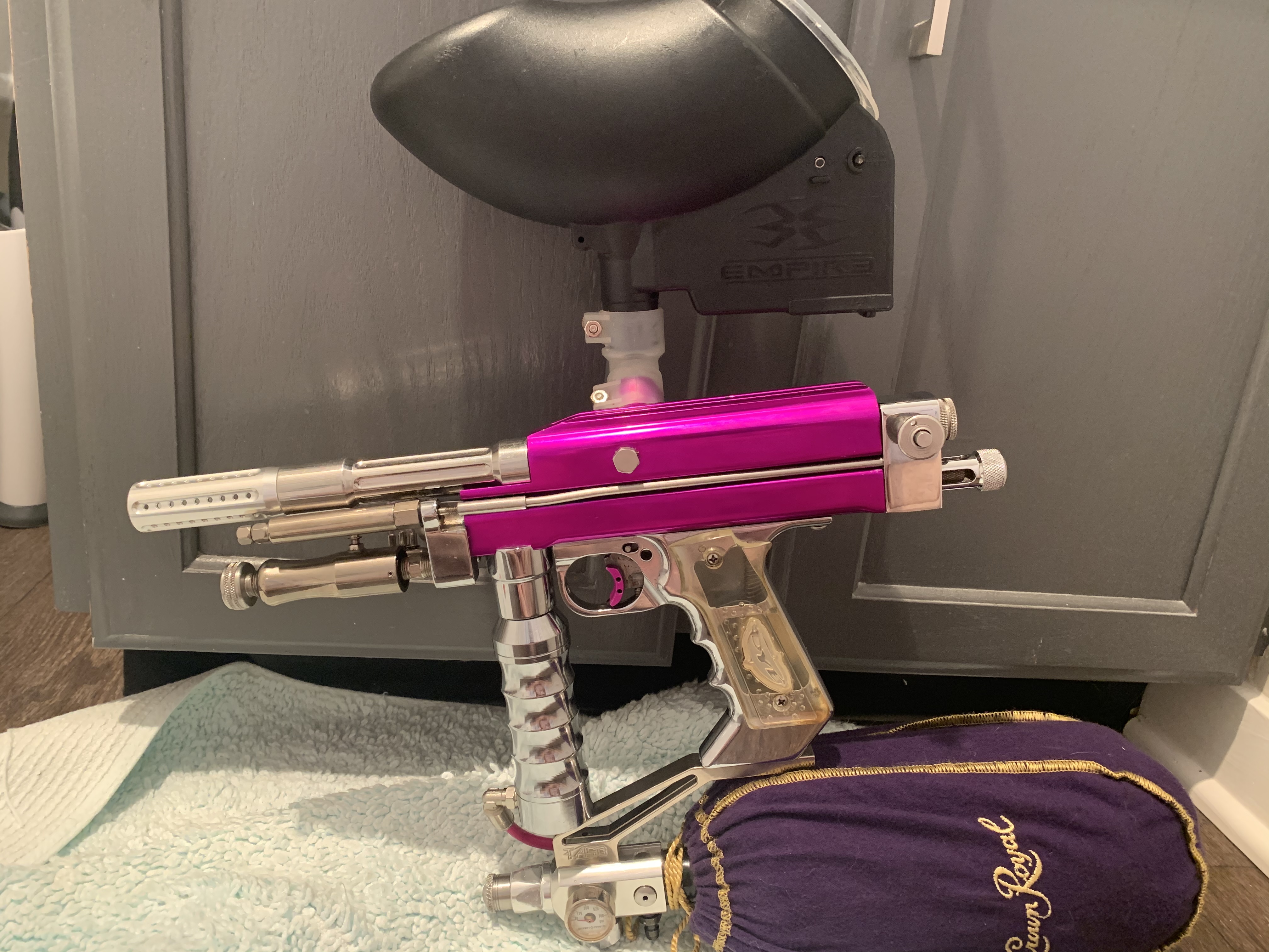

                This one [obviously] didn't have one. The lower tube was bored out far enough that the front frame screw needed to be teflon taped. I threw green/green madmann springs in it and it shot 290 ish.

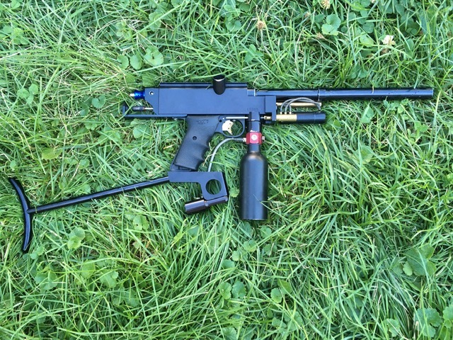

                    No reg on this old bird.
                      ooh I like this

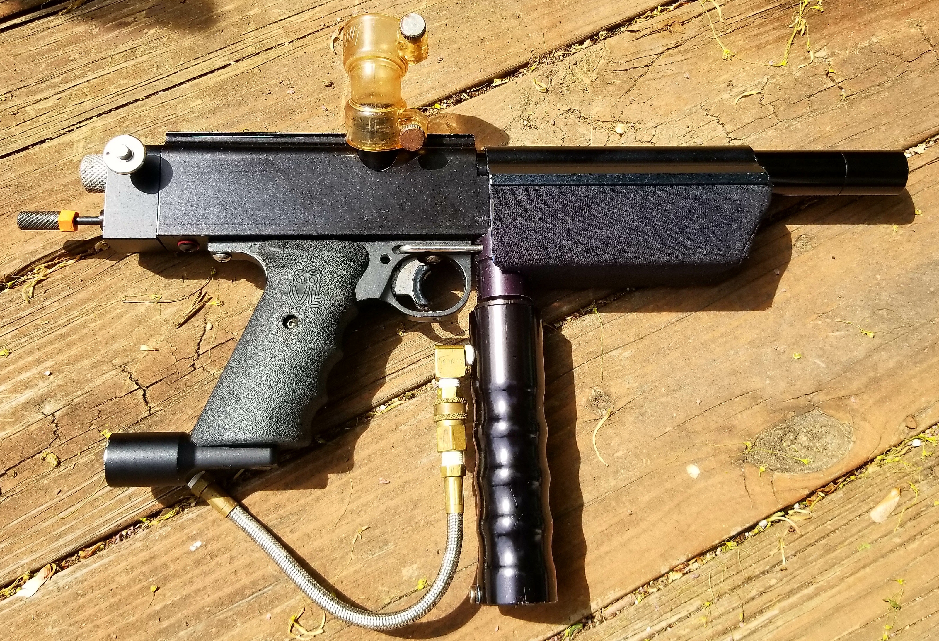

                    This is the 'cocker in question. I have a set of newer internals but I'm sure I'd need an inline regulator with the springs I have. The goal is to make it a simple workhorse. It would be nice to make the trigger smoother and a tad lighter. The 3-way is the old brass style with cir-clips.

                      I changed the setup to more what I was thinking. Got rid of the heavy silver vert ASA. Took off the bright red Kapp beavertail as well. Going to test it further without an inline/bottomline regulator.
                      I did try it with a vertical 13ci and L-stock but it felt a bit unwieldy.

                        Boy, that's looking good Hobbes.
                        • Hobbes
                          Hobbes commented
                          The rust baked into the cocking rod really ties it all together.
