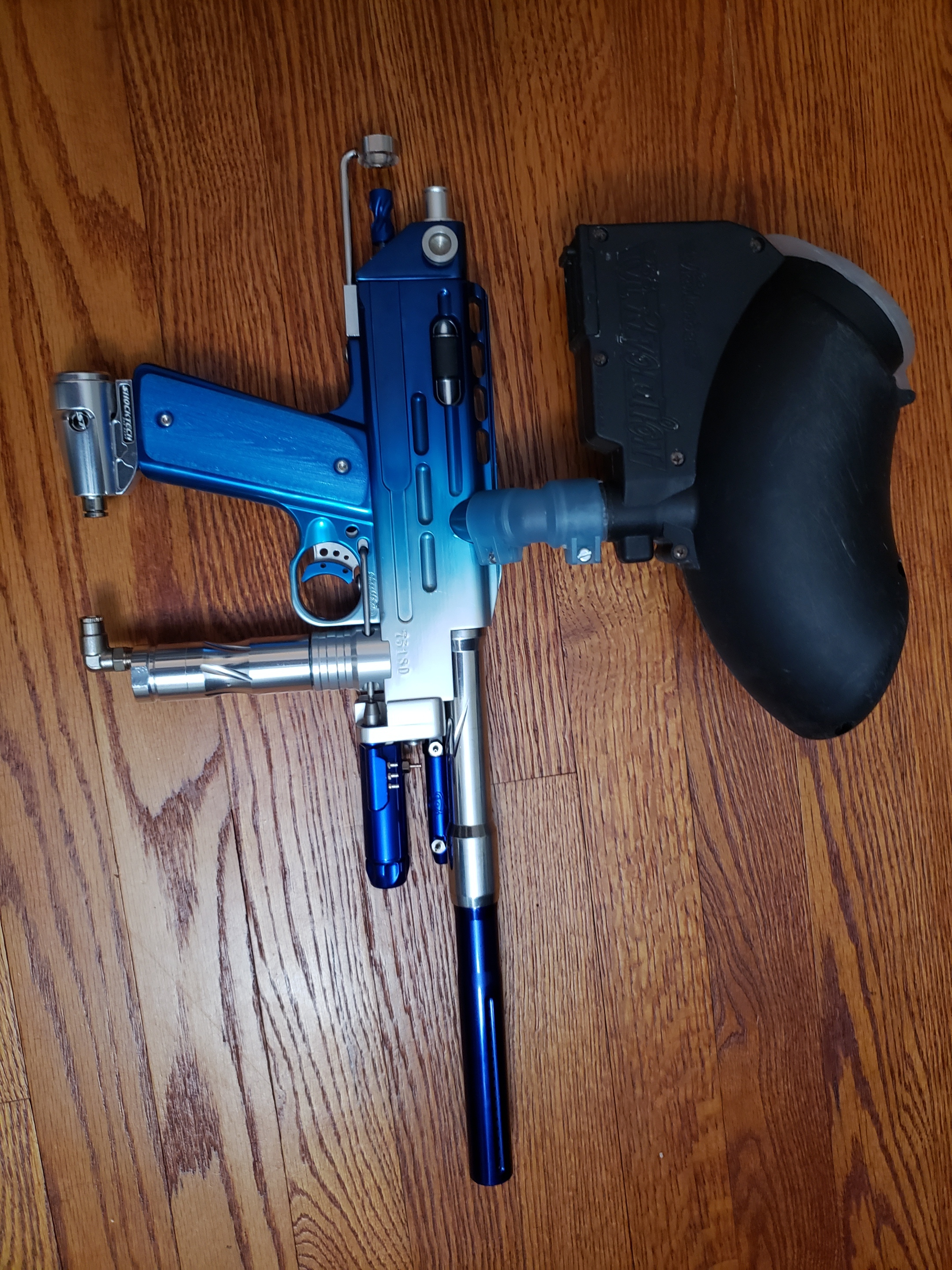

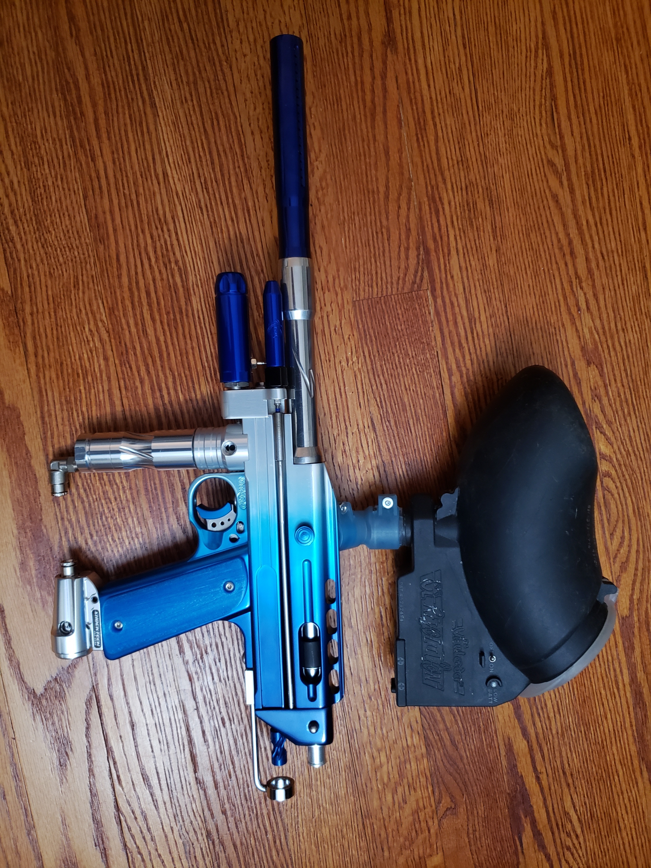

    So quick update on my Vortex. With the help from a couple members here and purchases elsewhere, I've got her very close to being done.
    Replaced the old trigger plate with a new ST unit, and a NOS aluminum dual roller sear. New ST springs in the frame, as well as for the hammer and valve.
    Kept the old brass ST valve, and got a ST Phat Hammer for it.
    Keeping the Inception front end for now, as well as the Gladiator reg.
    NOS ST Mini Rail and Pro ASA, and a set of 3D printed blue plastic grips round out the frame.
    Also kept the old ST bolt, pin and the cooking rod (even though its not ST, I like how it looks).
    Set up with my old 12 volt Revy and a PTP elbow.
    All I have left is to buy a tank to finish the timing, and sweet-spot the regulator.
    Can't wait to sling some paint with this bad boy.
    The only thing I need to fix (not sure how) is that the back block sits a little crooked. No mater how I spin the cooking rod, the block still sits a little crooked. Maybe I need a different one?

    Very nice, always liked the look of the Vortex. If you can, try a different back block to rule out the current one being wonky. If a new one still sits crooked then probably the pump arm.

      I agree. Might be the pump arm.
    • latches109
      latches109 commented
      And or the ram shaft

    Looks excellent. Those grip panels and the detent give it some really subtle & beautiful accents.

      Did you print those grip panels yourself? If so is there an STL model available???
      Come to think of it I can just make them myself...
      I think I might have a business idea here... LOL
        Alexndl commented
        There are some stl file on thingiverse, search for 1911 grip panel
      • BlindFaith429
        BlindFaith429 commented
        I got them off the-bay. Users profile name is Stryker custom. They were listed for empire resurrection, but I had him open up the screw holes a little for the bigger 8-32 screws on my frame
