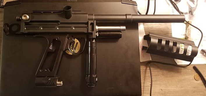

    20220402_122803.jpg Taking into consideration that a pre 2k mini has less volume than newer cockers/mini's, which valve offers best performance for a pre 2k mini? I will be using a volumizer, am I wrong with having the impression that the benefits of an AKA valve will be lost? I'm in posession of some older WGP brass valves that shine up so nice for a new build. Looking for some community findings. Thanks!

    you can use an aka valve, they are in the revenge 2 minis with an aka mightymax volumizer. This one had issues with the inception v2 reg, as soon as I swapped it for the aka 2-liter all the problems vanished. I have a stock WGP valve in my other mini with no volumizer but it's a pump so airflow is not an issue.
