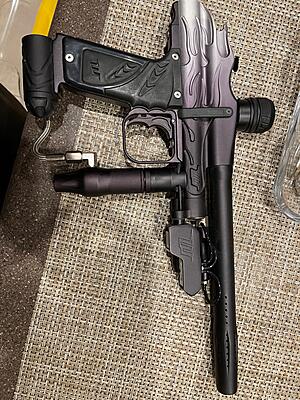

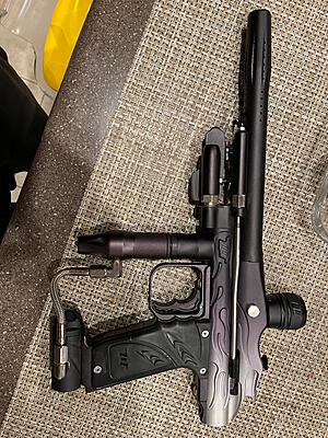

    My brother in law is giving me this. He has barely ever played. He only used this a few times and was running co2 through it. Once I talked myself out of slapping him I informed him he would be handing it over to me no questions asked.
    I know this is an electric autococker. I used to be an autococker tech for the mechanical ones back in highschool. What I don't know is what generation this one is. Seems like its a WDP. would this be tournament legal or would I need to upgrade the board?

    05 Black Magic, sweet marker! Not sure about being tourney legal though...
      • 4472

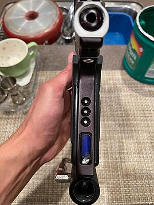

      Has a PE board, so E1, E1 Zero or E2. I don’t know the difference from looking at the frame. Guessing Zero Board. Better than the SF board that came on later ones.
      You can keep it as it is, convert it to mech or even pump. Great pickup!
      • moving_target
        Wicked Smaht
        • 518
        • MI
        you would need to buy a Sci-Fi board to be able to use modern tournament modes, that said they are great boards and add a bunch of functionality. When the maker is able to get more boards, the current silicon shortage is murder as you can imagine

          just by seeing the screen its a e2 or zero b. likely a e2. open the grips or throw a battery in it and find out
          (WGP by the way)

              To know which board it is just put a battery in from the side of the eye and press the center button 3 second, the version will flash. Since the screen is blue its either a Zero B or an E2 (both are really good)
              2k5 black magic have some value too, lot of people are looking for one in good condition.
              The gun look stock with no apparent upgrade.
              Move the bolt by hand to confirm if there is a hammer and spring under to see if it had a MQ valve installed or the stock internal (picture of the side without the grip will confirm everything too)

                    It likely doesn't need much work, and the board is perfectly fine even by today's standards. Sci Fi board are awesome but can sometimes be hard to get.
