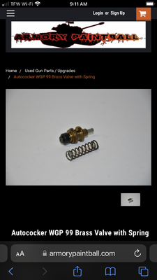

Does anyone know if this pre2k will fit in a 2k?
Pre2 valve question
Yes... as long as your 2k body is a 9/16" valve (ie: not a Trilogy/2k6 Black Magic/etc. - those take the 11/16" valves). -
As Jordan mentioned also keep in mind that the supplied spring may be pre97 and it will be shorter than a 98 forward spec valve springComment

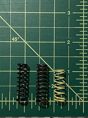

To know which one, This is what I have found out from what I have built in the past: Post-2K valve springs are 1.25β-1.375β in length and Pre-2K valve springs are 1β-0.875β in length.
I have β98 Autococker with AKAβs 97 valve spring installed (Not shown in picture) and fits great which measured 0.875β length.
This gallery has 1 photos.Comment
