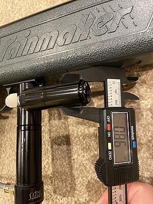

    Can you all help me out? Trying to get parts together for a build using the Mozak slim frontblock, and the Shocktech LPR is too thick to fit. Looking to see if anyone can get the OD of a few lprs before I start going all trial and error.
    AKA SCM3:
    Palmers Rock:
    Palmers MicroRock:
    Inception Designs:
    Empire:
    Any others I should be looking at? This will be a "high" end build, so want to keep things somewhat high performance.

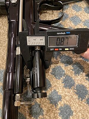

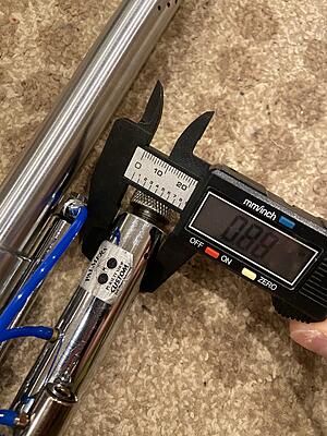

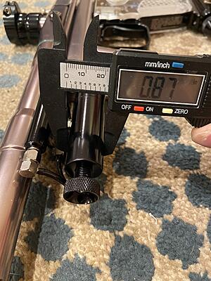

      Not sure if these pictures will help you but aka, shocktech, palmers, palmers. I’m not savvy enough to know which model LPRs just the brands.

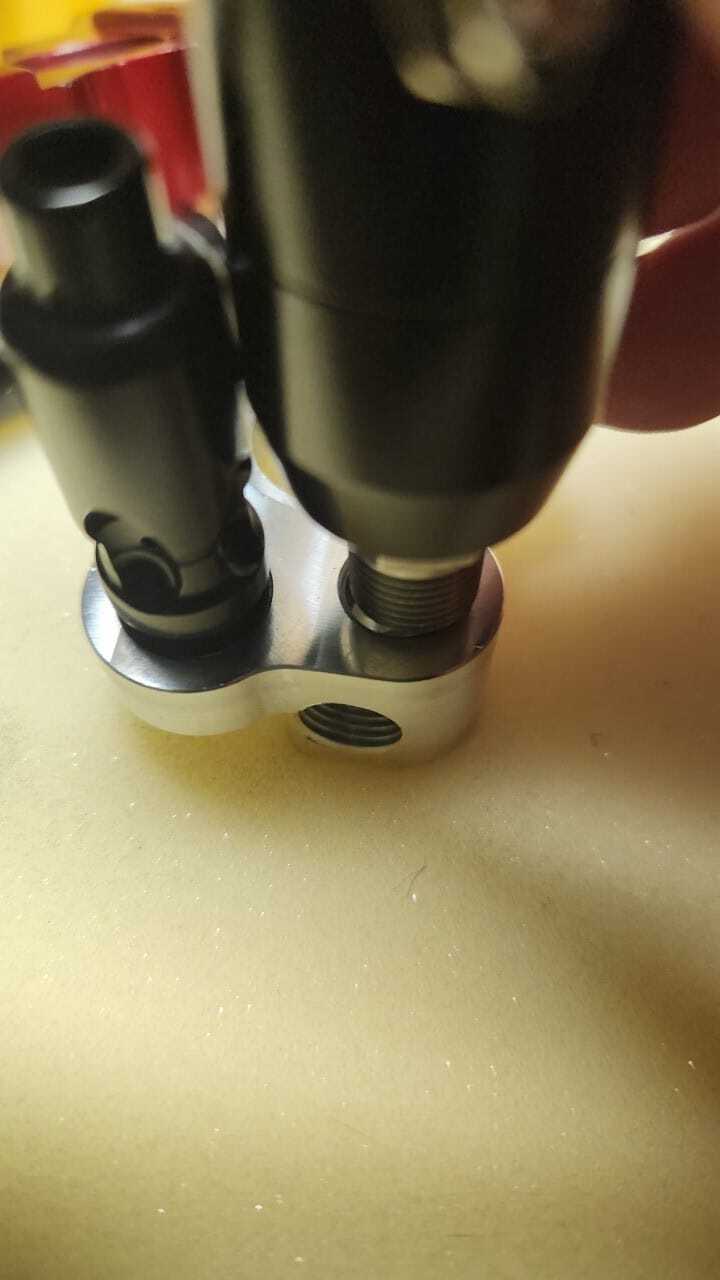

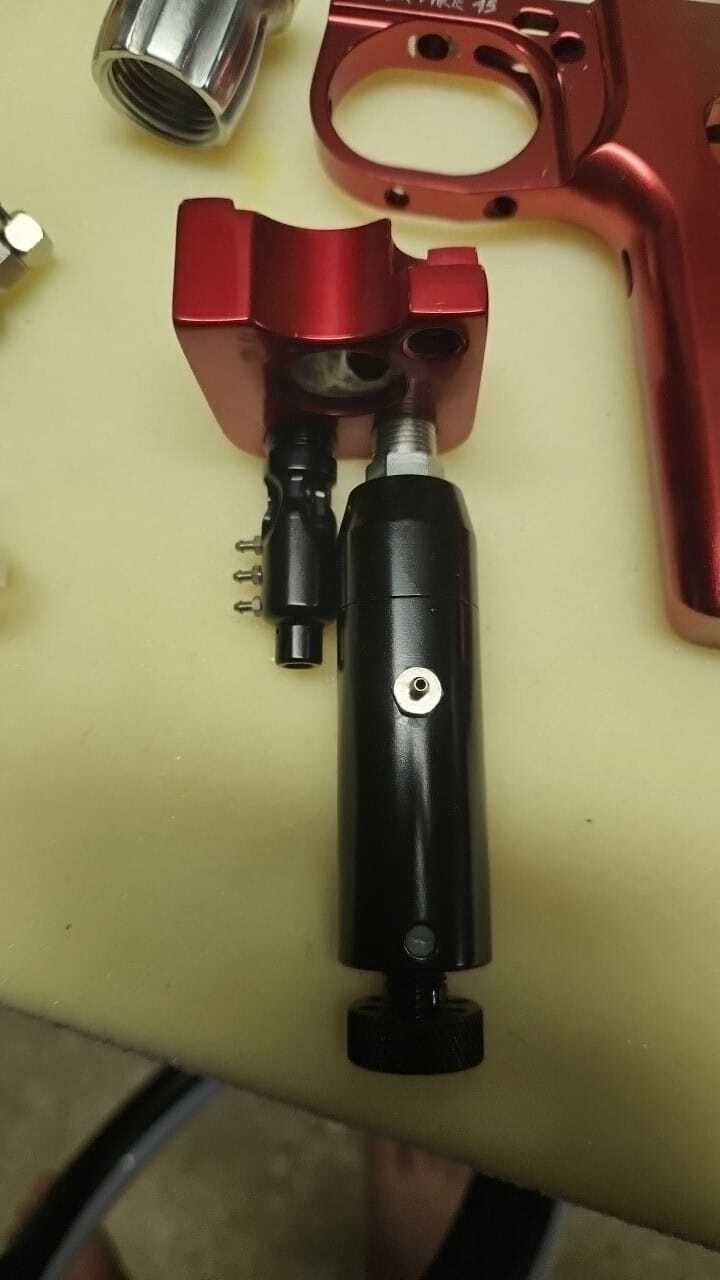

        It's definitely the LPR. The Mozak frontblock has the LPR just a hair closer to the 3way, like 1/32", just enough to make it not fit. Not sure if it's a machining oddity, or a deliberate choice on Mozak's part.

      Comparison Super69ur
      2k:
      Mozak:
