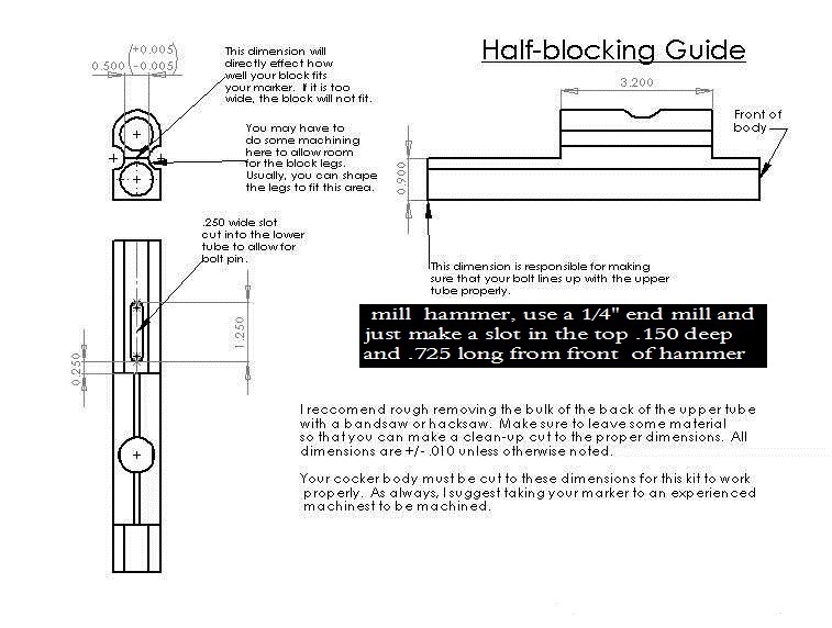

    I'm trying to get some dimensions for half and midblock conversion cocker body.
    Does anyone got print or dimensions they'd be willing to share?
    Also, for the hammer, would it be easier to get a half\mid block pre-made hammer or make one from scratch?

    I'm almost positive this question has been asked and answered on here but the Search function doesn't seem to be finding it.... so here's the halfblock dimensions that Mad Customs used.
    Click image for larger version  Name:	46947d1415834237-madcustoms-marketplace-bodydrawing.jpg Views:	0 Size:	93.1 KB ID:	337551

      That's the print I was looking for, I thought I had it somewhere but couldn't find it.
