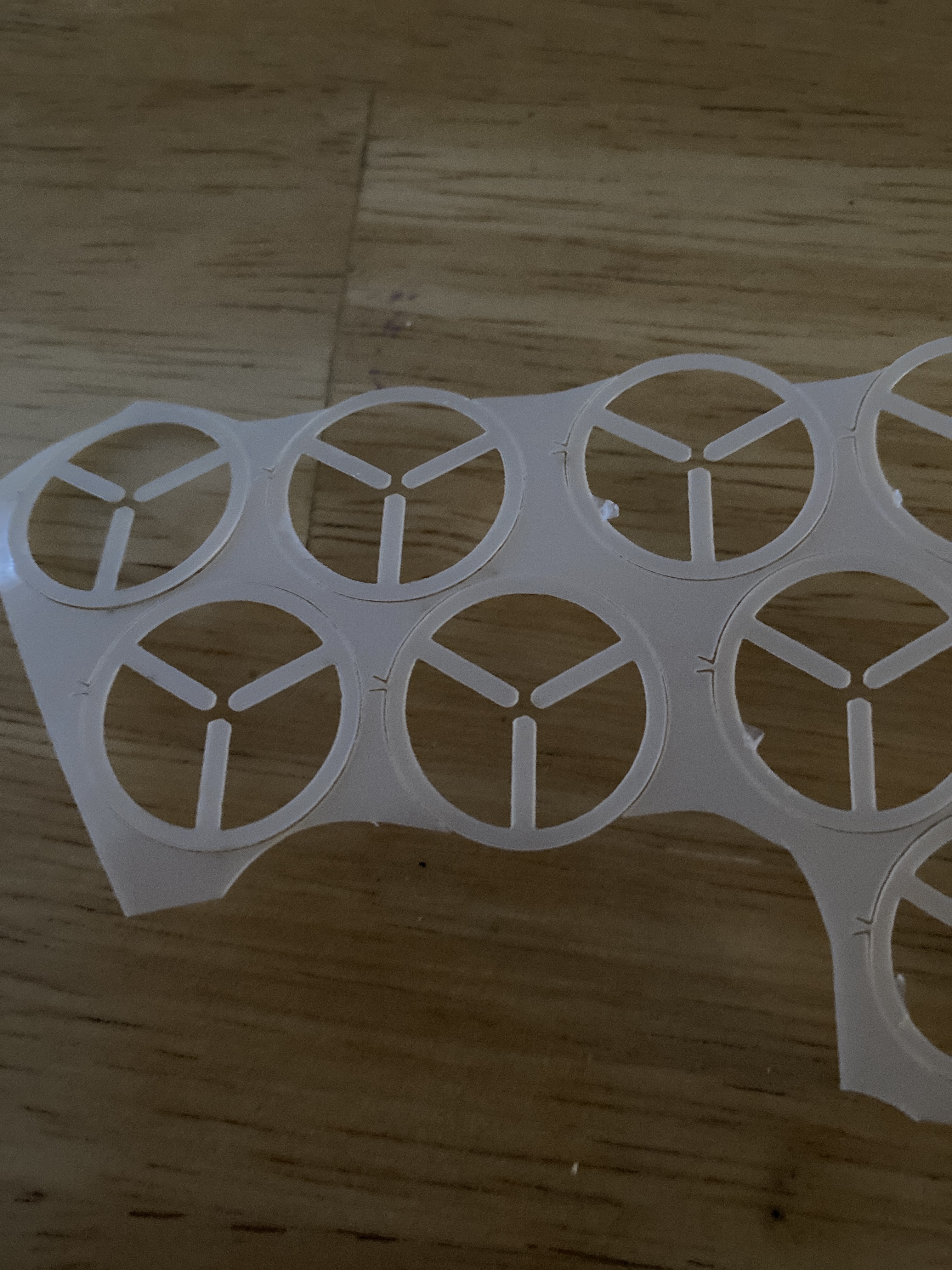

                Why not just get a smaller back for the UL tip. I run a 681 on my open class pump and if I get rollouts I put the detent fingers behind it never had an issue. I have all kinds of options but I just keep some of these laser cut ones in the tool box JIC. Just make sure they are sandwiched between the barrel back and body and they last a super long time. Haven’t had issues with breaks with them.
                On anything with detent it don’t matter what you put in front of them as long as the detent system your using is functioning properly.
                My SC markers I’m a lil more particular as to what barrel I use because I try and get the most pew out of each shot for efficiency reasons. For that I like a good tight fit often freak bore. But if I’m not on 12g the new tanks provide plenty of air especially with these new 4.5k 2” round tanks they sell now. So efficiency means very little to me outside of stock class play. Making the detent rings a great option IMO. If you’re having issues with the printed ones try the ones from Redleader that are laser cut.

                        Dye makes UL-S backs in .678 I recently bought one from LoneWolfPB.
                      • 6380
                      I know there was a small run of CF .675’s but .680 should be more than small enough and the rare occasion you need it smaller you can Always drop the detent fingers behind it.
                      I run a .681 fixed bore tight stick on pretty much everything without detents. I rarely have rollout issues. But I keep the laser cut detents on hand just in case.
                      If paint fluctuates in consistency that much in your area a freak bore may just be a better option for you. I know you said you didn’t want to go that route but Master Sconi has a back that takes freak inserts that works really good with the dye tip. (They come in xL and standard) only real downside to freak is if you break paint they don’t shoot clean like a one piece fixed bore.

                        I hope you have better paint in your area, and then various sized inserts/backs might make sense. Below is why I overbore. If I'm using a closed bolt (e.g., Autococker or pump), I overbore with RedLeaderSB's laser cut finger detents shown above by Chuck E Ducky.
