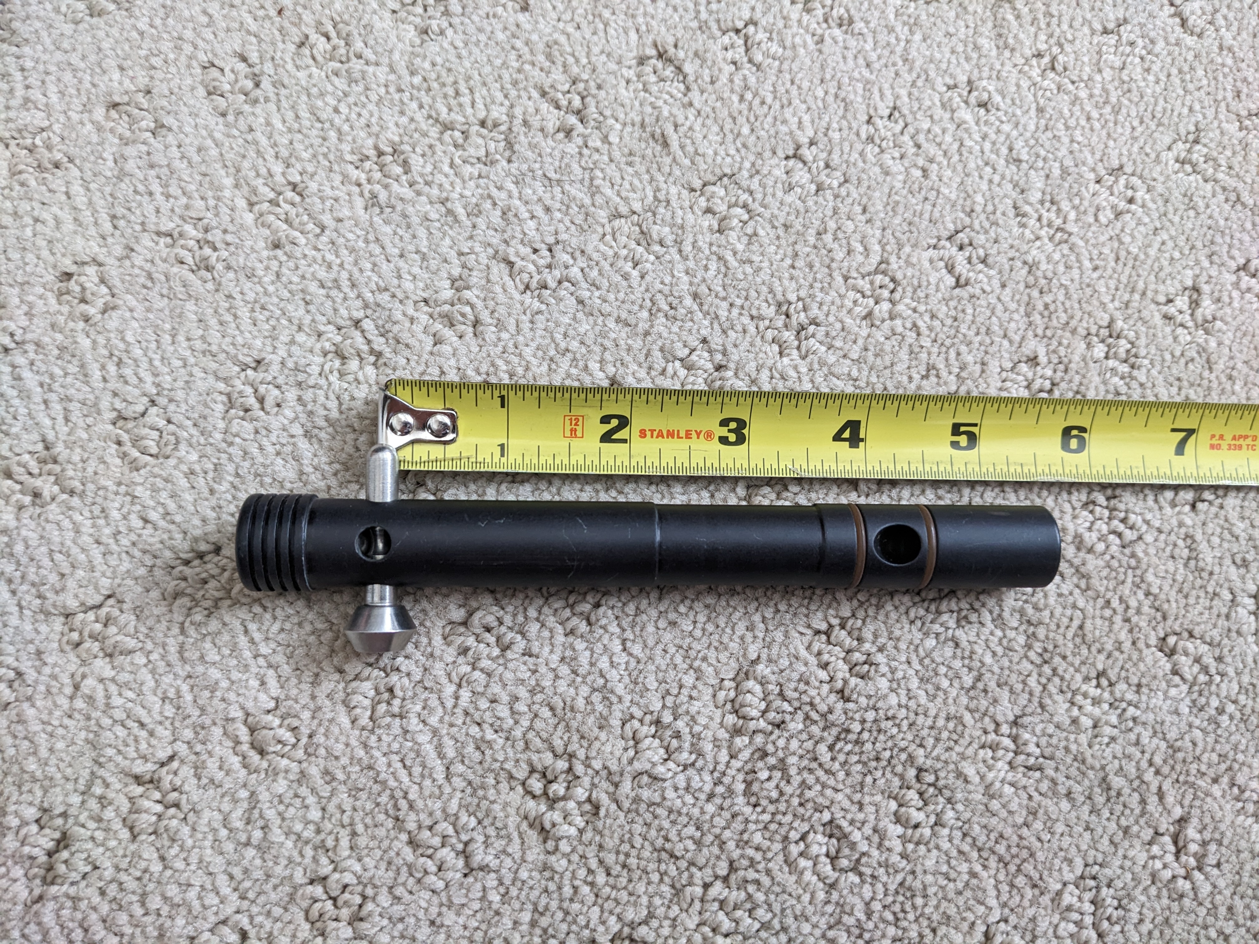

What length is this Lightening bolt?

    Interesting... that looks extremely long?
    Edit: or maybe it's just the camera angle.. Pre2K?
    I have always used this i got from customcockers
    "These are all from the center of the pull pin hole to the center of the air input hole:
    Pre-2k Lightening Bolt:4"
    Post-2k WGP Stock Bolt: 3.75"
    Free Flow P-Block: 3.3"
      Agreed with pre2k. The space between bolt pin and where back block sit is longer on pre 2k. I could rummage through my bits and pieces to confirm....
        also P-Blocks which have a shorter bolt, hard to tell sometimes from a picture.

          • Vegas
          im gonna go with 2k full length
          i measured my pre 2k metal one and the distance was the same, and then i remembered it was the bolt pin location in the backblock that changed
          and i know that there is no such thing as a delrin pre 2k bolt.. so... thats my answer
          also, pic.. cause

          • WORR13
            WORR13 commented
            actually there is a delrin pre 2k bolt
          • Tracker
            Tracker commented
            ill give you that they do have one on their sight now, ive never seen one before recently
