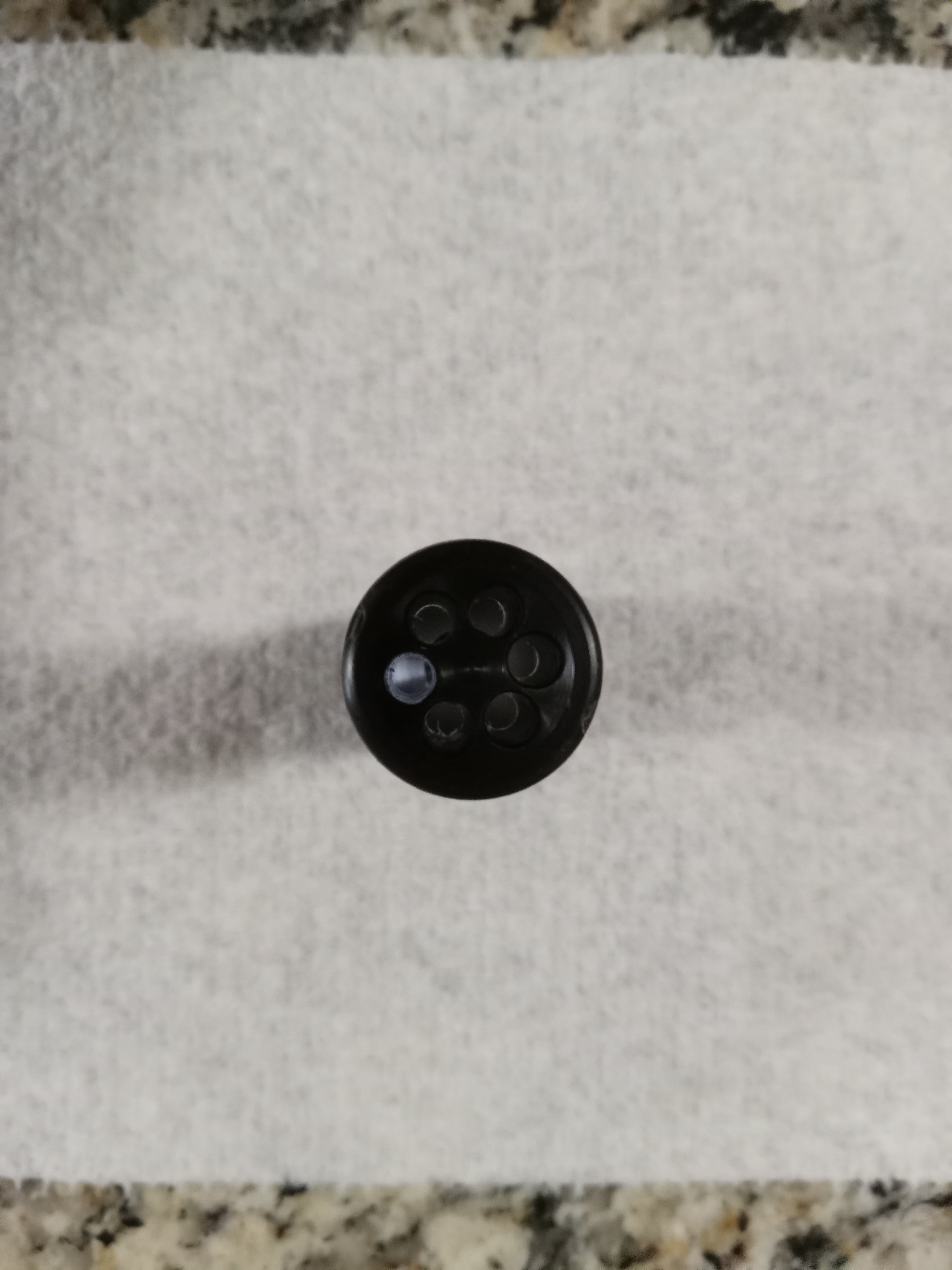

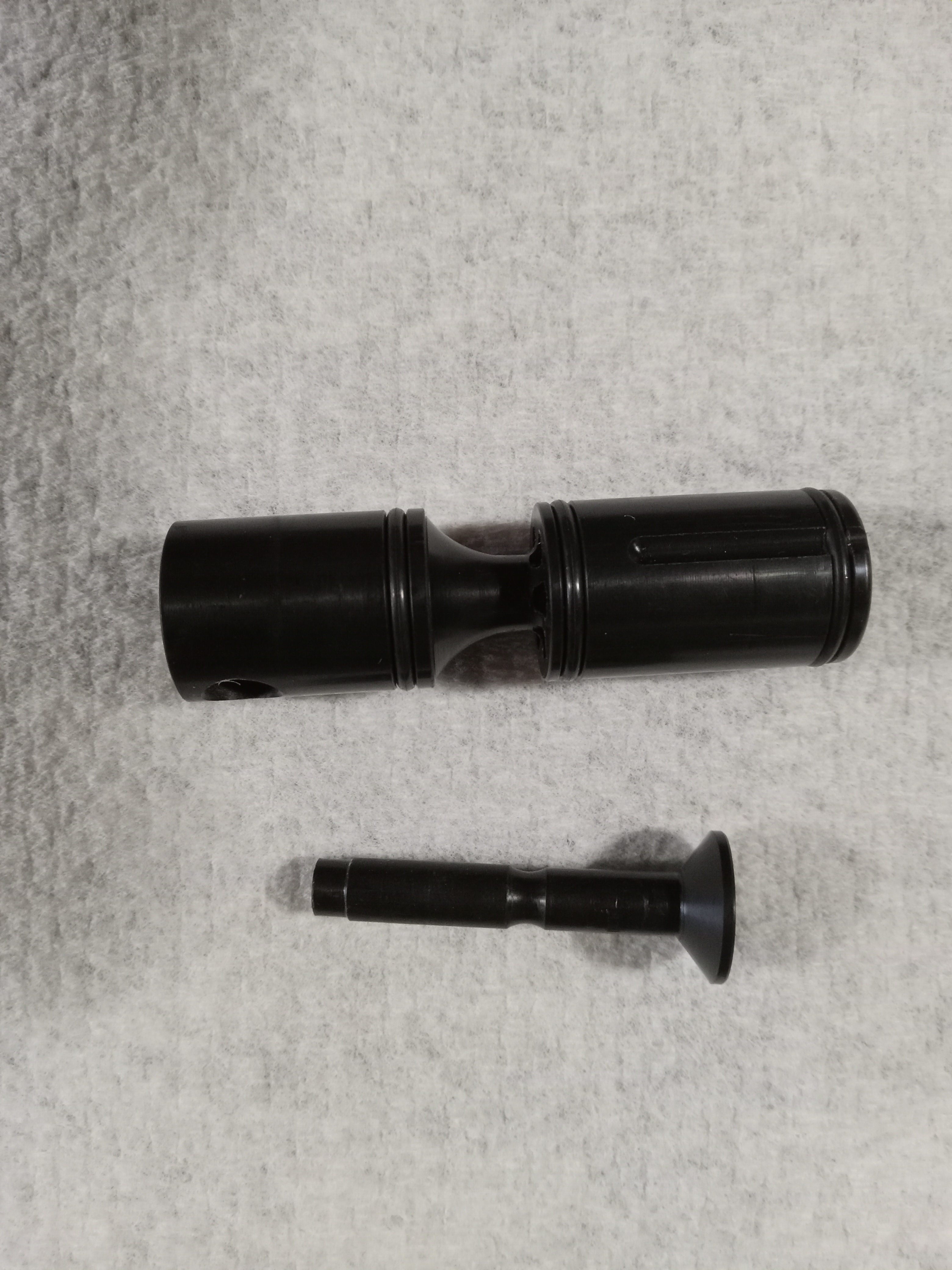

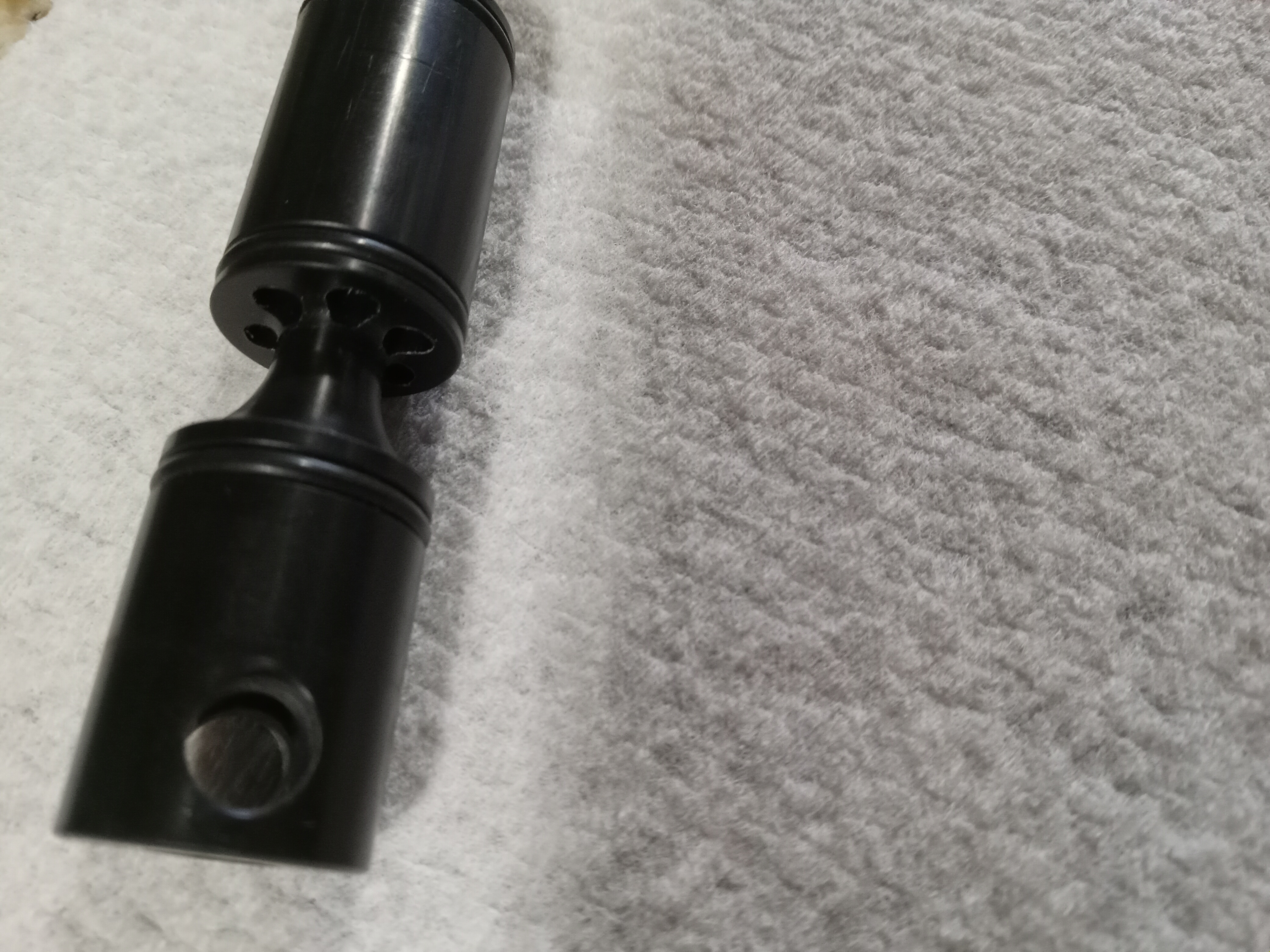

    Ok so this is my first half blocked cocker other then a pump and I didn't own it long, do the same things apply when setting the sled as when setting a back block
    Also what bolt is this, just looking at it i dont like it, why the crazy middle venturi on a half block bolt, i see problems with it is all but what do i know, plus the orings are really tight and theres no bearing to hold the pin, also what about the derlin pin i see that snapping where it meets the hammer at some point

    Look like a Tech T bolt for an empire sniper.
    https://www.techtpaintball.com/empir...h_pr-4835.aspx
    Ball bearing have probably falled at one point. The are not captive in the bolt if I remember right.
    Check with your body if the ventury is a the right spot with the sled at the foward position. The valve screw should line up between the orings (place the bolt on the sled with the pin on the side of the body to see).
    Half block cocker are custom so depending on which spec they where cut, not all the parts worked on it.
    On my half block I had to change the hammer lug to a shocktech cone version for the sear to engaged where I needed with the hammer, sled and bolt combo...
