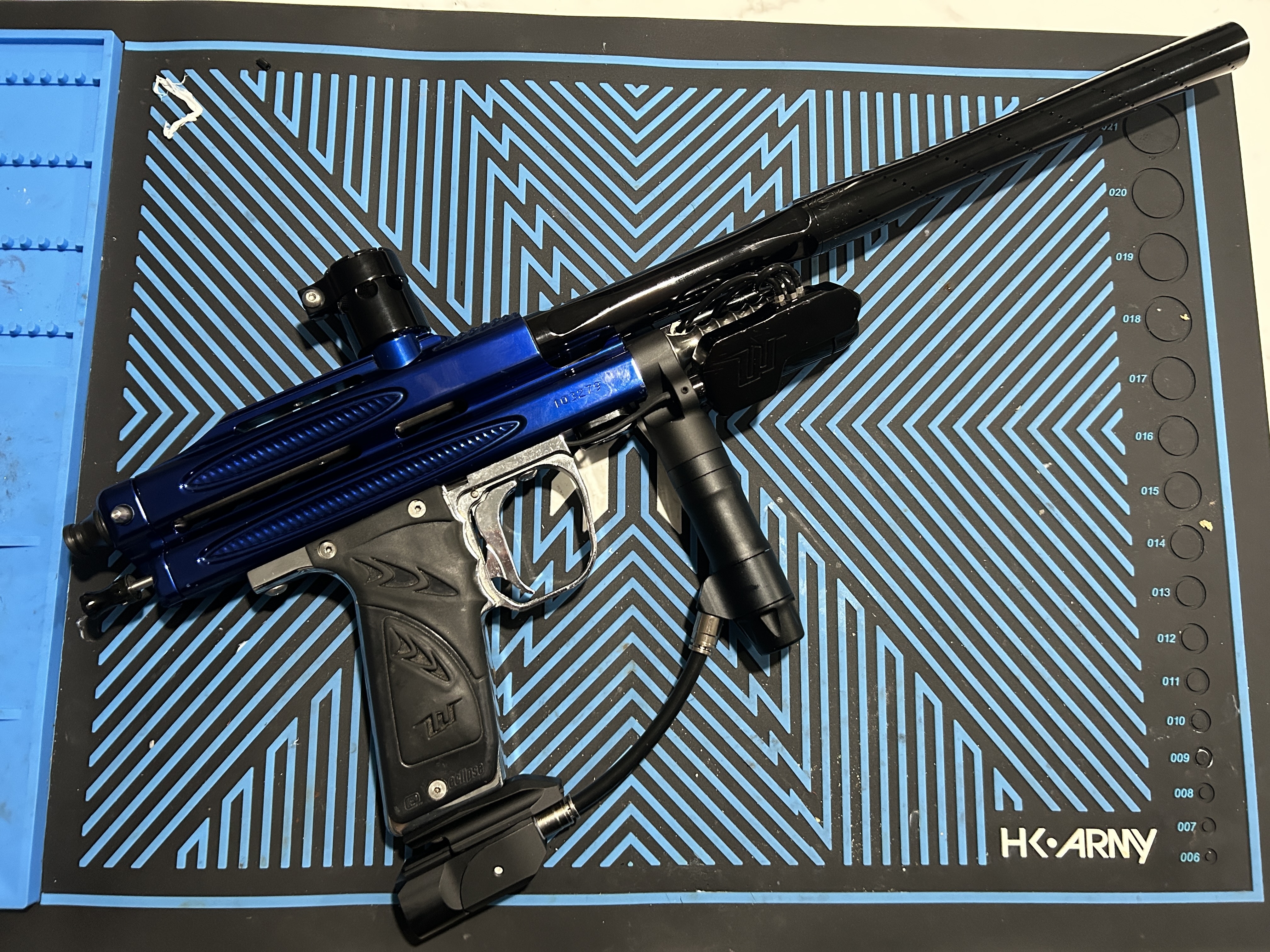

    This Should Be A Fun One
    My wallet hurts.

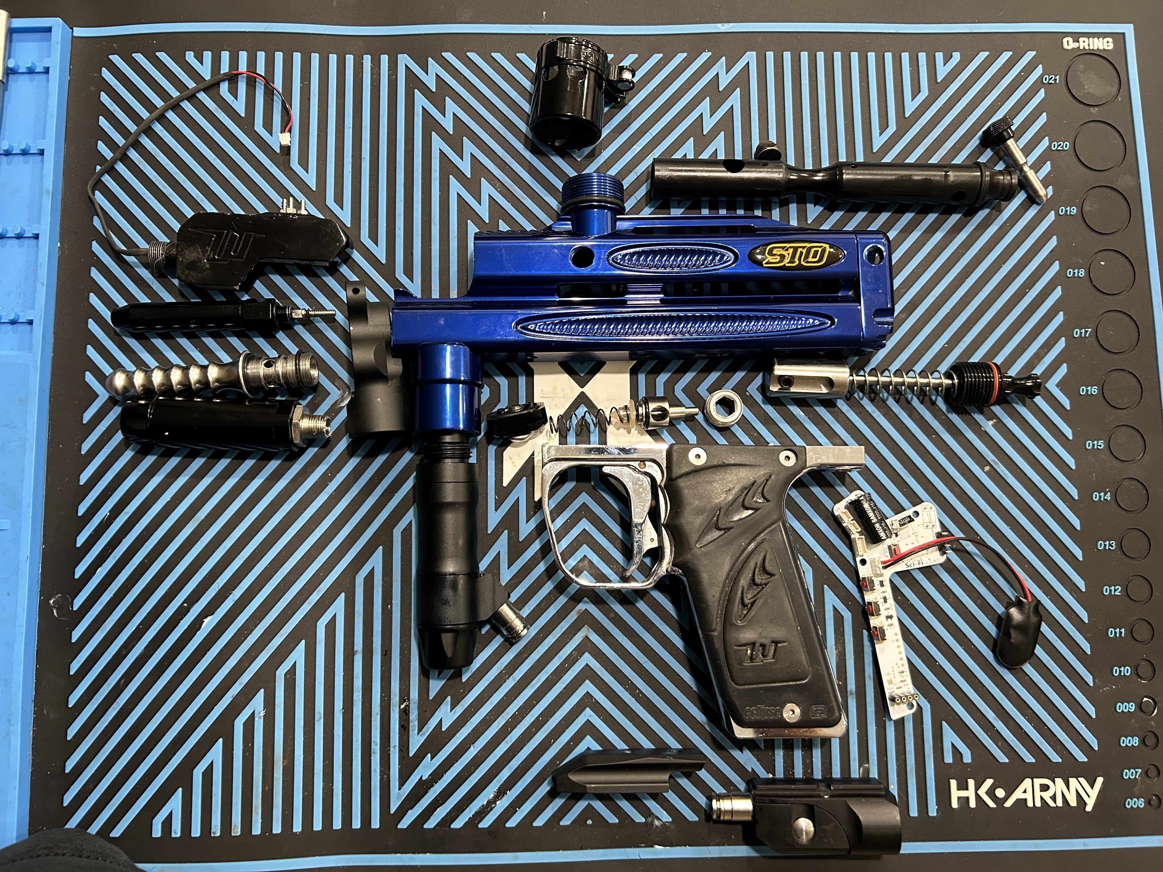

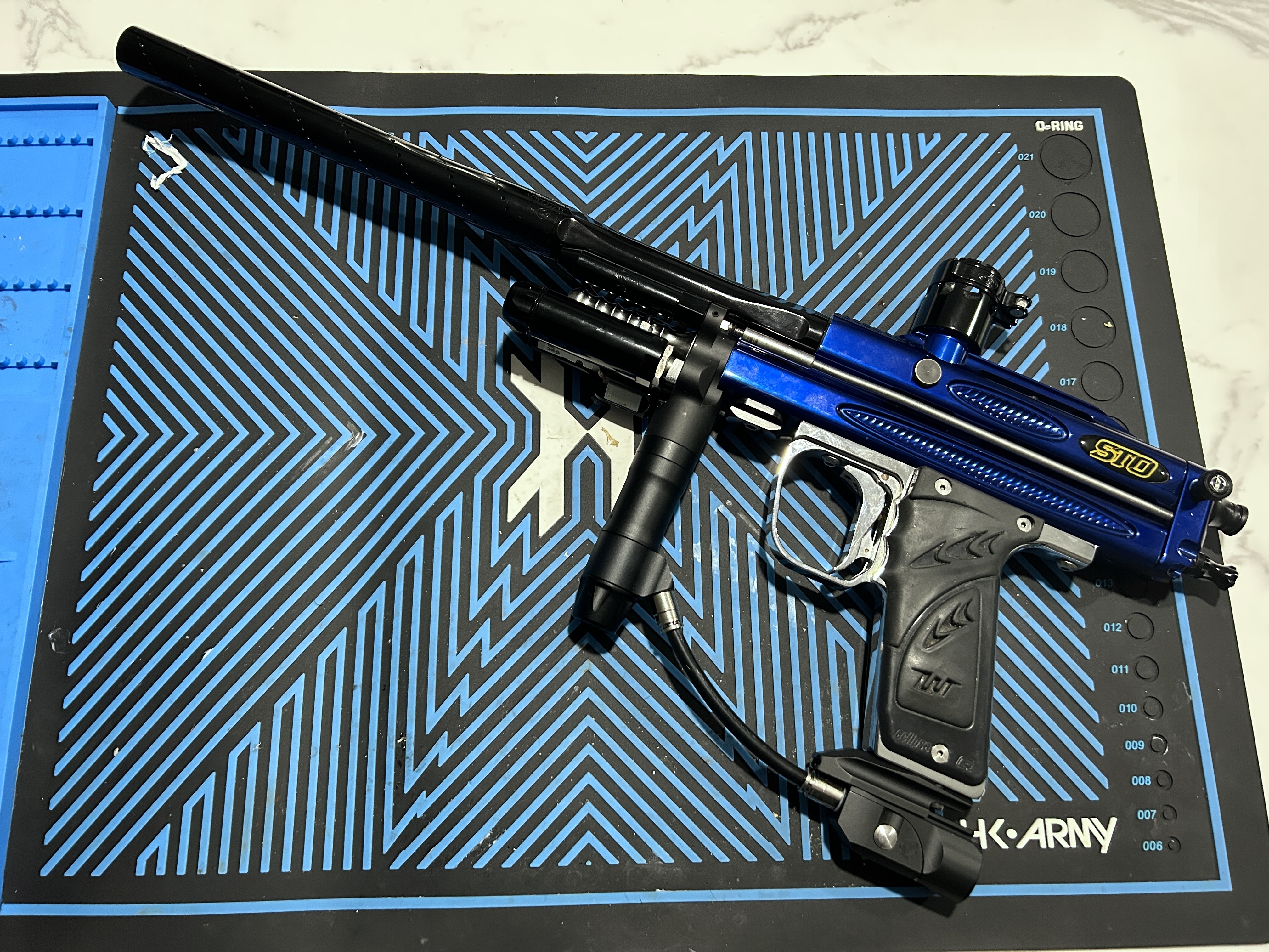

    STO body. Sci-Fi board. Inception Designs lower internals, front pneu’s, HPR, EZ ASA, and front grip extender. Shocktech Superfly bolt. CP clamping feedneck. Stella slimline barrel kit. All done just in time for a New England winter.

    what part did you use to plug the original asa hole when you used the forward grip? i have a build and plan on a similar set up, (black part right in front of your valve body)
    • Psycho91
      Psycho91 commented
      Could probably just use a set screw and some blue loctite to seal it up, might have to grind down the set screw to get it flush if you need to or are like me picky about small details like that
    • Toestr
      Toestr commented
      Inception and I believe another company makes a cap with an oring in it.

      The kit came with the plug

    also looks incredible!!! nice work
      • 6182
      I did the same thing. Just tap it and plug with a set screw
