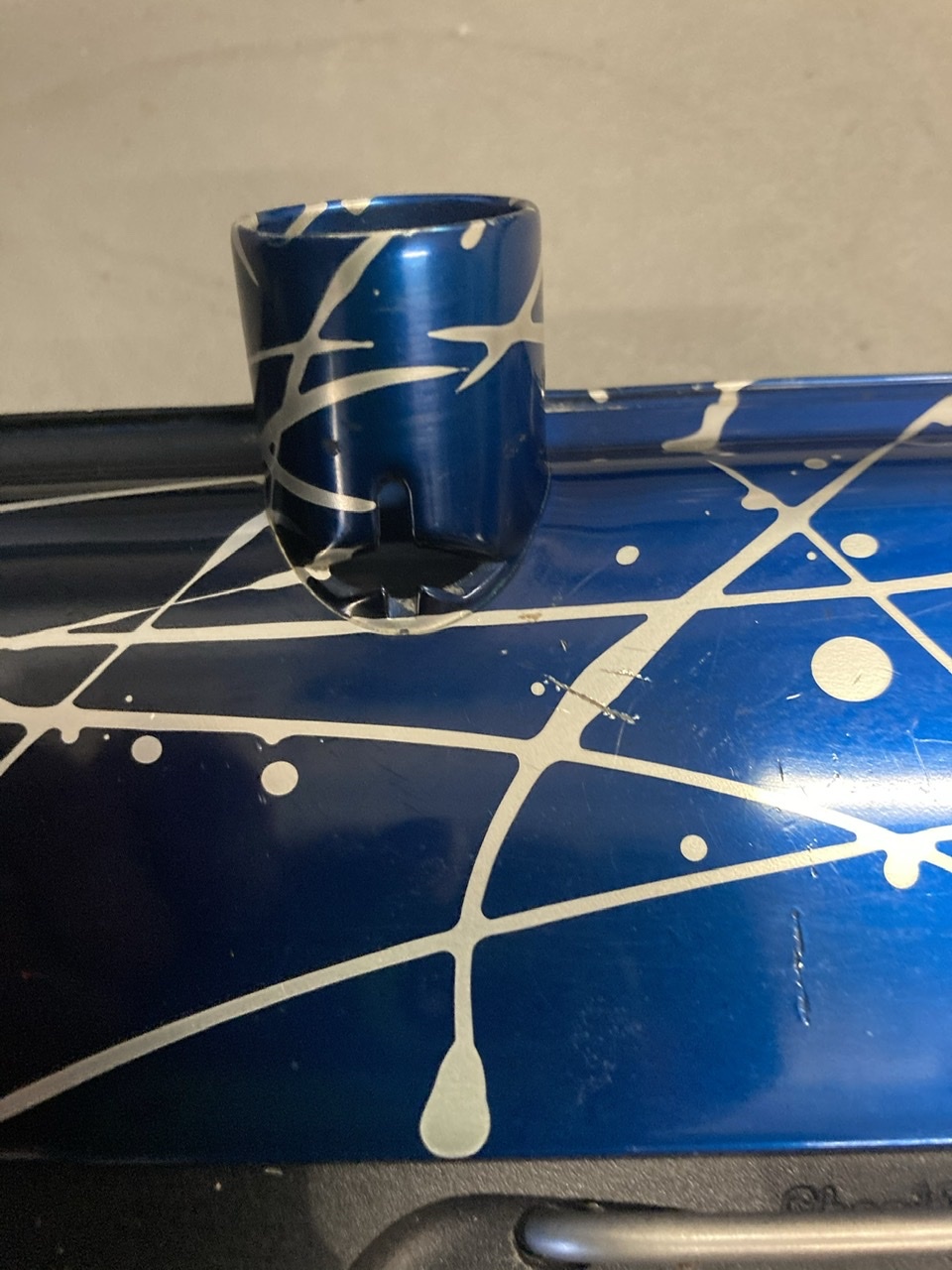

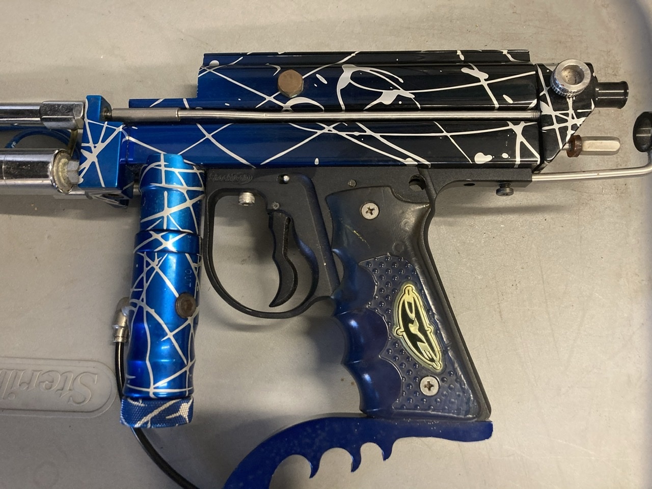

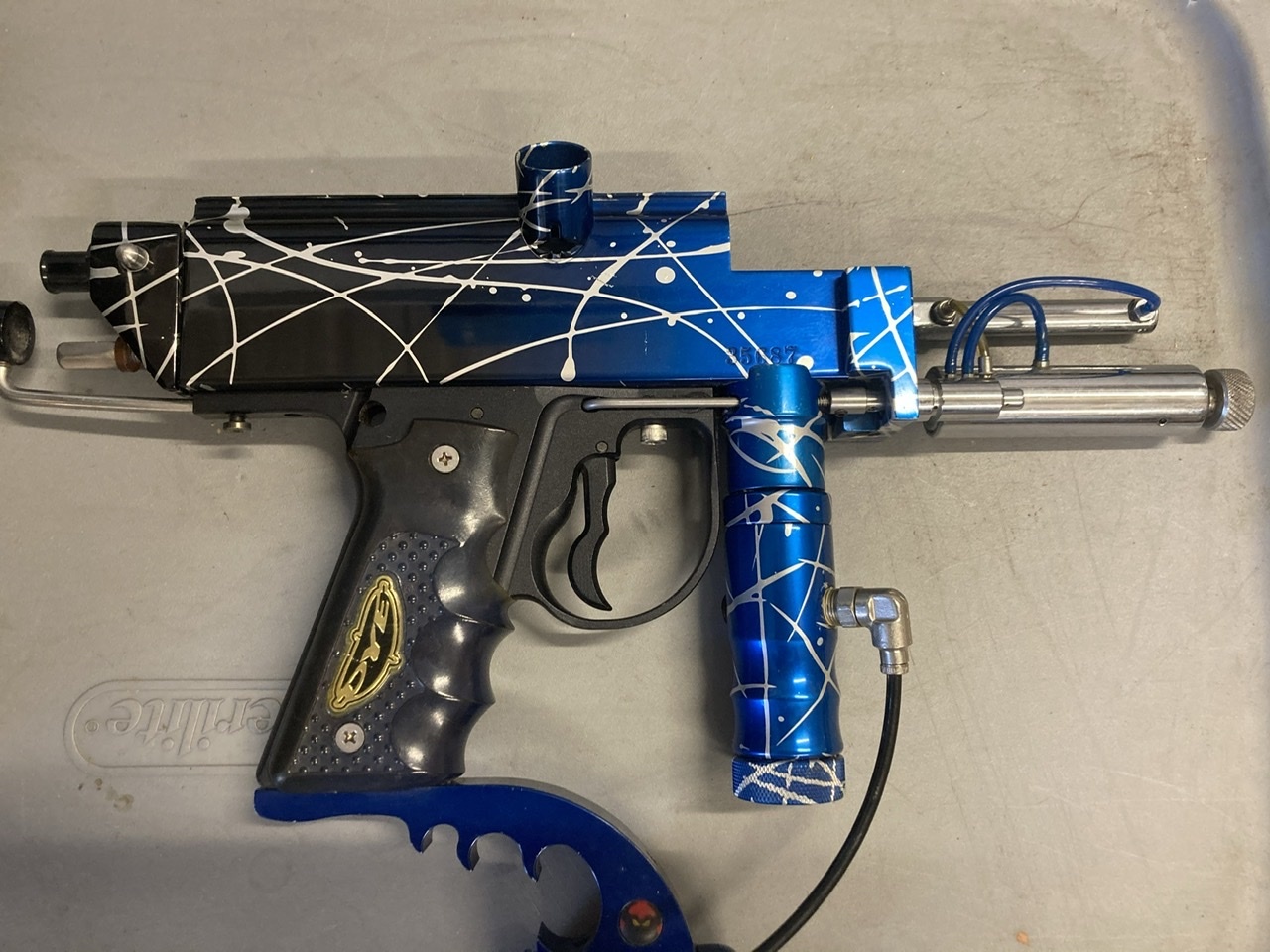

              I could use some help from some of the smart Autococker guys on here. Figure I would just add on to this thread as opposed to starting a new one. Picked this up off CL. Has some Shocktech components. Serial number is 35687. I am really just wondering if anyone might know if this was something someone just sent to get painted or if it was a factory job/private label. Thanks

                With no extra milling, I would say it was a customer anno. Looks good though! Maybe I'm missing something and one of the other old sages will step in.
                • wthomas333
                  wthomas333 commented
                  The only extra bit of milling I noticed was at the base of feedneck. There is a little bit milled out there. Don’t know if that was normal. Pic added
                MCB member
                • 3508
                • Montreal, Qc, Canada
                With all the matching part it make me wonder if there is somewhere a matching ano sliding trigger frame for this beauty
                very nice catch
                The milling could have been done to vent gas to prevent ball stack lift, at least it was done prior to ano

                  Sight rail in front of feed isn't rounded, slanted back block and a 35k serial is telling me WGP '96 body. Matching anno in that style makes me think one of the bigger customizers. Especially with the feed tube mod. Haven't seen that since '98. Anno looks like something from Eclipse or Pro Team Products.
