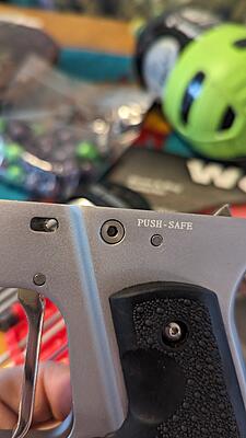

    I feel like I'm missing it somewhere, but is there an adjustment screw somewhere to take up the trigger travel? The older 2k3s and 2K4s have the adjustment screw that's behind the grip panels. Thanks in advance.

    I think that's a trilogy pro frame... It wouldn't have the screw

      That makes more sense. I was going to drill and tap it for a set screw but just wanted to double check before I did that. Thank you

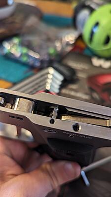

        You could also grab one of those orracle adjustment cams to replace the safety.
        Actually useful here.
    • Pumpytrilly1
      • 566
      Paintball gateway has a adjustable cam that replaces the safety switch.

        I ended up finding one of the adjustable cams on eBay. Works great.

          I was just about to post and let you know about those Cam adjusters. The Trilogy frames are the only WGP hinges that do not have a sear (trigger) stop in them. It's accessed inside the frame by a vertical screw. I never understood why WGP made the Cam Adjuster because that stop was in all their frames at that time. But they're PERFECT for the Trilogy frames. How's it working for ya now?

        At the end of the day I would have preferred the adjustment like on the regular frames. I do actually use and like having a safety. This style adjuster works great though. I was going to put this on my current pro stock, but I think I'm going to use it on my next build if I ever find a cheap body.
