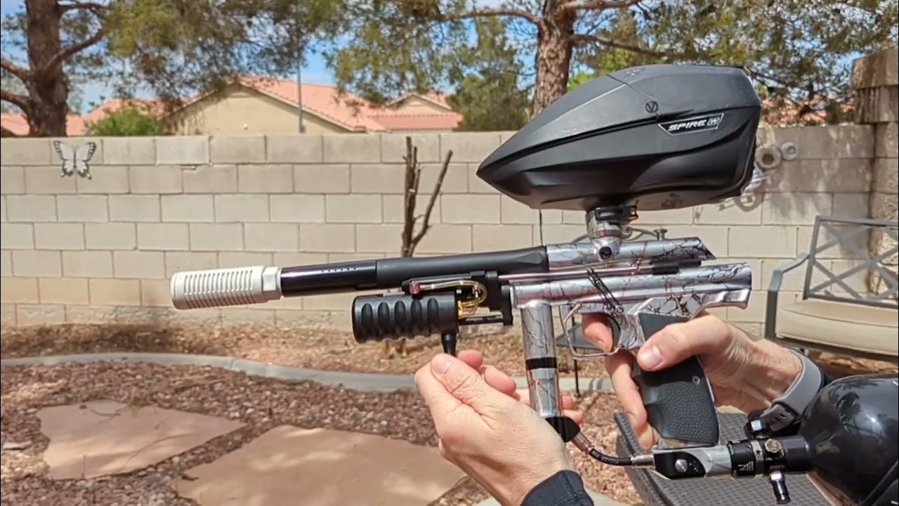

          heey, i just happened to take a slow motion video of the autotrigger on my pneumatic assist..
          the timing is tight, but if you listen closely right when everything slows down, youll hear the clack of the bolt closing, followed by the sound of it shooting. thats what it do
          look at my finger and you see when the lever goes back, the trigger goes forward
