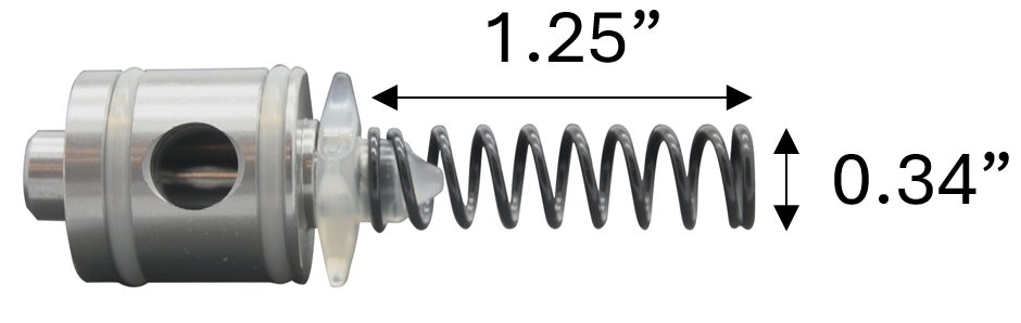

            Thanks for the information so far everyone, it's been very helpful. Another question on the valve spring, looking at images and comparing them to an 11/16 autococker valve. It looks like they measure around 1.25" long and 0.34" in diameter, is this in the ballpark for typical valve springs?

              I have one unknown 11/16 valve and spring (I think it's a stock WGP one). The valve spring length is 1.2", spring OD of 0.332", and a wire diam of 0.0395"
              And there are 8 active coils (plus one inactive on each end) if you wanted to calculate the spring rate.
