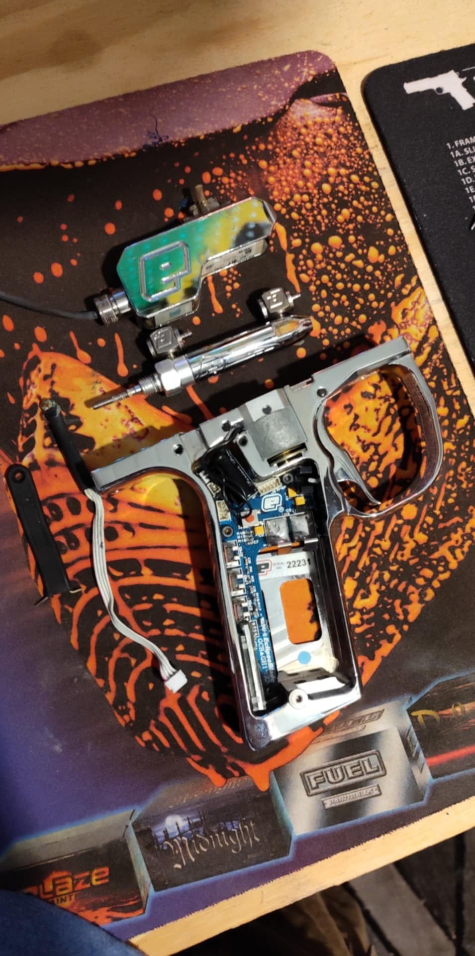

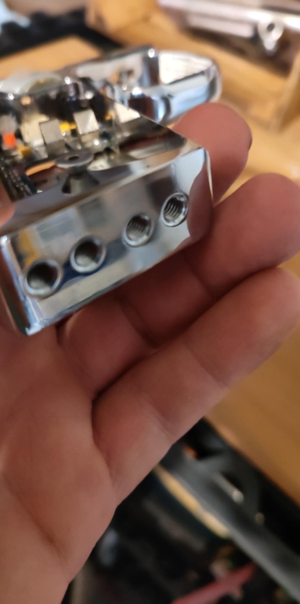

    I'm considering a used eblade 2, reputable seller and all that. He wants to add the ram on for $100, it has QEVs. I'm not positive if I need this. I have a freeflow CF ram already. What is the advantage to having the QEVs and are they necessary for the eblade 2 to work right? Also, is $300 shipped paying too much?

    Tough to tell if $300 is a good deal, depends on the body, parts, and condition. Pictures would help us judge better.

      it's in very nice condition, chrome frame, PE noid. comes with everything you need to slap an eframe on an autococker. minus the QEV ram
    • SupremePB47
      SupremePB47 commented
      pictures are up
