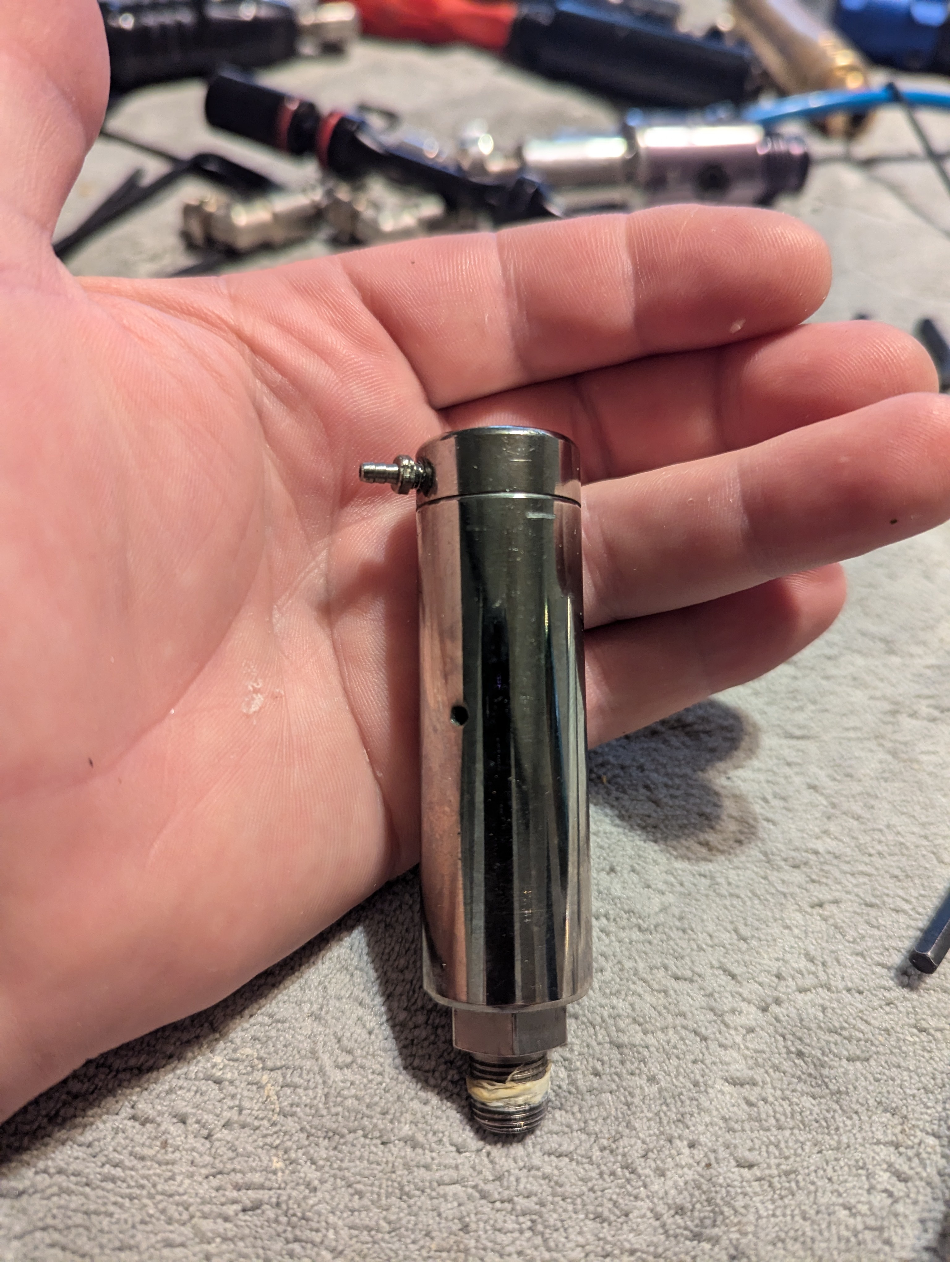

    I admit, I did zero research here but I'm gonna be lazy and just ask...
    I have this LPR, not sure where I got it from but I have a project I need one for. Is this a stock WGP? More importantly, is it adjustable? I jammed a couple allen wrenches in the input side but none seemed to connect 😂

    WGP Sledgehammer. Yes it is adjustable.

      Jammed a few more wrenches in there and got one to fit. Many thanks!

    nicmauro these were designed so the bas can be loctited onto the frontblock and the main body of the reg can be turned off the base for adjustments. There is an oring that seals between the base and regulator body so it doesn't have to be loctited together. Keep the oring lubed and it will make the process a lot easier. They are great regs once you get them dialed in!
