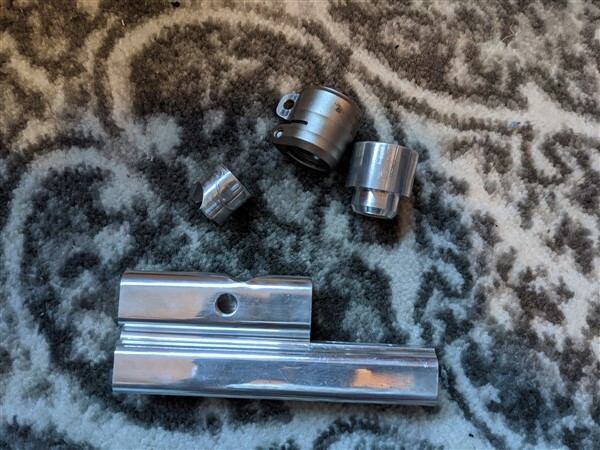

    It all started with this little guy:

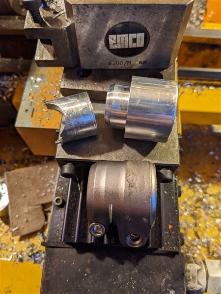

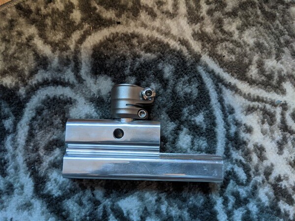

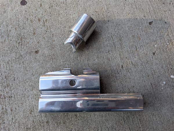

    I got it from a member here. I like the concept, it small and compact, but i didn't like the feedneck not the left over top rail. So jurst order of business was to remove the feedneck:
    And convert it to a low clamping style:

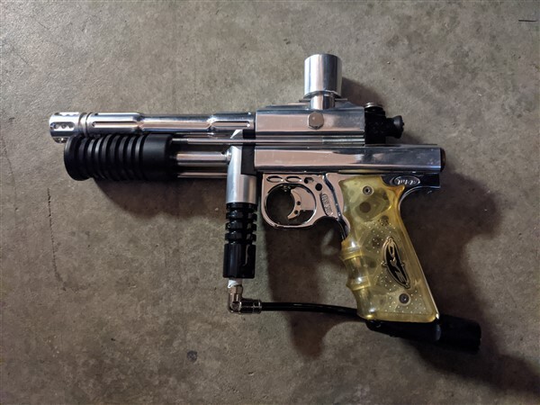

    The other thing I wanted to have was an air through frame.
    My first idea was to use a palmer reg on a "modified" frame i bought for testing a while back.
    (by "modified" read someone chopped the trigger guard off and the double trigger down to single with a hack saw)

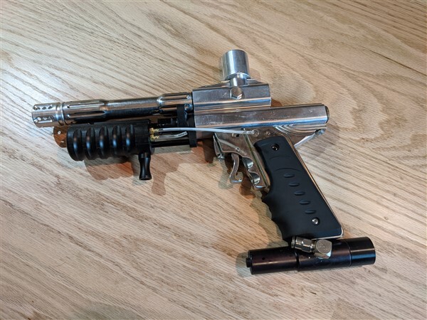

    But it was too long ... so i ended up with an empire reg:
    I still have some timing to do, and the TJD pump kit leak some ... some o-ring changes are needed (the ones on the print are the wrong sizes).
    But the form factor is exactly what i was looking for
    Thought i would share this little guy, and thanks for looking.
