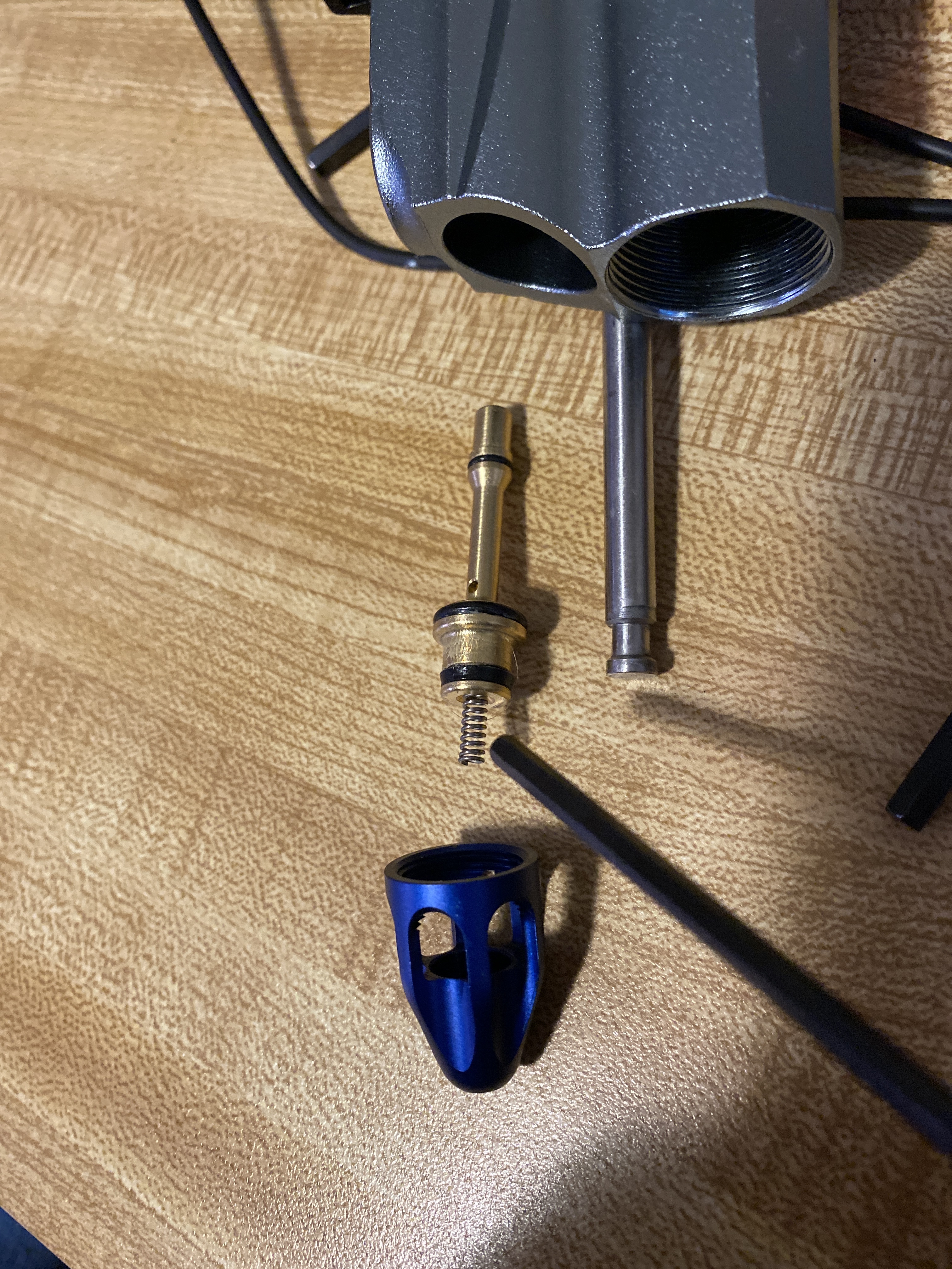

            Click image for larger version  Name:	image.jpg Views:	0 Size:	3.97 MB ID:	771024 Leaving this here for future others like me:
            Installing on a KPC+ and found that the hammer was putting too much pressure on my valve during initial air up.
            I held the pump back a bit and aired it up again with no leaks. No o-ring issues, just make sure the spring (inside the Laz valve) is providing enough back pressure. Also double check you put the spring back in after you took it apart…
