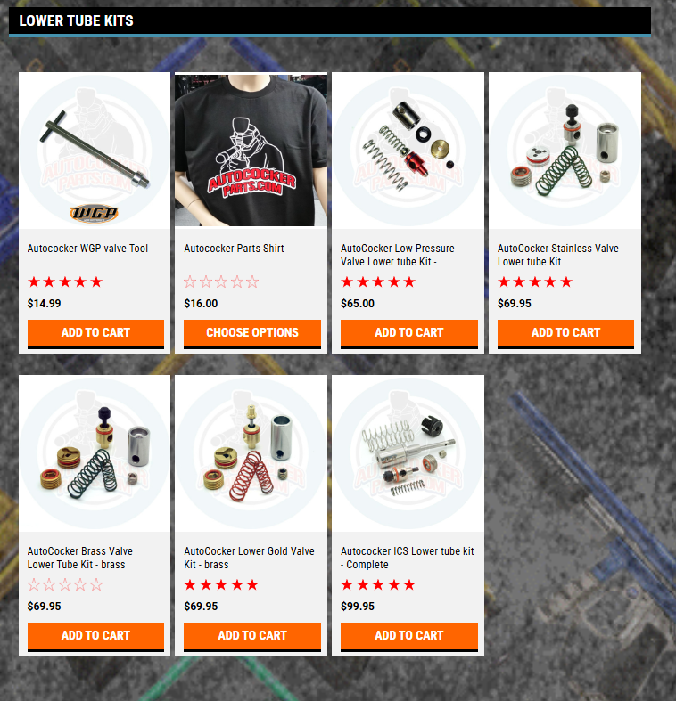

    Pretty much what the title says, can MCB enlighten me? Low pressure VS Stainless VS Gold VS Brass? Opinions on what's the best kit to buy for a RF project I want to start over the winter.
    image.png​

    low pressure = shocktech clone but with a wgp hammer
    brass and stainless = wgp clone
    gold = ccm clone, and a very good one at that
    ics = karivorr clone

      This is exactly what I needed, thank you.

    "Opinions on what's the best kit to buy for a RF project"
    Type of build and goal of the project?
    • spartan985
      spartan985 commented
      I guess that was a bit silly of me to ask, as I'm not sure if it will be a Semi or pump build yet. I'm leaning towards the Gold valve, but will that be worse than another option in Semi? I'm looking for quiet and efficient.

    Pump Sniper pre 2 k with CO2 tank. Which is best?

      Of the choices I'd go with the Stainless for that setup
    • $L!mBo
      $L!mBo commented
      if your setup is regulated, i had good numbers efficiency wise running 12g on the gold
      kit
    this one, can spring this tube very light which lets you have a light trigger

      ive been using the silver kits in my mechs and the gold kits in my pumps.
      both have worked great!
      if i was considering another build, those would be my go tos.
      my priorities are reliability and convenience of replacement parts availability.
      quiet? sorta just sounds like a stock autococker in both kits imo. the barrel length and porting have had more effect on sound signature with my stuff
      efficiency id say would be more based on what reg youre using. maybe look into the lazarus valve stuff?
      my mech is getting a hopper + 5 pods, maybe a little more on a full 68/45, reg usually set around 350psi
