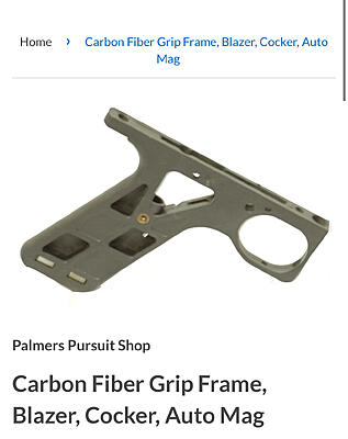

    Hi All,
    Thoughts on using this grip frame for a pump build with a 2k4 body? Recommendations on internals? Thanks!

        Yup, will work fine and if you find AGD or VL single hole grips you will have a very comfy frame and grip. Make sure you do not get the late WGP plastic grips but instead get the CF impregnated grips from AGD and pre-2K WGP (or PPS supplied, same thing). The later WGP supplied grips are very weak you can tell them because they are a glossy texture and very black where the CF impregnated frames are matte texture and more dark charcoal grey.

          Thanks Grendel! Great info!
