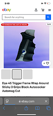

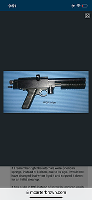

    Anyone know for sure if these dye sticky grips fit the Sniper 2 below?

    They don't fit.

      Nope! Sheridan frames use a single hole/screw to secure the grips and also have a different angle to the grip compared to a .45 frame.
      Short of duct tape, you're not getting those Stickies to stay on that frame.

        Thank you. There are some screw holes with the grips off that looked like they may have aligned, so I wasn’t sure.

        Murdoc555 some of those pot metal frames are the two hole style, most are the single hole in the center

      When you say a sheridan style frame... there IS a mozak frame that is single hole, but will also take 45 grips. You don't happen to habe a mozak frame do you?

        Unfortunately not, It’s the barebones Sheridan frame that came on the early snipers.
