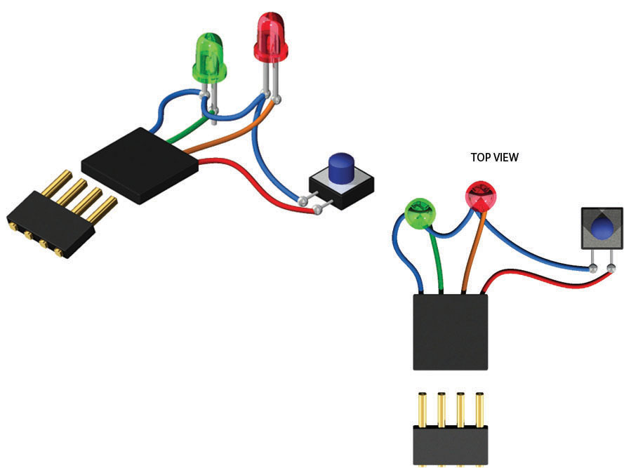

You'll need to hotwire pins 1 & 4 (regardless of where you're counting from) with a non-continuous (only on for as long as it's pressed) switch and then fit it to the frame. I'd rather get a sci-fi board and drill the frame for (a) button/s. Lots of 'cocker knowledge was lost when customcockers went down.Attached Files -
Thank you that’s exactly what I was looking for. I wouldn’t mind a sci-fi board but they are hard to come by now a days. Currently the gun has a e1 with a zero b board. I was just trying to get it working cause I remember it had a lot more firing modes and settings with the predator flash. Thank youComment
