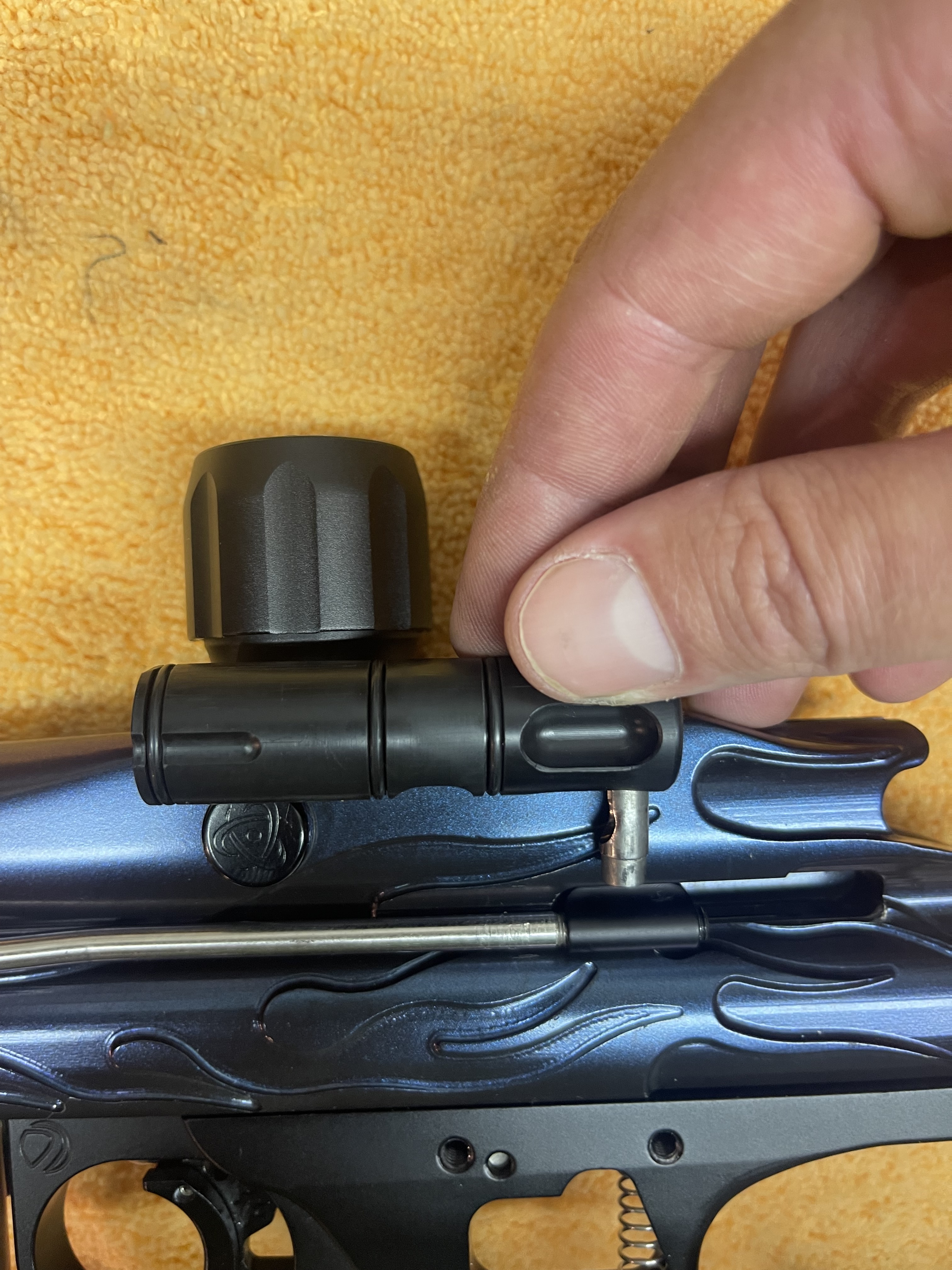

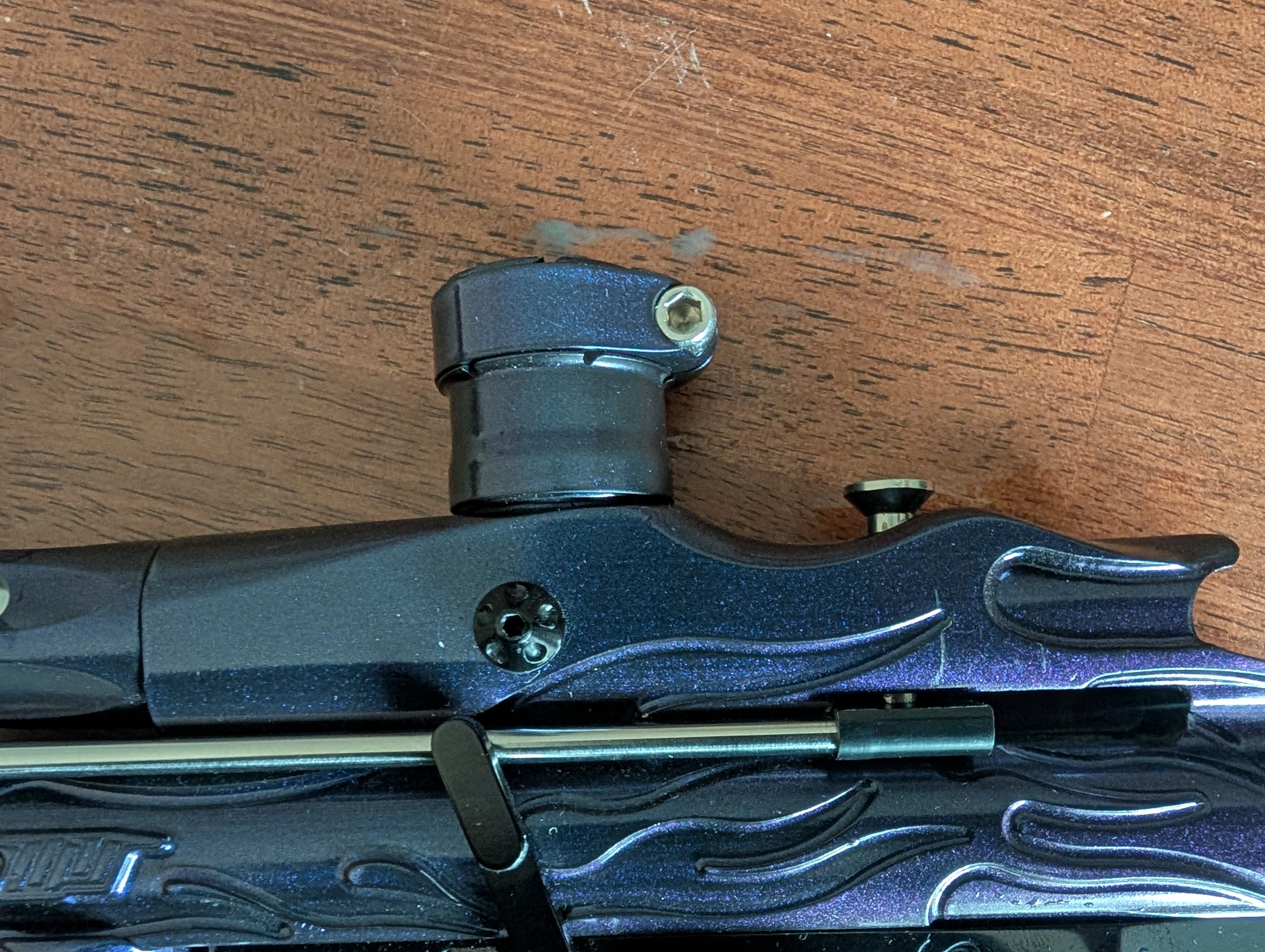

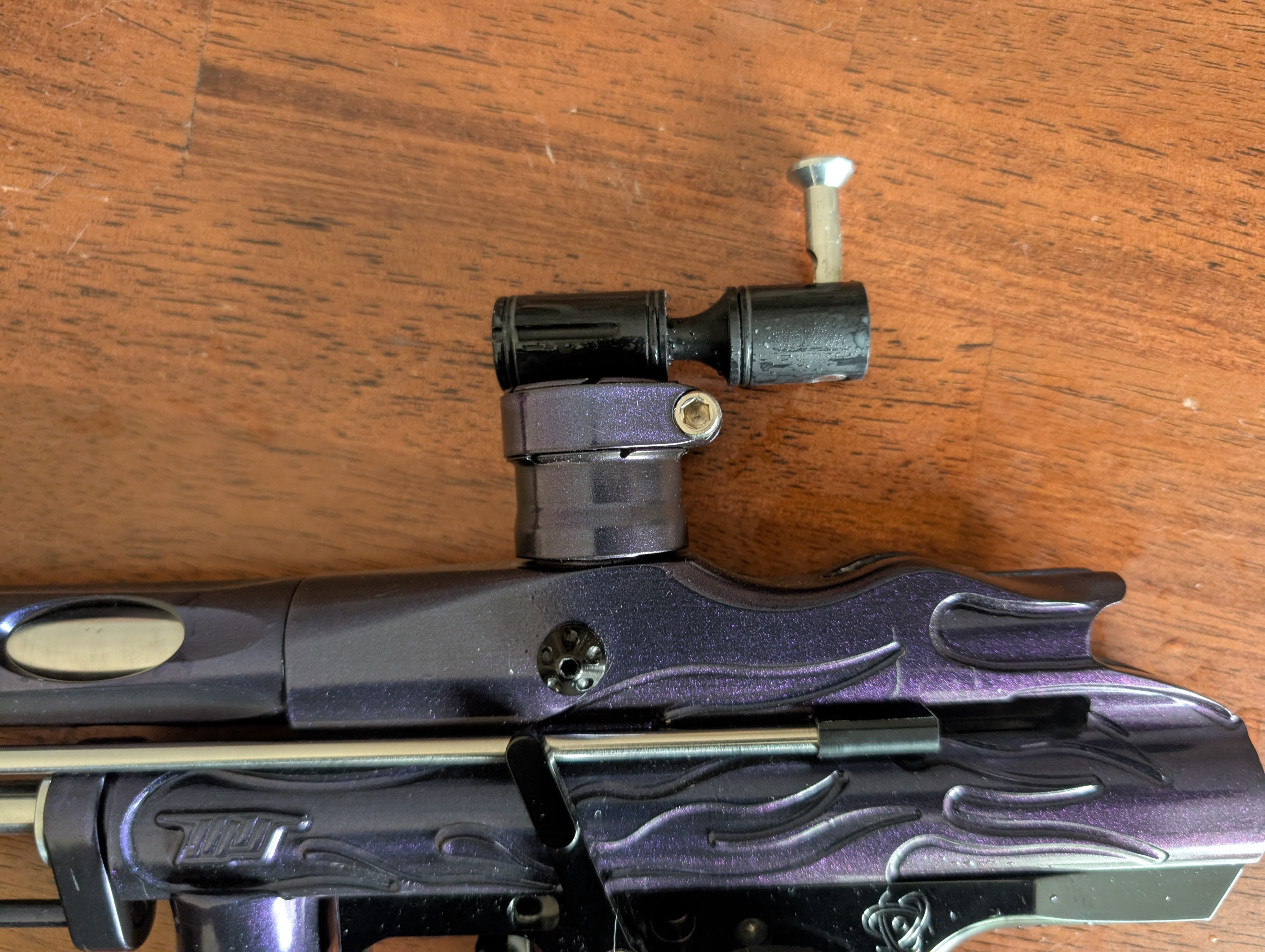

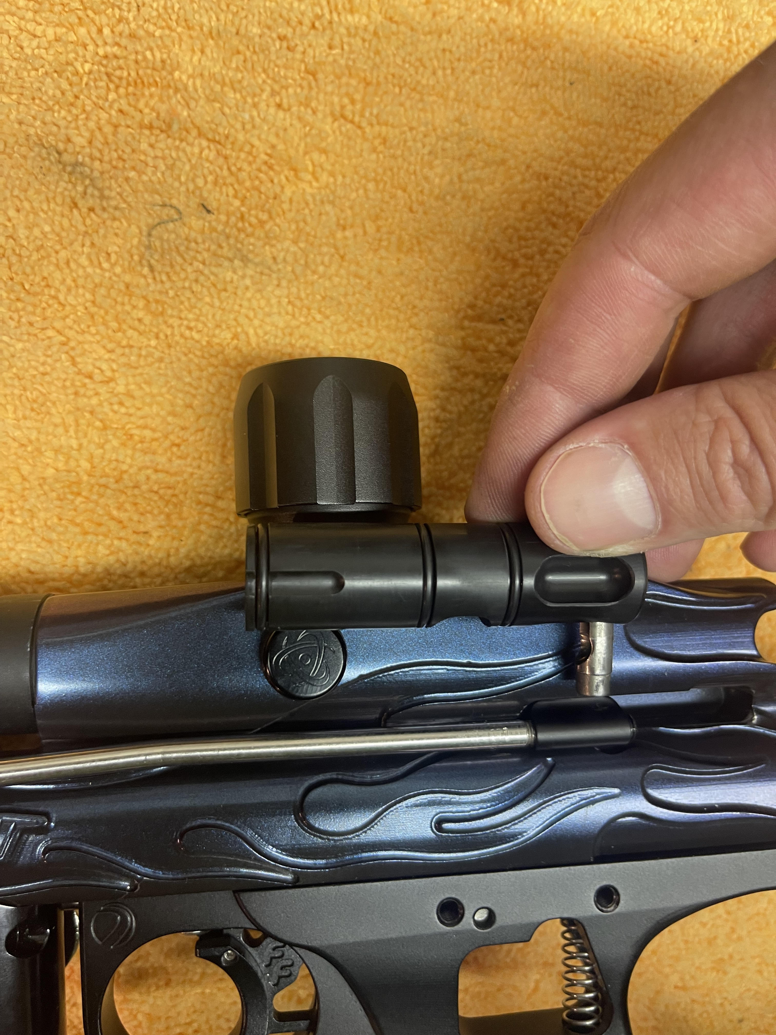

        When you shoot, what is the velocity of the ball coming out of the barrel? Is that normal, or is it super low? Can you post some pics of the bolt in the marker and outside the marker next to it, where it would line up? If timing is good, the bolt isn't upside down, and the orings are snug, it seems like something is misaligned. IS your pump arm a little too long? Can you screw it in any further?

          I have a Whisper bolt in mine, but your hole should be lined up where my cutout is, not sure if the pics help. The middle oring should be right behind the back of the feedneck for proper alignment.

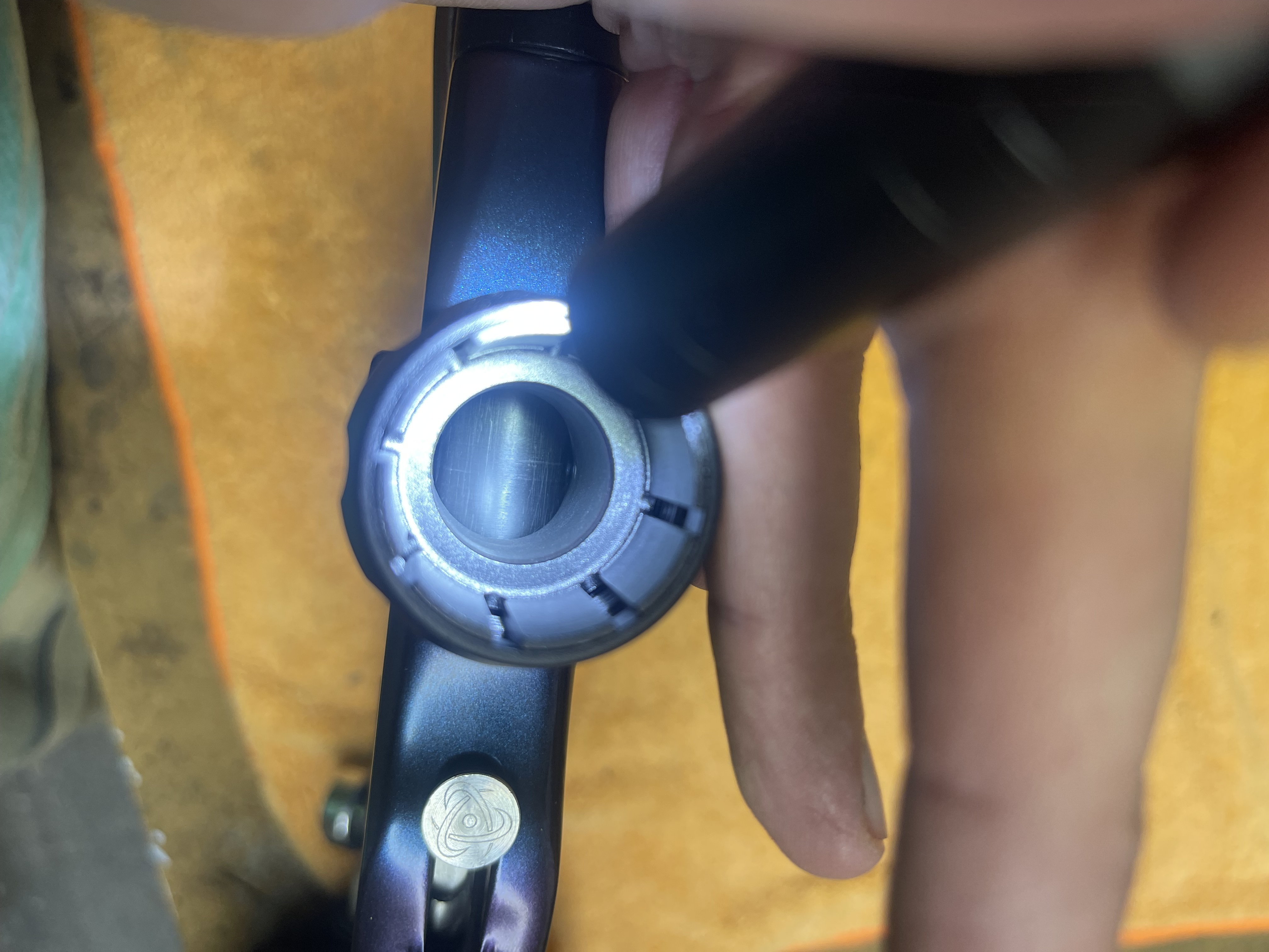

            When the bolt is all the way back, how much of it can you see down the feedneck? When forward can you see any of the center ring?

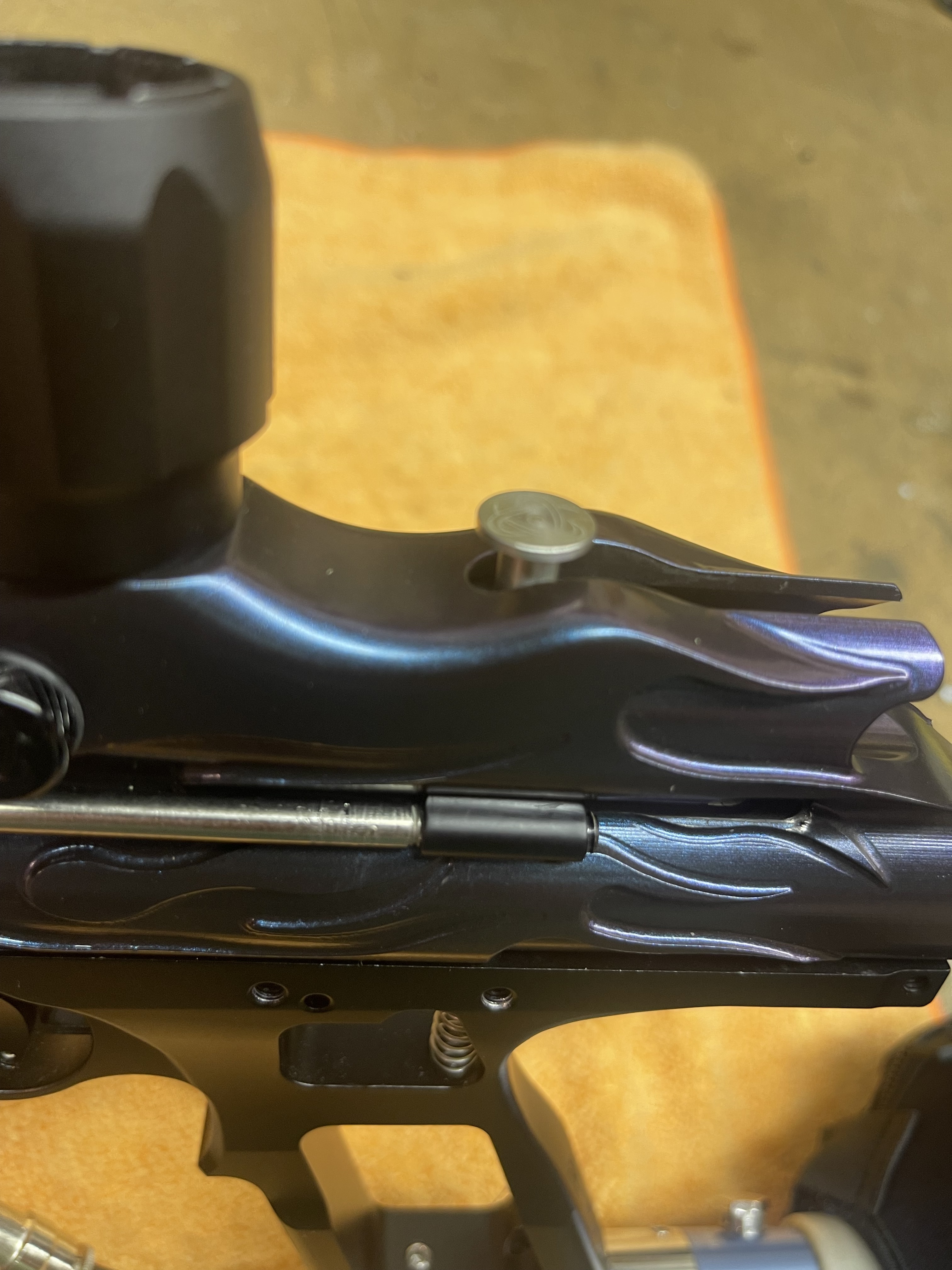

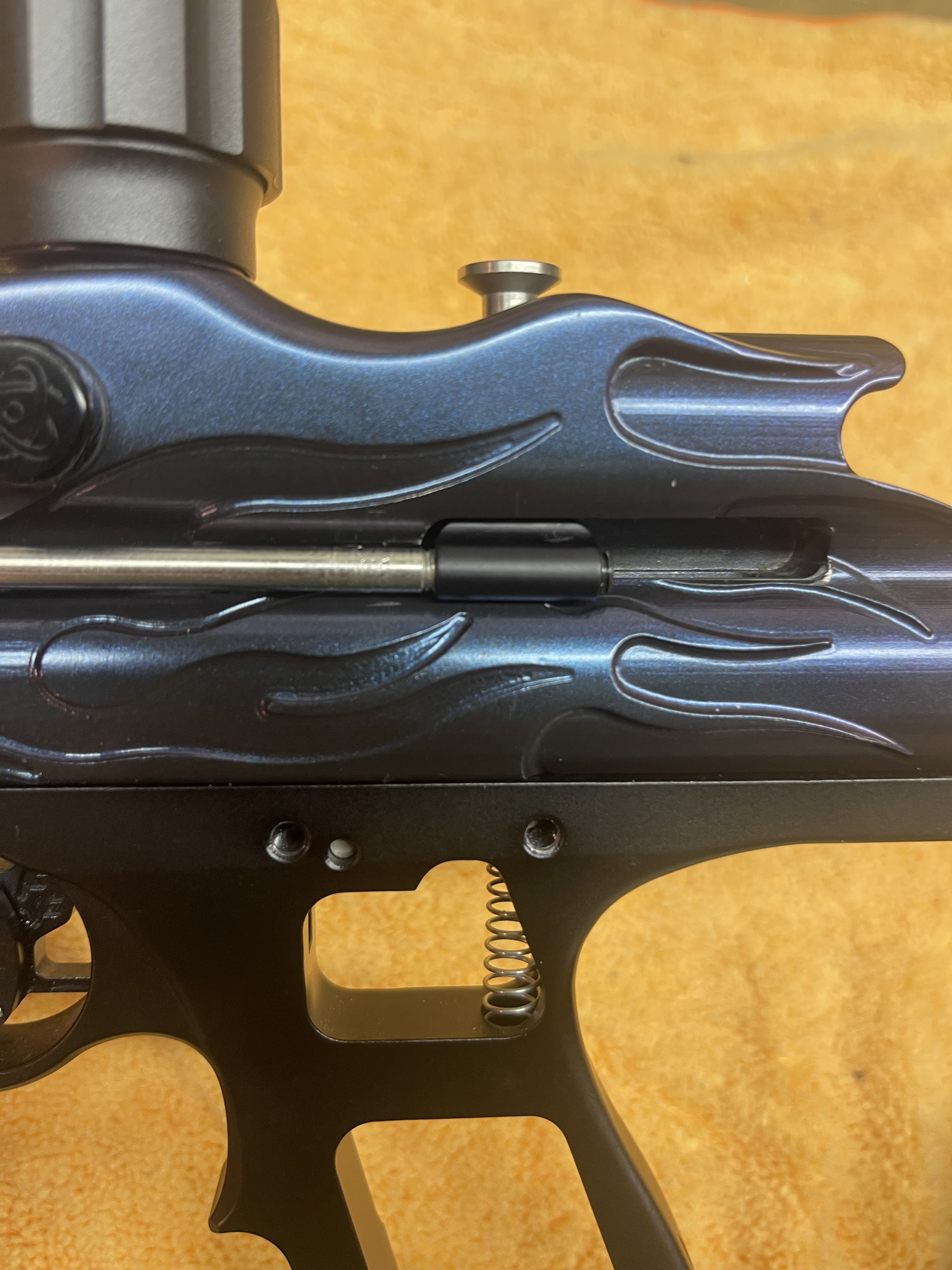

                Thanks so much everyone. I attached some photos and tried a couple things. It was hard to get the right angle showing the bolt outside the marker so I took two.
                Turned up the lpr to as high as it goes, no change, turned it back down.
                Turned the lpr all the way off, held the bolt forward with my finger. Took a shot and the 2nd ball on the bolt didn’t go anywhere, no blowback whatsoever. Turned lpr back to normal.
                Put a thicker oring in the middle of the bolt, same blowback. Put a thicker oring on the front and middle of the bolt, same blowback.
                When holding the trigger back I don’t see any bolt. It cocks just as the bolt face clears the feedneck. When the trigger is released I don’t see any orings on the bolt.

                  I'm also wondering if the bolt is too far back. Typically you can see just a sliver of the bolt down the feedneck when the marker is at rest. Turning the ram out a few turns from the front block will shift everything forward a bit.
