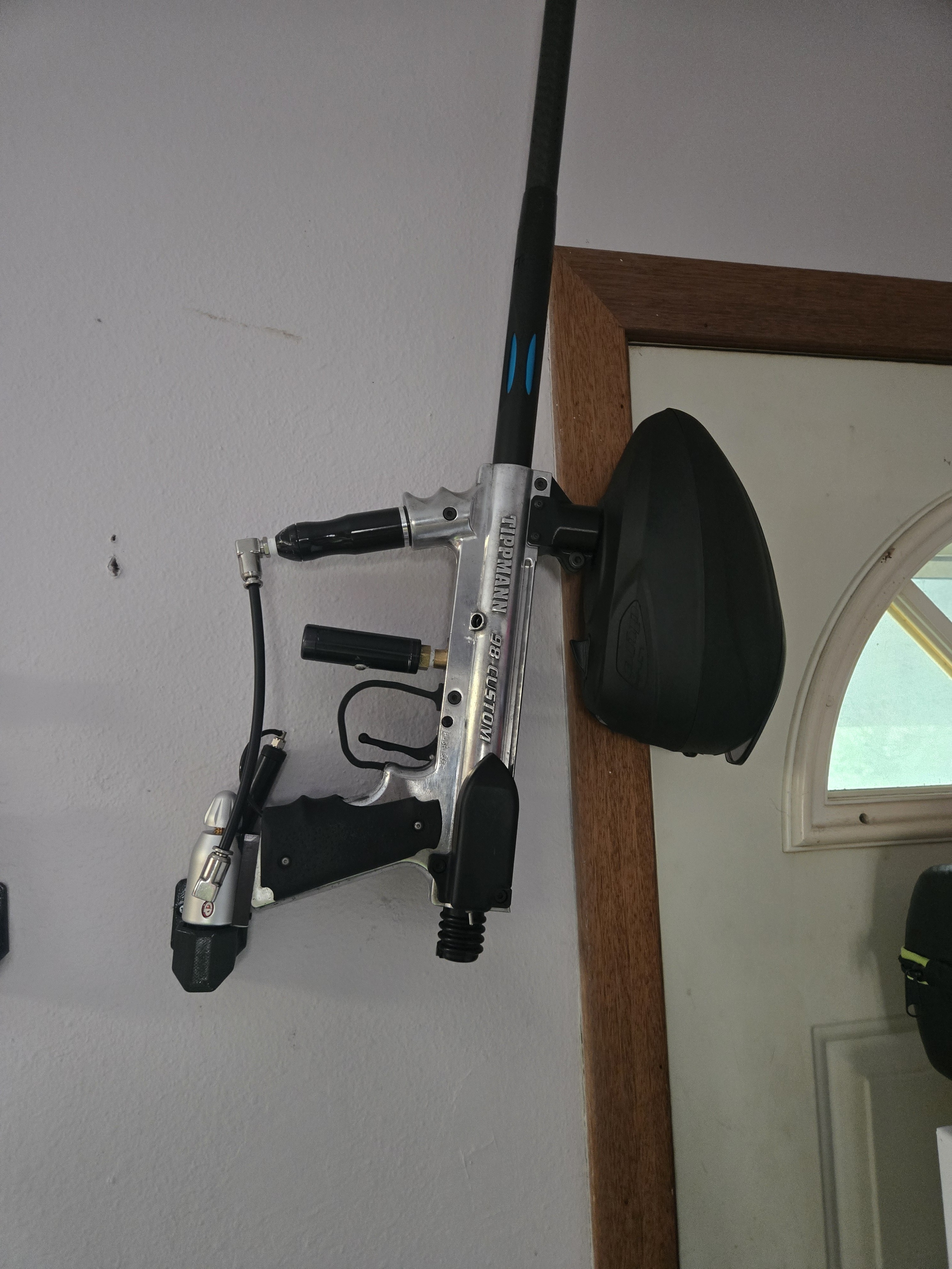

          It is not shorter, but much smaller diameter, the Nova LPR is rather small. I have one on a custom Tippmann 98 lp E-bolt build.
          It is used for the selonoid pressure control, the old (gutted) wgp is used for volume
