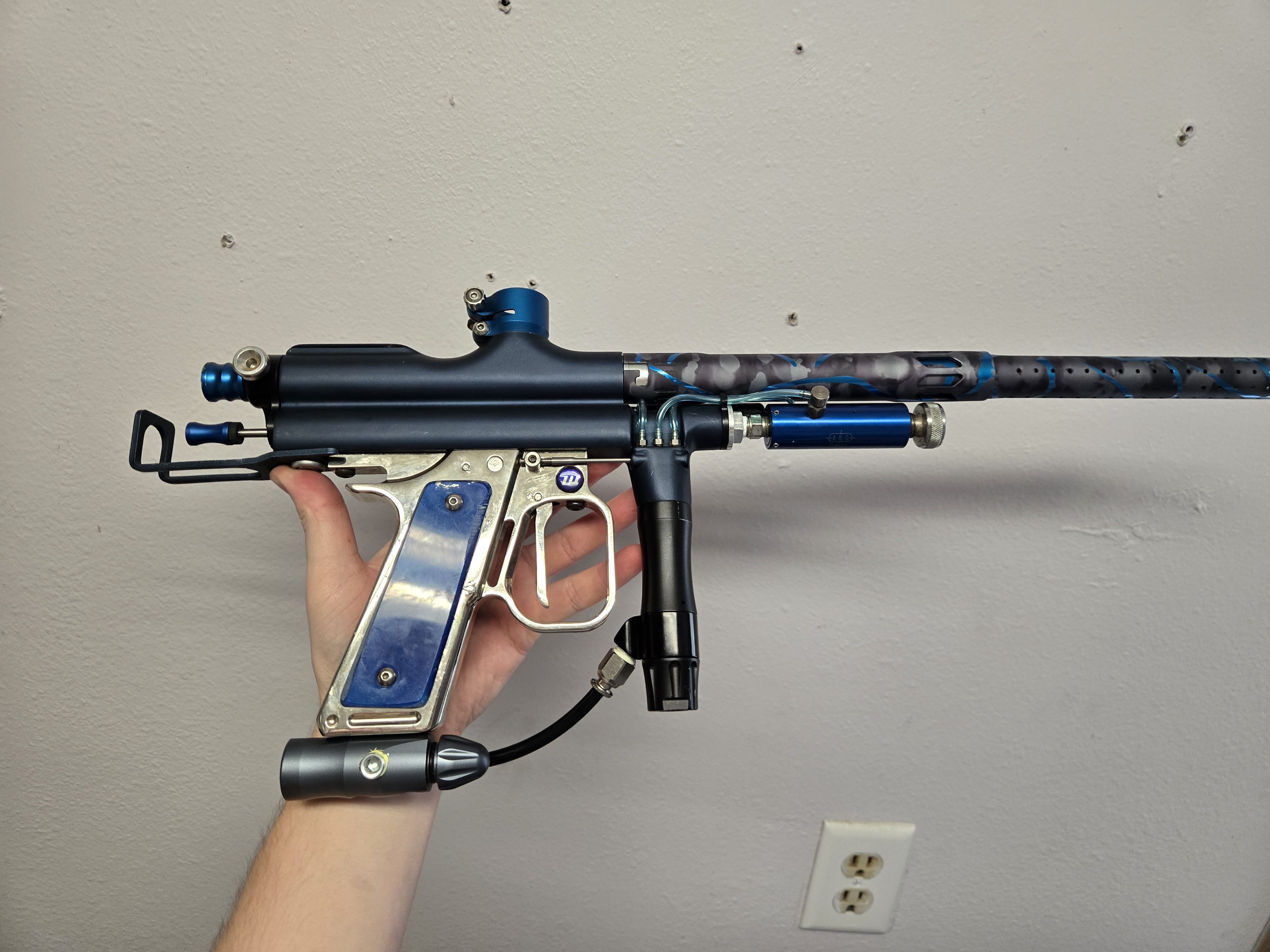

    Hey all - A relatively simple and dumb question but I just picked up the adjustable timing rod from TechT and did the install. Is the tuning as simple as shortening the rod?
    On another note - the build is nearly complete, have a shocktech internal kit in there, ID bolt, new reg, new asa, new grip - what other upgrades am I missing?
    image.png​

      To put it simply, yes. There is also the hammer lug that can affect things too.

        Genuinely curious, why is an adjustable timing rod needed on a Trilly with the stock frame?

          IMO coming from a trilly sport owner once you drop psi and are operating in the 225-250psi range and especially if you re spring your trigger pull may be short stroking and u could get some chops
