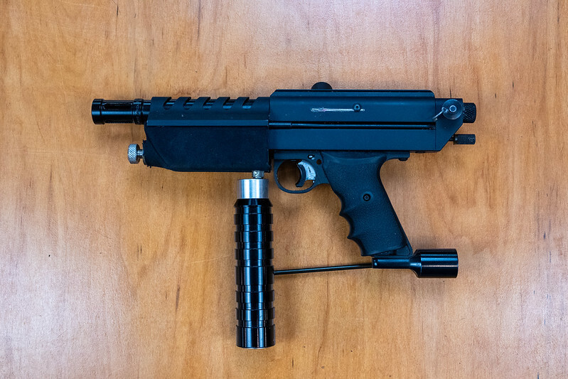

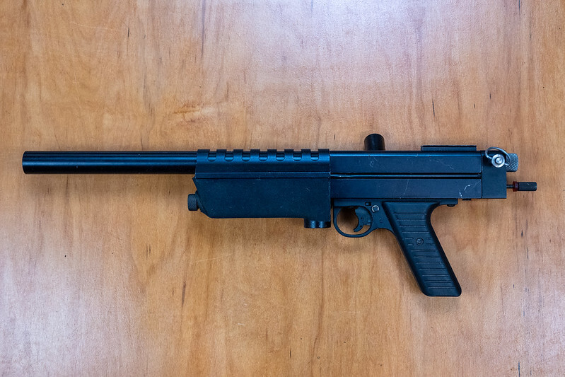

              But the earliest autocockers had, well, shitty regs. The first one really wasn't even a regulator. It didn't regulate. It either made pressure, didn't, or blew the hose. It really needed to be adjusted before every game or at least twice a day. So many folks cut a hole in the shroud so you could adjust it without taking it off.
              That's a sniper 1 that was sent back in for the autococker conversion and has the first "reg" on it.
              Later on as regulators became a thing: Think Jackhammer 2 regs, Palmers, etc. They still were adjustable, but would actually regulate. Folks still cut the hole.
              But yeah, people did want to show off the fancy stuff underneath and now we had secondary regulators to hold... So off came the shrouds. I think this was also around the same time that WGP started making cheaper and "meh" shrouds that people were more than happy with just taking off and removing. It's not like they all went on easily either.
              I don't know the first gun to not have a shroud regretfully, but I know my first Black Magic did not come with one. Probably the STO's before that didn't have them either.
