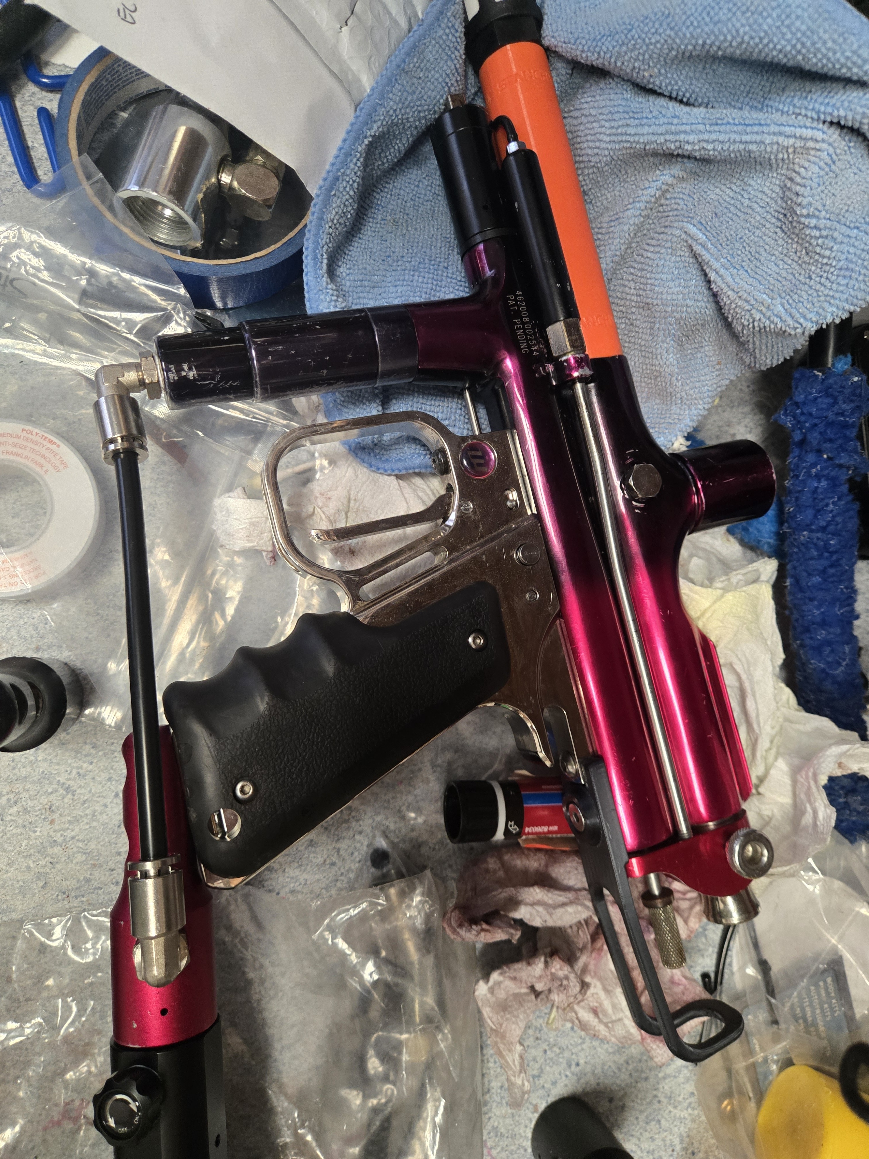

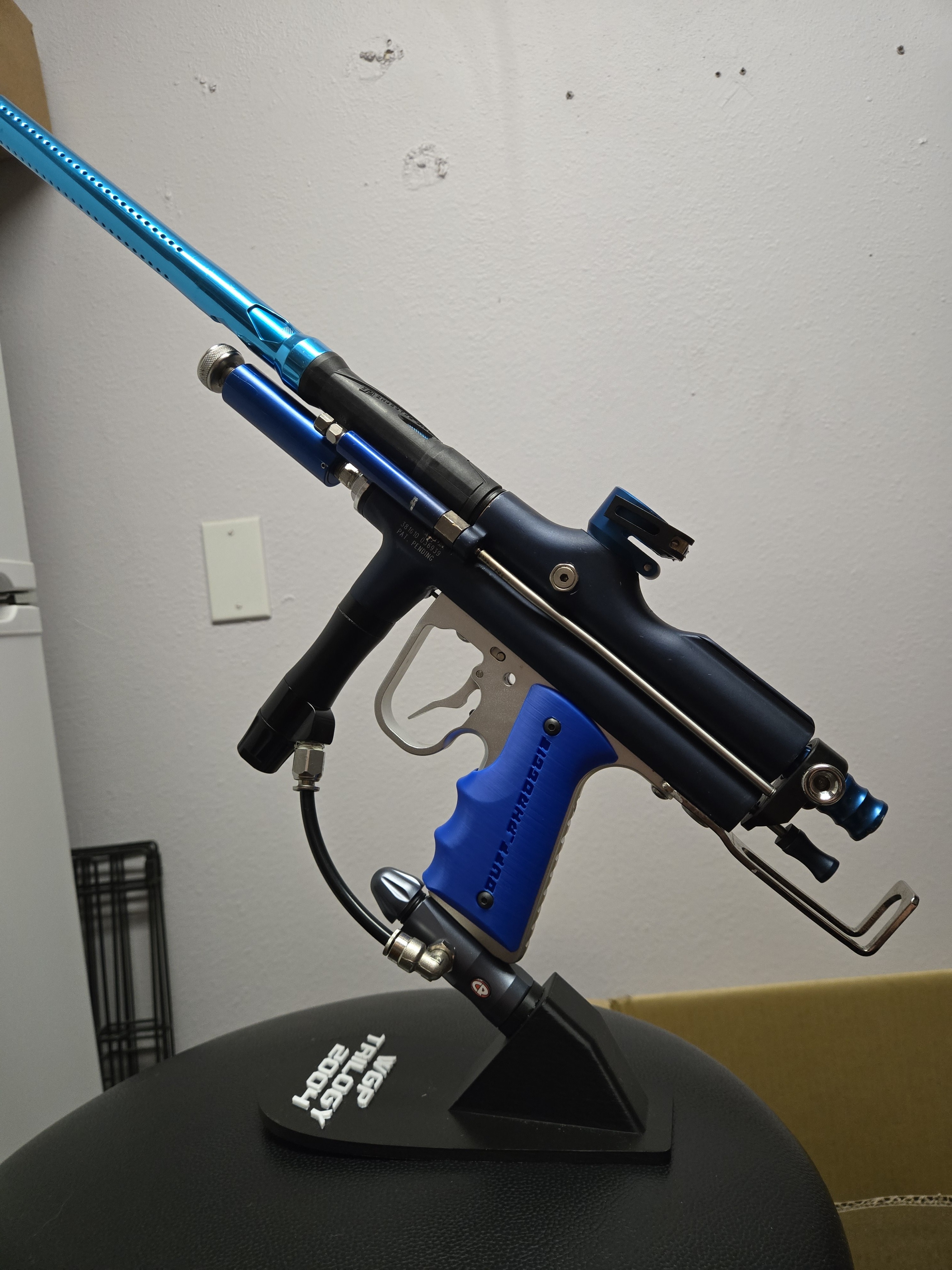

              If you want something cheap to mess with that doesnt really have any big value get a trilogy IMO. The first thing that "needs" to be done IMO is to cut the feedneck and an on/off asa.
              The rest is just quality of life and messing around. They take 2k spec bolts and the TechT lpr adapter and adjustable timing rod are avaliable through TechT again. They are also 11/16 valves so the dye lazerus valve just drops in.
              I have 8 and about 5 of them are at some level of appart for a build. These are the pics that I have handy of some of them.

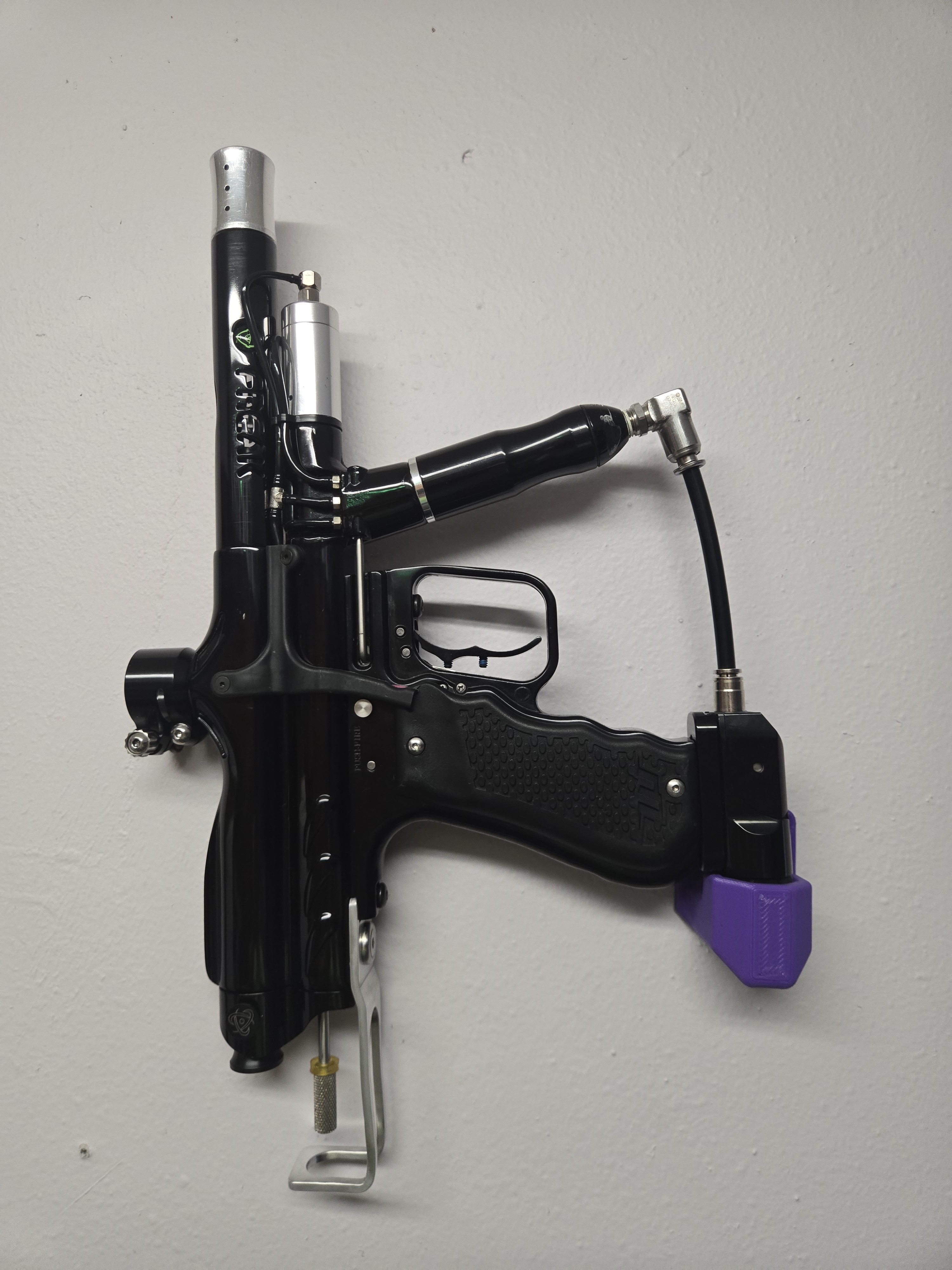

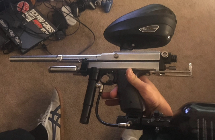

              this was my first cocker!
              entirely bacci parts! and sent out to Tim Firpo to be teched!
              still have all these parts!
              OH YEA!!

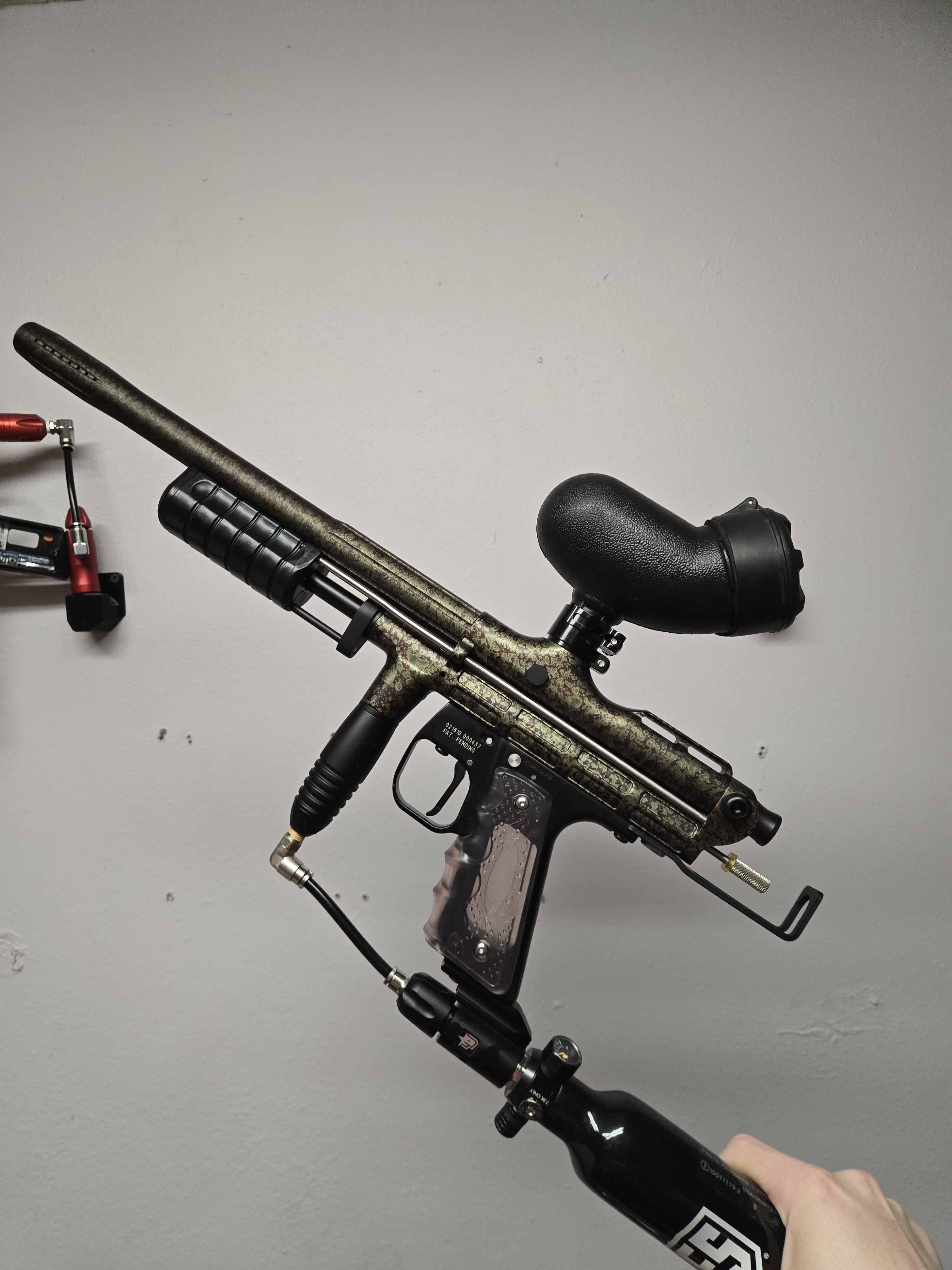

                • 6182

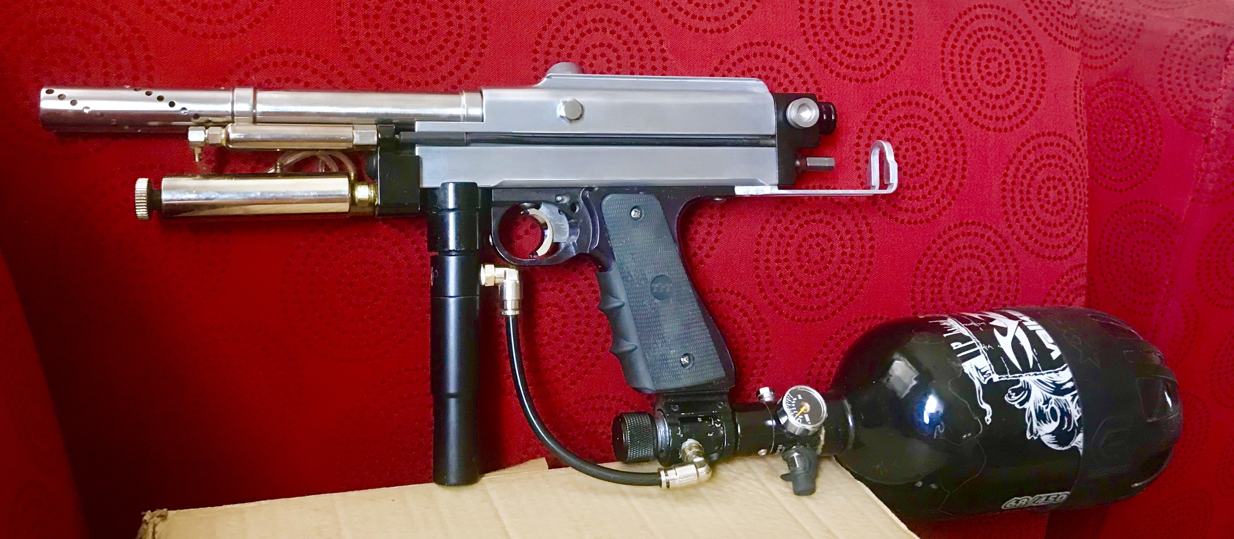

                My first, and still only cocker (slightly less than stock)
                I've owned a few others through the years but they were just to fix and sell. This one is my baby
