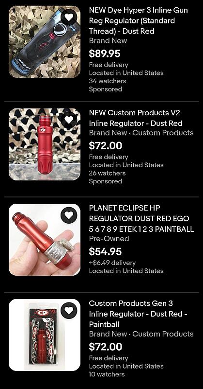

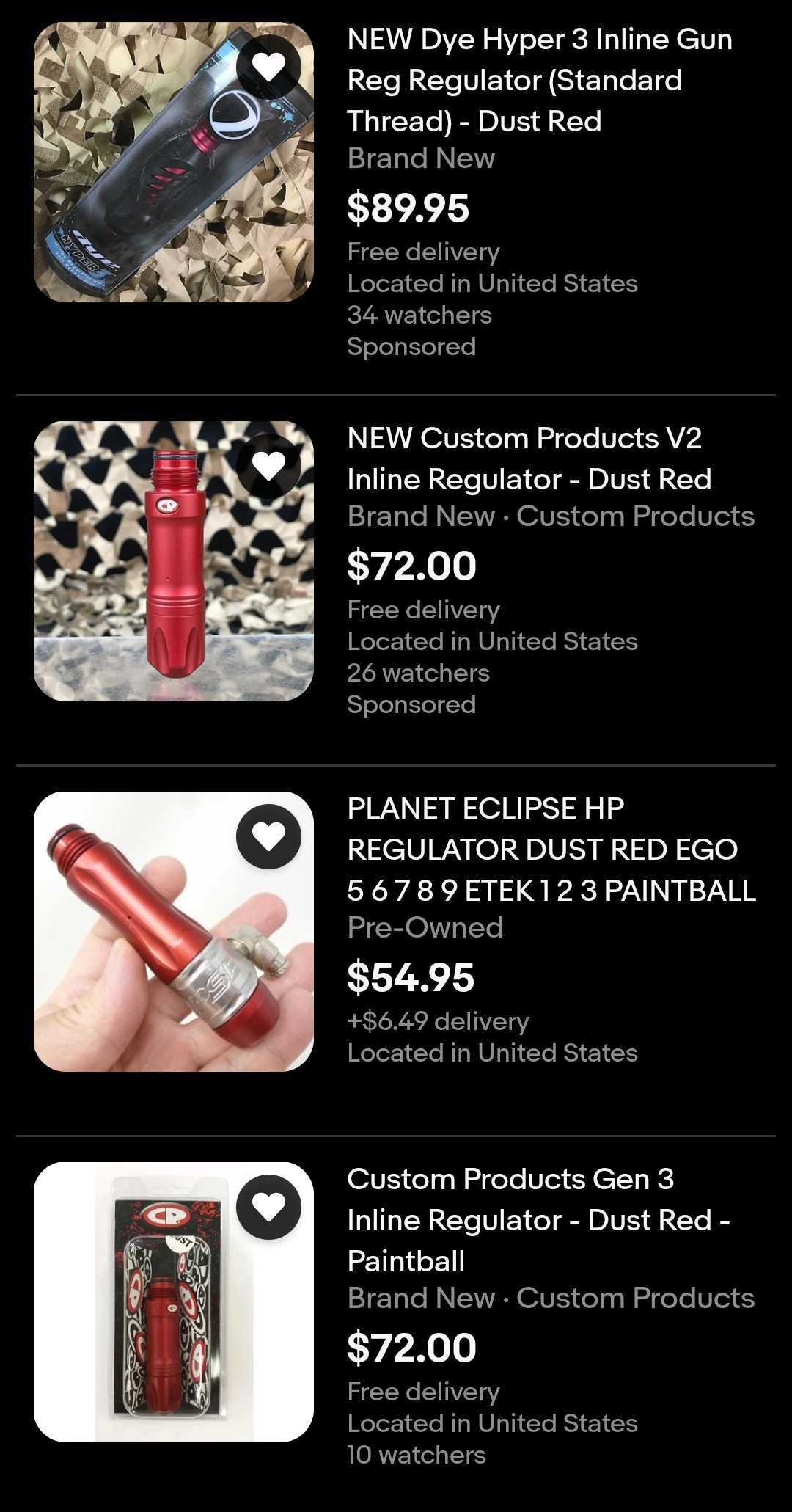

    When it comes to autocockers, i am a bit behind the game. My autococker knowledge is all 23 years old and i am needing a externally adjustable HPR. My old wgp reg made in 2000 is giving me all kinds of trouble with pressure spikes, dips, and sticking even after a rebuild and not being able to adjust it easily is getting annoying.
    These dust red regs are available on ebay, but i know nothing about their reliability or quality. Any suggestions or comments on which dust red regulator or chrome regulator i should go with? (Doesn't have to be ebay, thats just an example). Thanks!

    Did you try replacing the reg seat in your wgp reg? I think docfire sells them.
    Dye hyper 3 is essential an improved dye hyper 2 so that's a good choice if you don't mind looks of reg cover.
    Cp regs are good, but need a rebuild kit from them off memory. Should last many years without needing it though.
    Unsure on ego regs.
    Most are pretty good. Post any others you like

    CP regs are solid, but that price is a bit high. A used one would work just as well if you can find the right color.
    I’ll second this, I’ve had good results with CP regs.

      Cp all the way. My favorite regs. Consistent, center input, you can convert them to lp if you need to, easy to work on

        They used to be $90 new. The price has come down

          Dose it have to be Dust red? Because I would spend the extra $15 and get the best AKA

          https://shocktechusa.com/products/sh...line-regulator
          It's more expensive than the cp but the shock tech uses the internals from the CP regs so it's just a CP with different milling

              Thanks everyone, sounds like the CP is the way to go. I was unsure of quality. Hopefully this old autococker will play again after the old age kinks are worked out!

                I was going to say pass on the hyper 3 reg. They typically don't output over 300 without adding a shim. I have a dust red hyper 2 if you are interested.
                CP is pretty solid though.
