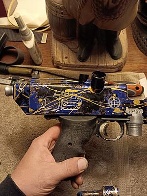

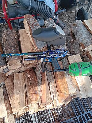

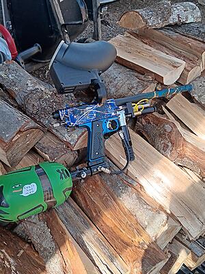

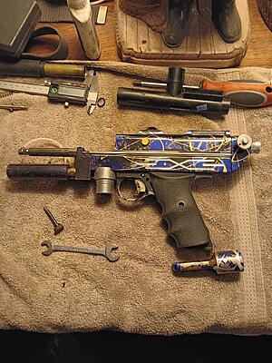

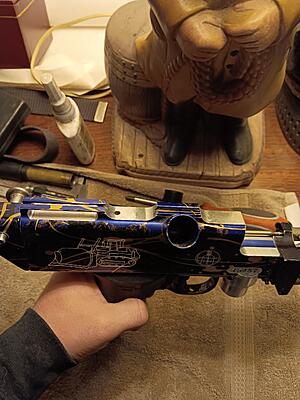

    Last winter I bought this pre 2k from I75 paintball as an incomplete marker that had seemingly sat around for a long time judging by the condition of the o rings in the lower tube and ram. It has a bulldozer laser etched into the slab side and as a heavy equipment mechanic by trade I just thought it was cool. This and another insignia shown in pics were done after anodizing and some milling to flatten the top was done. The lug adjustment hole I believe was done later also and for that I am thankful. At first I was going to pump it but, after getting it in my hands I decided it deserved a period correct cocker build. I think the long ass PPS rock is what really did it for me lol. From there I spent some time collecting some parts and got it together. I feel I have done it some justice in its resurrection. I have it to a point of being usable but not quite perfect yet. I need to spend some time messing with springs. I converted it from Sheriden springs to nelson/cocker springs. Awhile back I had posted it on Reddit and a couple of the cocker FB groups looking to see if anyone recognized it but did not find anyone who had the story behind it. I figured if there was anywhere the person who originally owned this thing would be it would be here. Would love to know the story behind it. I do apologize for the terrible camera on my phone. Its time for an upgrade there too.
    Build components:
    AKA lightning bolt
    Rock LPR with Rock knob
    PPS quick switch
    AKA MiteyMax
    Older STO ram?
    ANS IVG kit
    ANS hammer
    Autocockerparts low pressure valve
    99 Benchmark frame with WGP roller sear
    AA Vigilante HPR (this is off of the first autococker I bought when I was a young lad circa 2002 or so)
    AKA dovetail rail
    big knob CP on off.
    2 freak tips with "close enough" ano.
    have found a chrome freak back that fits the build a bit better since taking these pictures.
