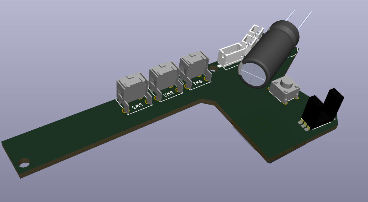

    Early render of board topside with some of the components
    Early render of the board with some components

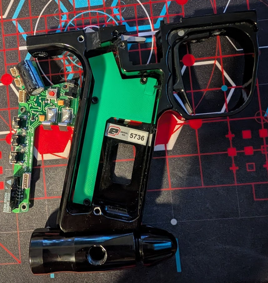

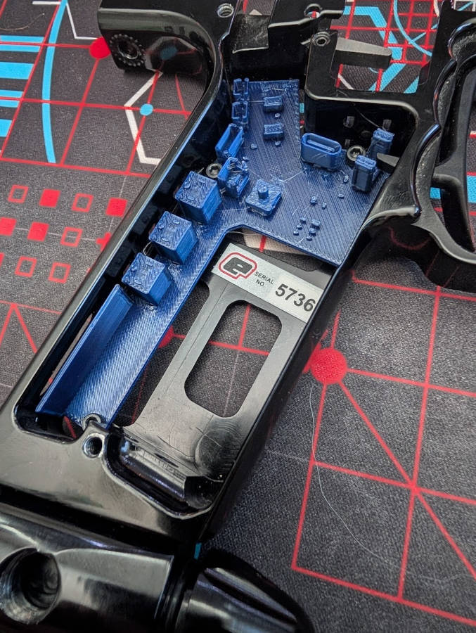

    Fitment test with a 3d print checking screw hole placement, opti location is sufficient, and overall fitment inside the frame.
    Testing fitment inside the frame.

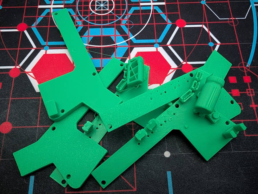

        Nothing too exciting from today, a lot of work trying to perfect screw hole and button alignments as well as validate component clearances. If you do much 3d printing I'm sure you'll understand the little bundle of joy this pile of waste brings 🤣 Thank you everyone for the comments and questions, keep them coming!
        Fun with slicing models
        Example of slicing the 3d model for printing
        ​Aftermath of tests and failed fitments
        Pile of tests and failures from 3D prints

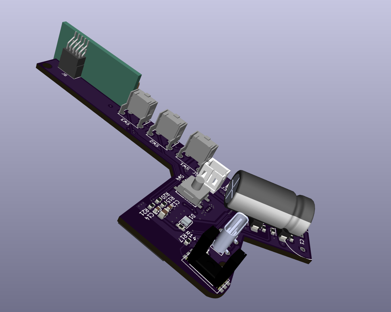

          Quick question for you all, how important is the screen to you? Looking through the surprisingly limited number of options for screens this small I've come to realize it's effectively impossible to get what I would consider to be an ideal screen. I had hoped to find an E-Paper style display that would work well outdoors and use basically no power to run but it seems only OLED displays exist in the needed size and that unfortunately means they're very dim. Would you want a screen in the OEM location even if it meant you probably can't see it when out at the field or would you rather a side mount screen through the grip that does work outside, or no screen?
          Mock up of a board with a screen for attention 😍
          A picture of a mockup board in the frame with a screen
          Feedback - SnapshotPB
          • Schultz98
            Schultz98 commented
            I personally would like to be able to retain at least the same level of functionality as the original trigger frame had. So unfortunately the screen (and it's orientation) is pretty important to me.That being said, if there is litterally no option on the market available, I'd be willing to be reasonable with a bluetooth/app capability, I just would much prefer a screen in the original window.(even if small and slightly dim)
          • GUNDAMNIT
            GUNDAMNIT commented
            Honestly, I could hardly see the original LED screen in bright light anyway. OLED in the original position would be fine with me. Just having another usable board that actually allows you to cap ROF is all that matters to me.
          • TencenT
            TencenT commented
            That's good to hear. Thank you both!

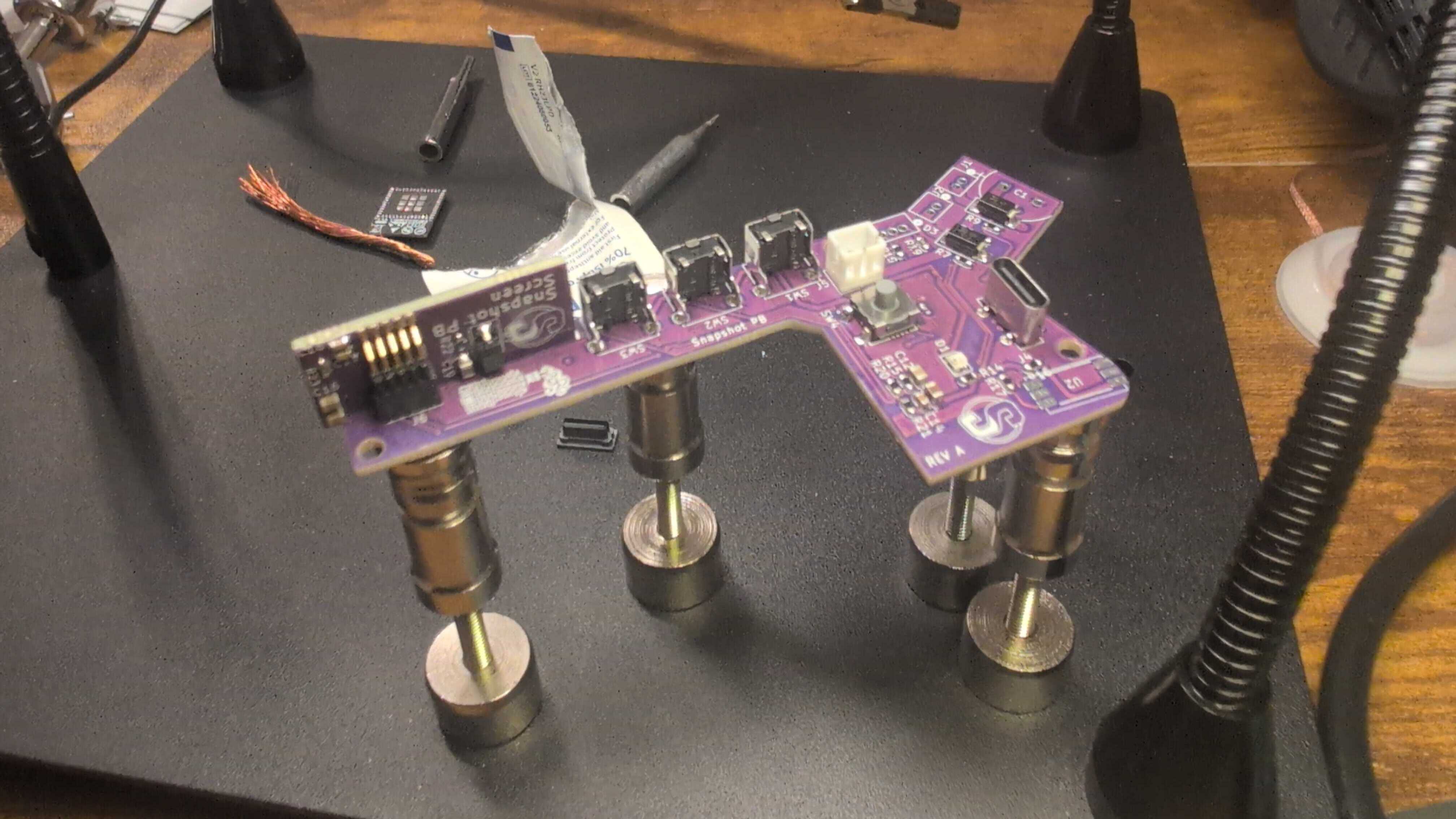

            Been a long few weeks waiting on the boards to come back, working through the app and board software, working on test fixtures for "mass" production, and debugging the first run issues. I'll have more for you soon. We're hand assembling the first ten boards, once we're confident in the design we'll start ordering bulk machine assembled. Looking forward to getting one of these out on the field 👀
            Working on assembly of the first test board
