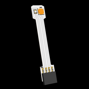

    Hey everyone — new to MCB 😜
    I’ve been seeing posts across different paintball forums about dead WGP Worr Frames, and it seems like a common failure point is the membrane switch. I’m in the same boat — this is my third frame with the same issue. The stock switches tend to either barely work or fail completely, and finding replacements at this point is nearly impossible.
    Over the past few weeks, I’ve been working on prototyping a replacement switch assembly for my own frame, focusing on improving both durability and reliability.
    Switch Assembly Redesign
    Here’s what I’m doing differently:
    • Replacing the fragile dome switch with a sealed tactile switch to eliminate issues with moisture and wear
    • Moving away from the flexible PCB alone (which can flex and delaminate) to a rigid-backed design
    • Developing a custom silicone button pad that’s molded specifically for the new electronics
    The goal is to create something that feels better, lasts longer, and solves the common failure points of the original design — not just a temporary fix.
    I’ve got the electronics side mostly finalized and am currently working through the last few details before sending things out for professional manufacturing.
    Right now I’m mainly trying to gauge interest — would anyone else be interested in something like this for their Worr Frame?
    Open to feedback, ideas, or anything you’d want to see in a replacement like this.​​​

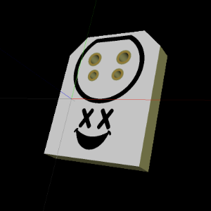

    Click image for larger version  Name:	drawing.png Views:	3 Size:	13.0 KB ID:	813083
    Altered patterns for the led indicator window on the silicon button pad are possible as I'm making those in house.

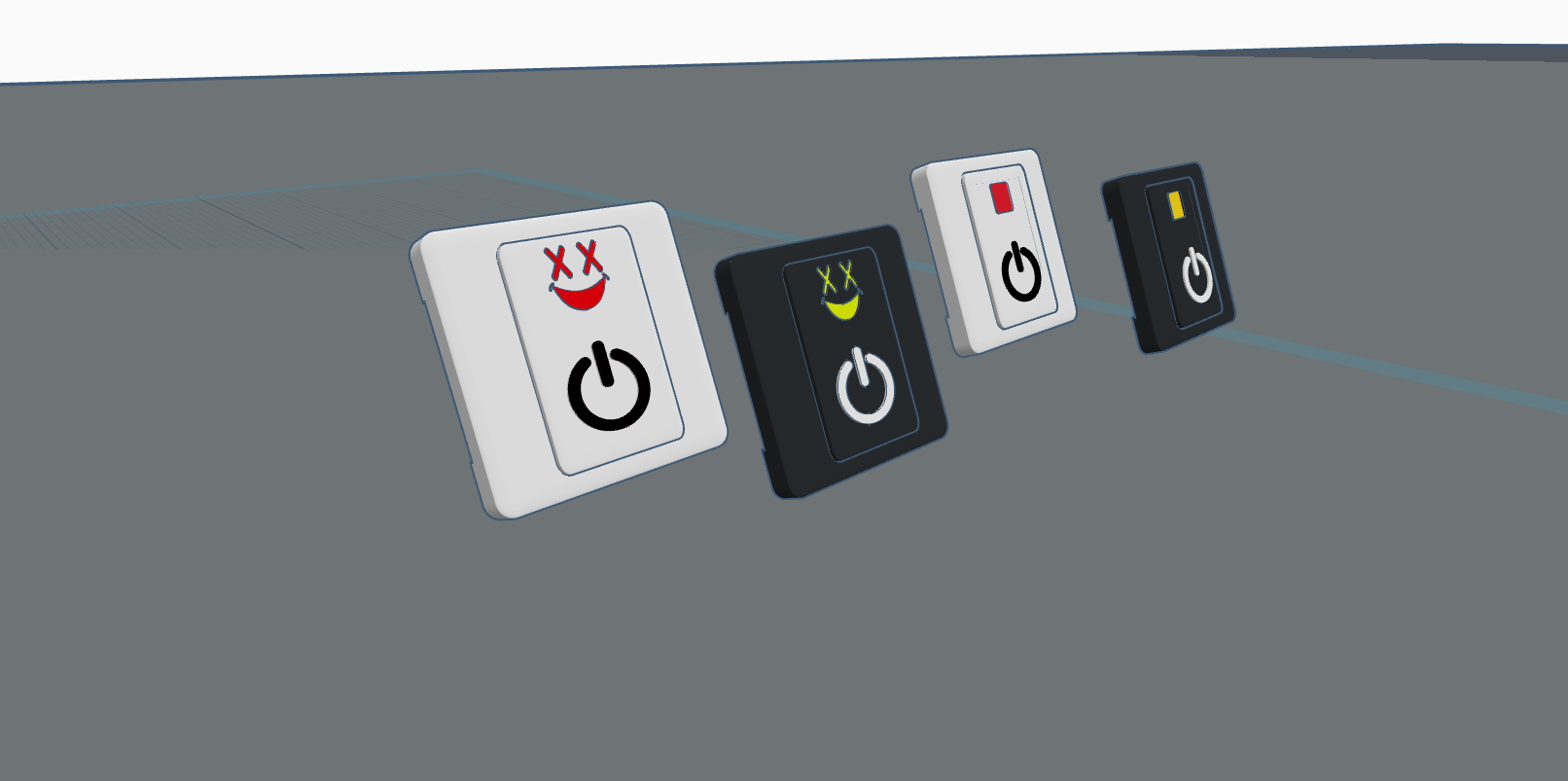

    Click image for larger version  Name:	Membrane.png Views:	4 Size:	116.8 KB ID:	813086

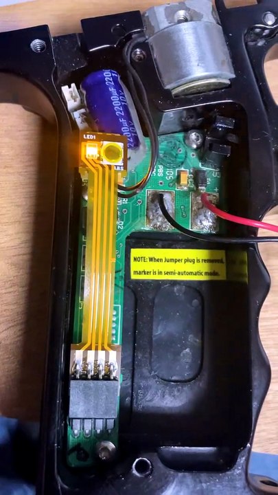

      Update: The first working switches have been produced

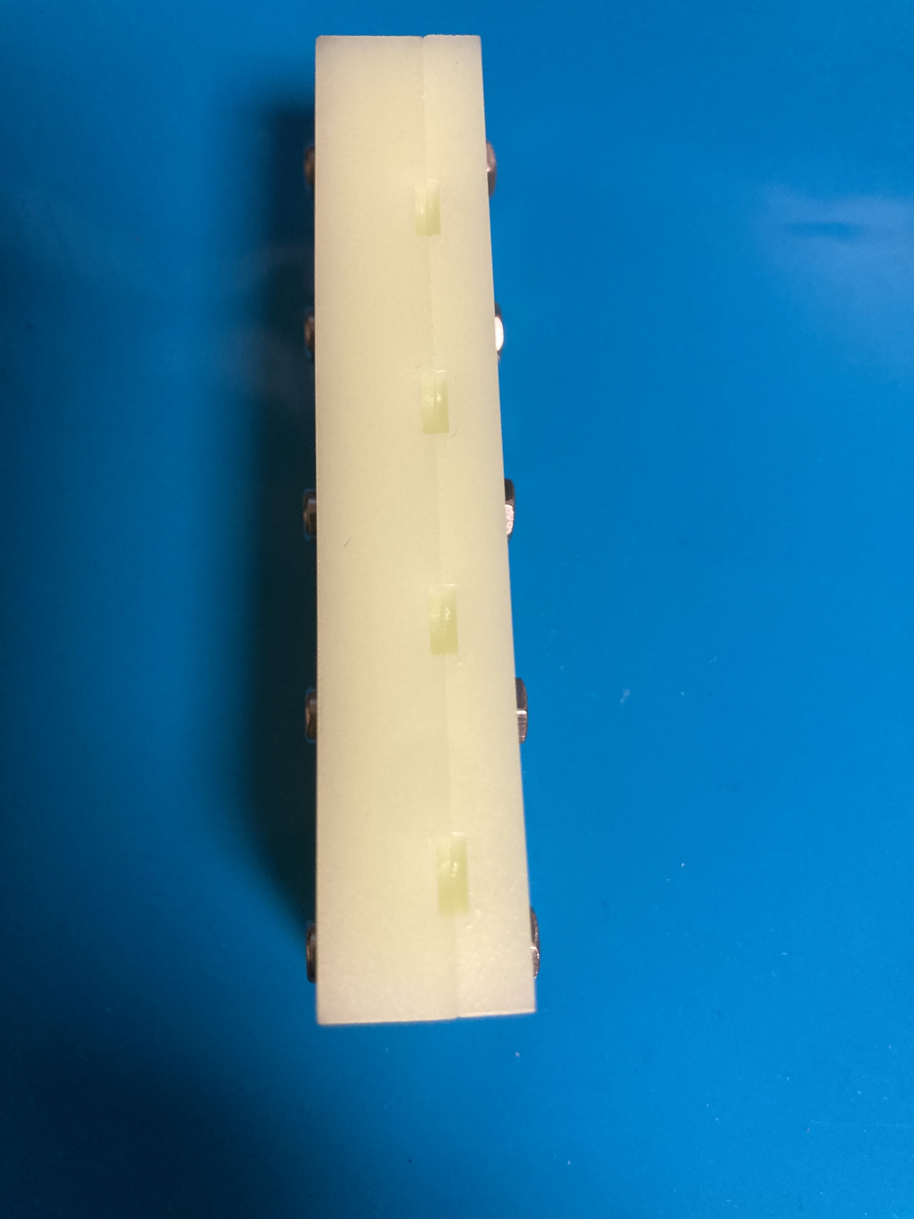

      Molds just arrived. Starting to produce membranes on 4/25. Should be on schedule to start shipping out finished units by the first or second week of May.
