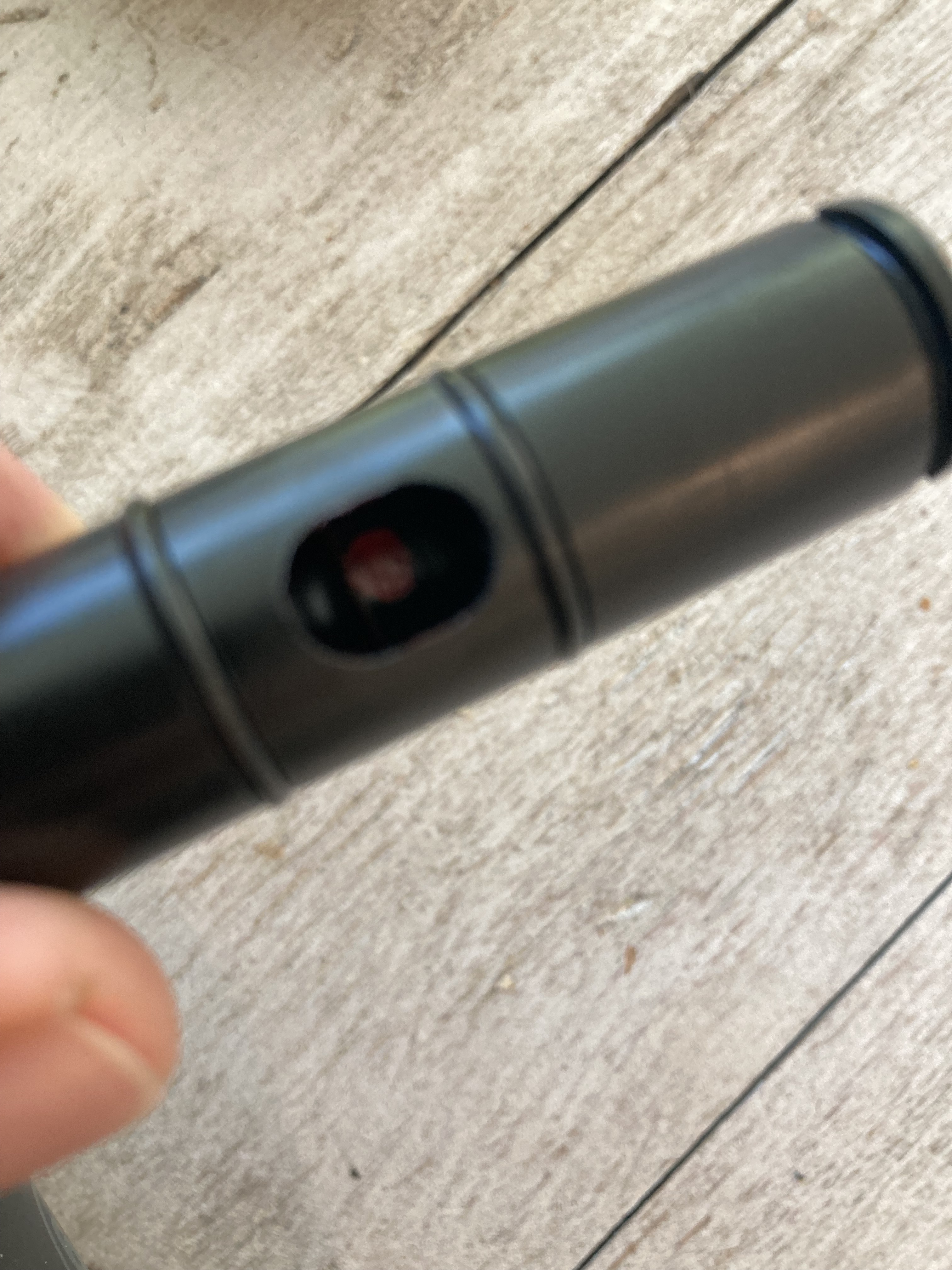

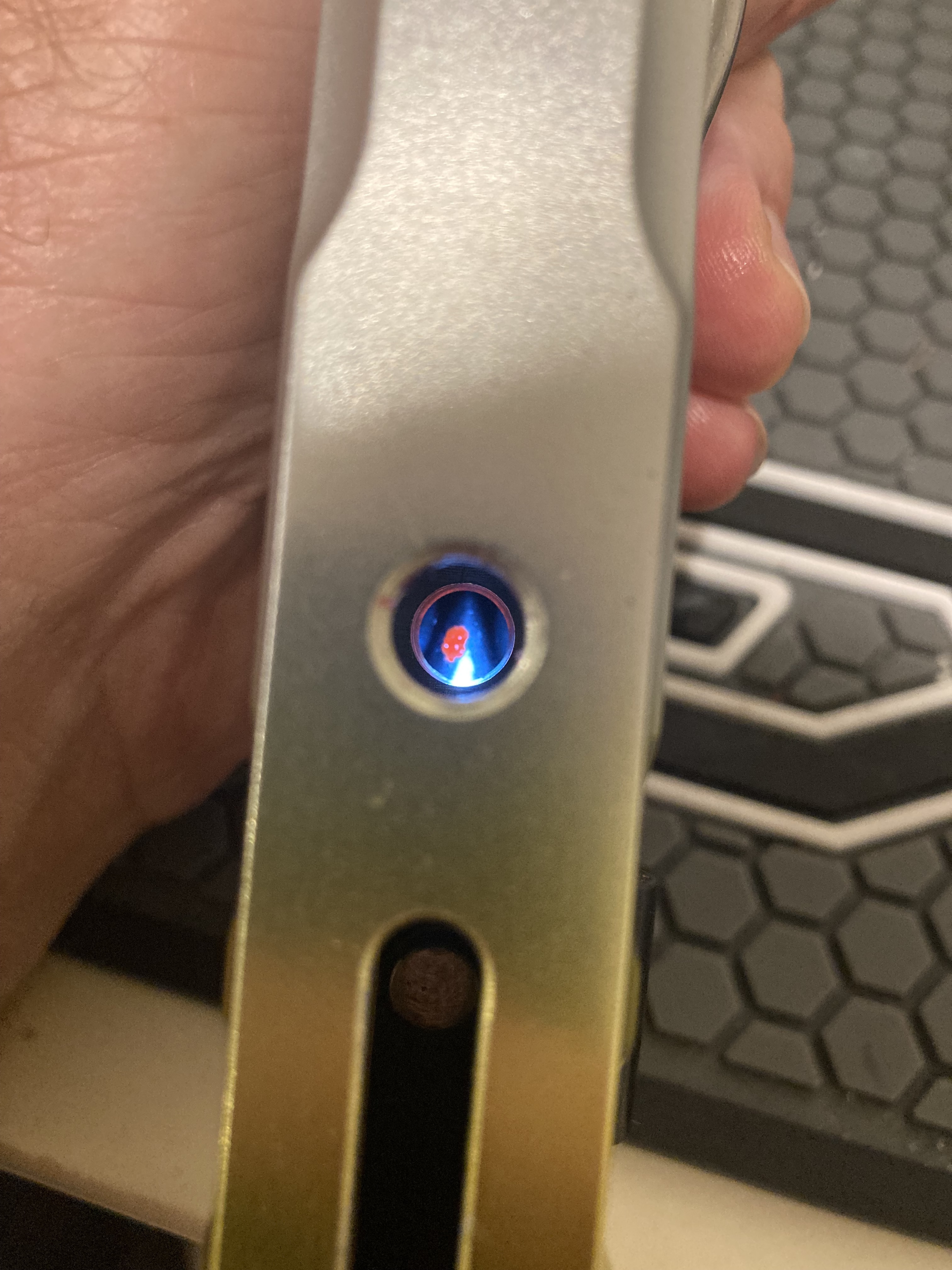

    This is a fun topic. All of the different bolt and sled designs require custom slide alignments. There is a slight difference between Inception, Tech T and Ressy bolts. There is also a slight difference between WGP and Inception sleds. I addressed this issue by using a red marking paint pen and placed a red dot dead center in the bolt’s port opening; see pic. I inserted the bolt with the red dot into the sled and positioned the assembly in the body. Look underneath the body where the valve retaining screw opening is and see if the red dot on the bolt is properly aligned with the port hole; see pic. For a Ressurection bolt with an ID slide the proper distance was approximately 3.4mm between the body and sled.
