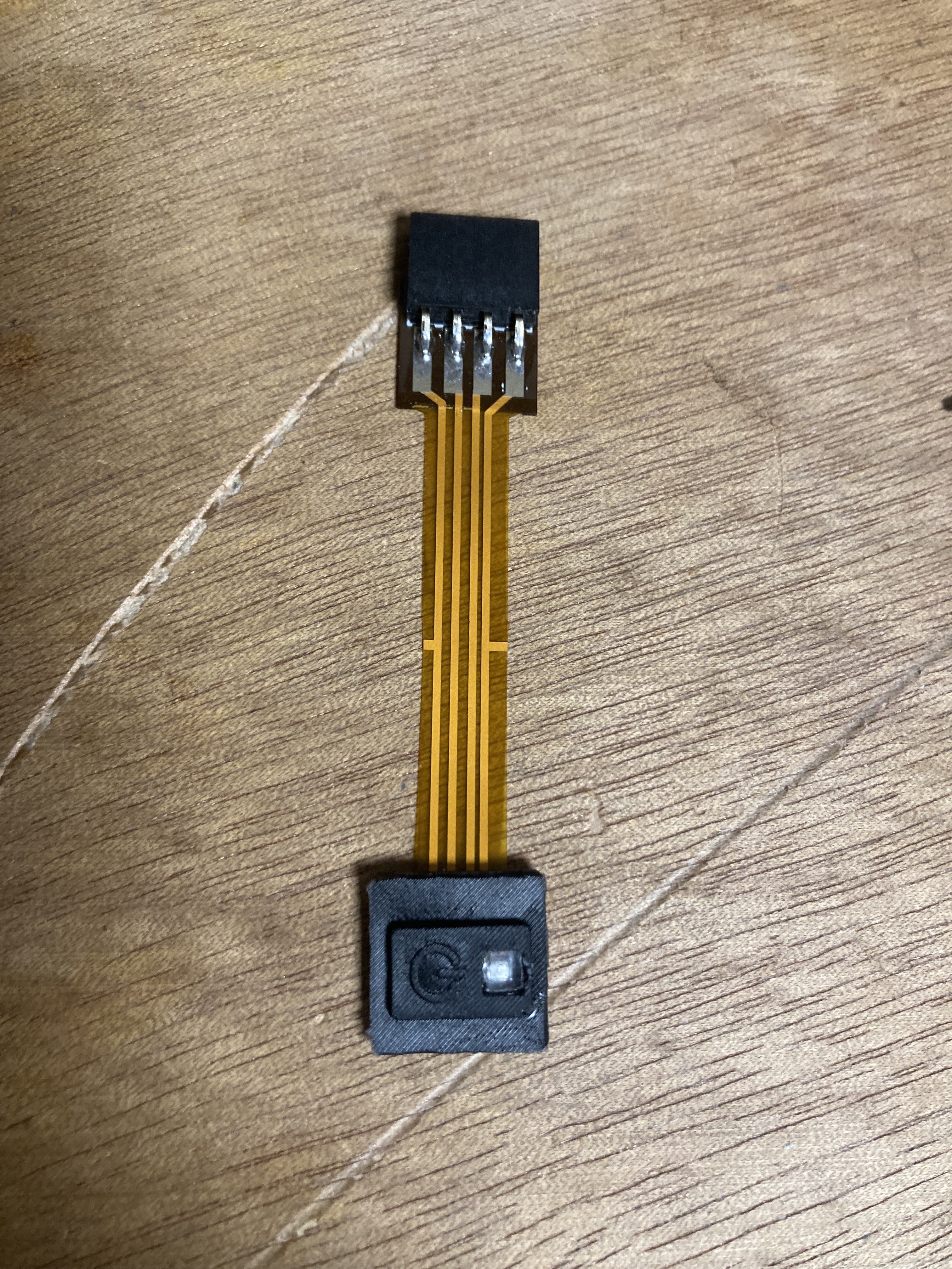

    Hey all,
    Wanted to post an update now that I’ve got a working version of the molded switch I’ve been messing with.
    What it is:
    • Flexible urethane overmold (about ~0.7mm over the actuator)
    • Internal tactile switch + PCB
    • Low-profile, sealed design meant to replace aging/failed buttons
    Why I started this:
    A lot of the original buttons on older markers are either:
    • cracking
    • delaminating
    • or just flat-out failing
    I wanted something that:
    • feels close to stock (or better...it feels better 😁)
    • holds up long-term
    • can actually be reproduced consistently
    Where it’s at now:
    I’ve got:
    • A repeatable mold process
    • Consistent actuation through the urethane
    • Working assemblies that are holding up to testing
    The current version uses a ~60A urethane which gives a nice balance between:
    • durability
    • flexibility
    • tactile feedback
    What I’m still dialing in:
    • Long-term durability (diving/sliding/snagging scenarios)
    • Finalizing assembly workflow so results stay consistent
    Plan going forward:
    I’ll be building a small batch and getting a few into people’s hands for real-world use before calling them “done.”
    Looking for input:
    • Any specific failure modes you’ve seen (tearing, delamination, water ingress, etc.)?
    • Preference on feel — softer vs firmer actuation?
    Not taking orders yet — just trying to make sure this is actually worth putting out there and that I’m solving a real problem.
    Appreciate any feedback 👍

    Great work, man. Looks good and looks better to use than the stock membrane.
    • Iseeo_0you
      Iseeo_0you commented
      The click is satisfying both in feel and in sound. A little more flashing around the edges than I anticipated. Still dialing in cutting it off for a more uniform look. When a few more are ready I'll send one out to you.
