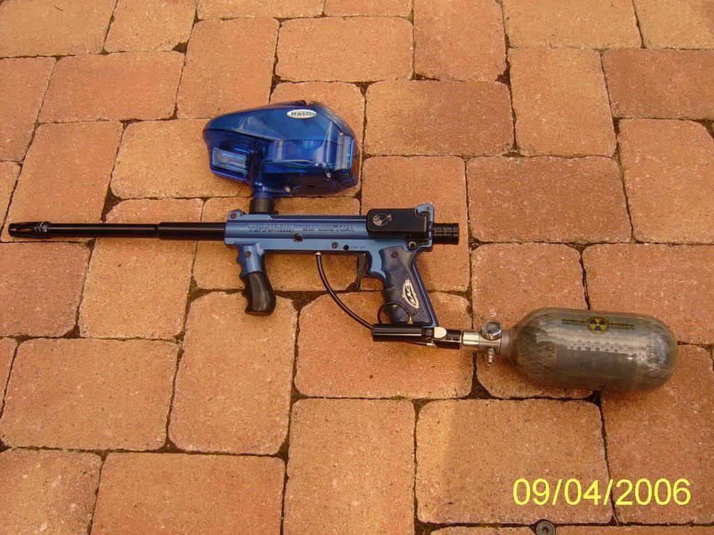

      My old ebolted tippmann had a cocker LPR on the ASA and took straight tank pressure. The reg I used was able to bring it down from 850 down to safe pressures for a timmy solenoid(~60psi?). I would love someone else to confirm, but I think your prostock lpr will handle 850psi. Click image for larger version  Name:	98ebolt.jpg Views:	3 Size:	152.2 KB ID:	839067
