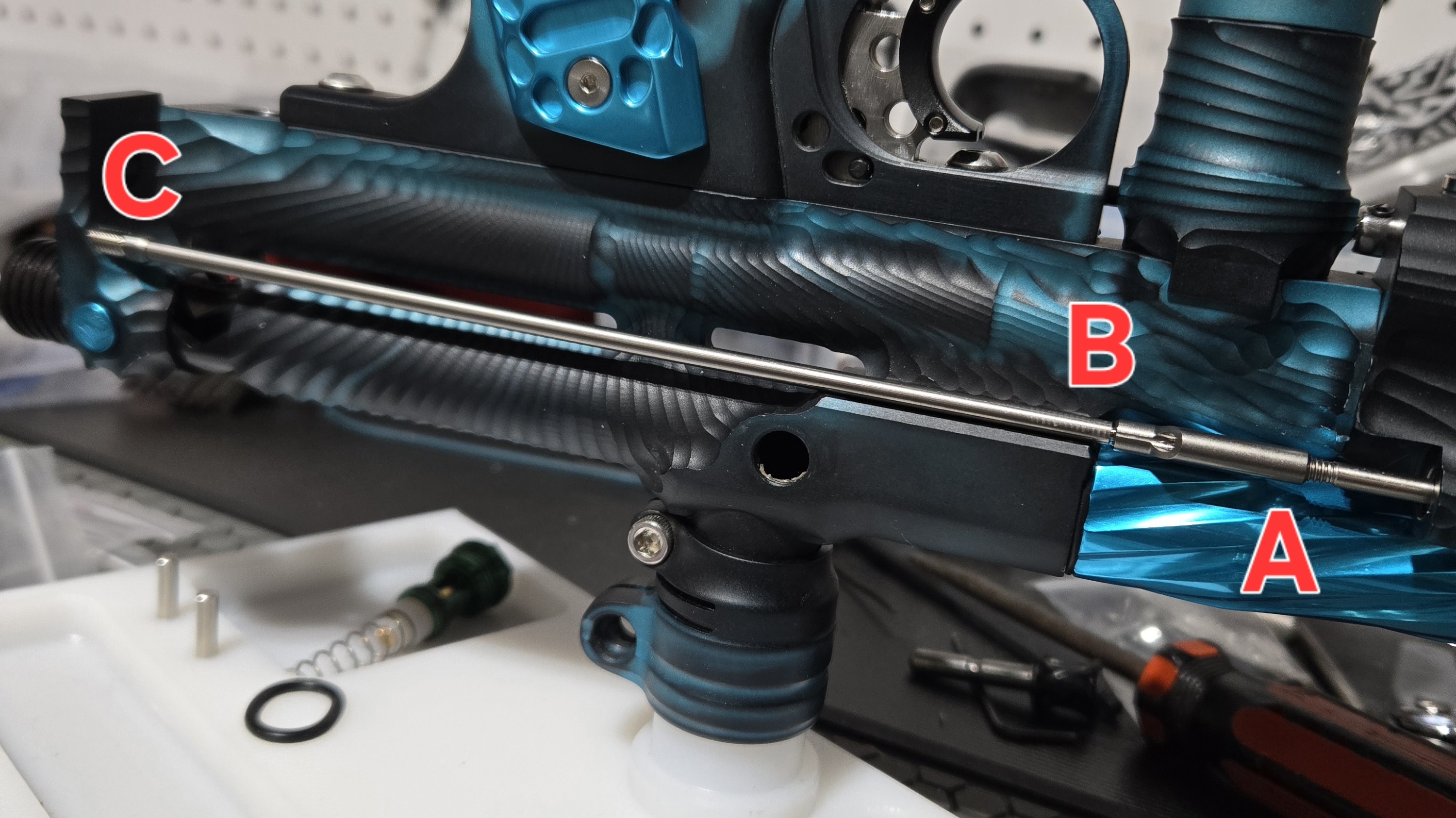

    Pump arm/back block - refer to photo for reference....ATTKTX titanium pump arm. I assume bottom out point B n loctite? Should threads at point C be flushed and adjust length at point A? Or use combination of adjustments at both A & B?
    B & A blue loctite / C you can use loctite/teflon/thread goo, nothing.
