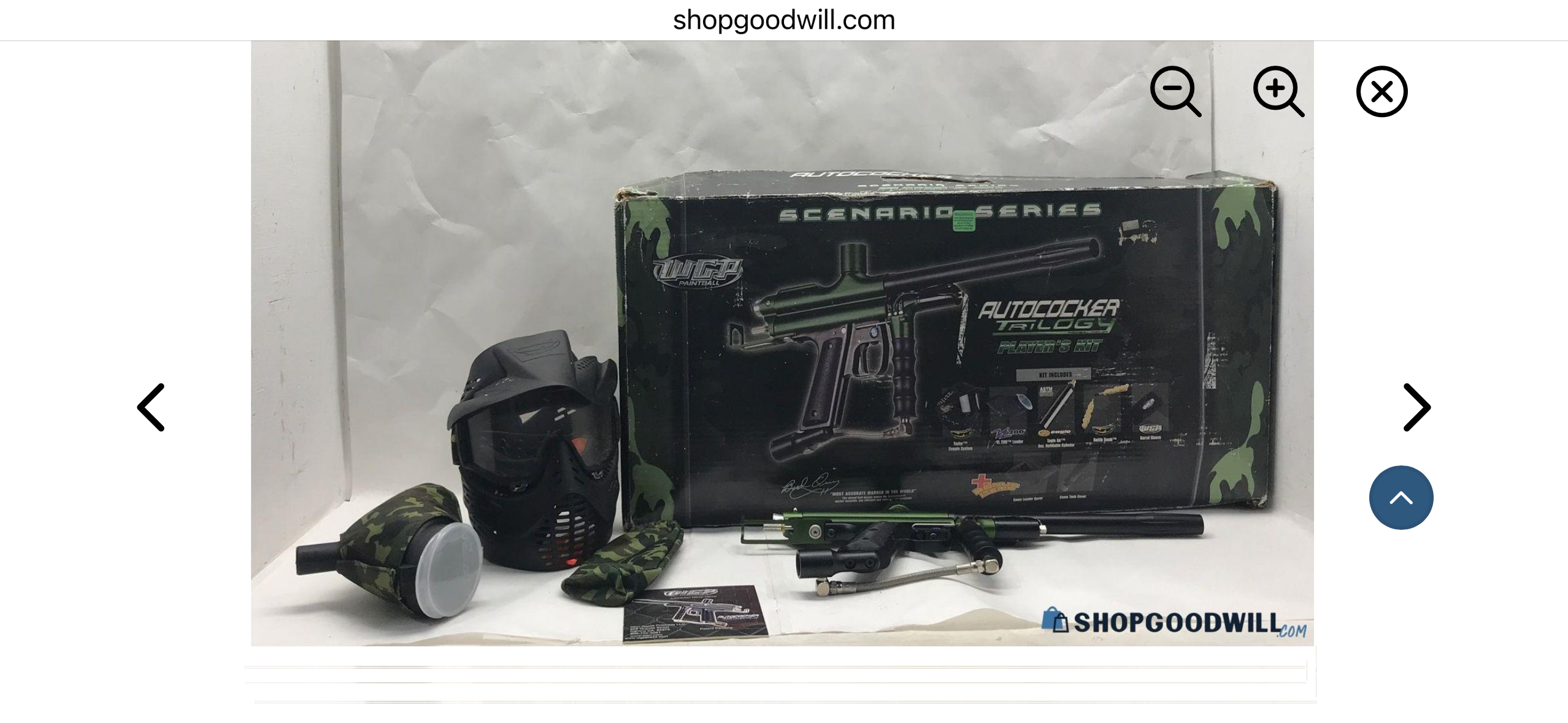

      Saw this on goodwill today
      Apparently the green trilogies are the “Scenario Series”
      Nothing special except a cardboard box instead of blister packs iirc
      Edit: how could I miss the camo loader and tank covers, very cool
