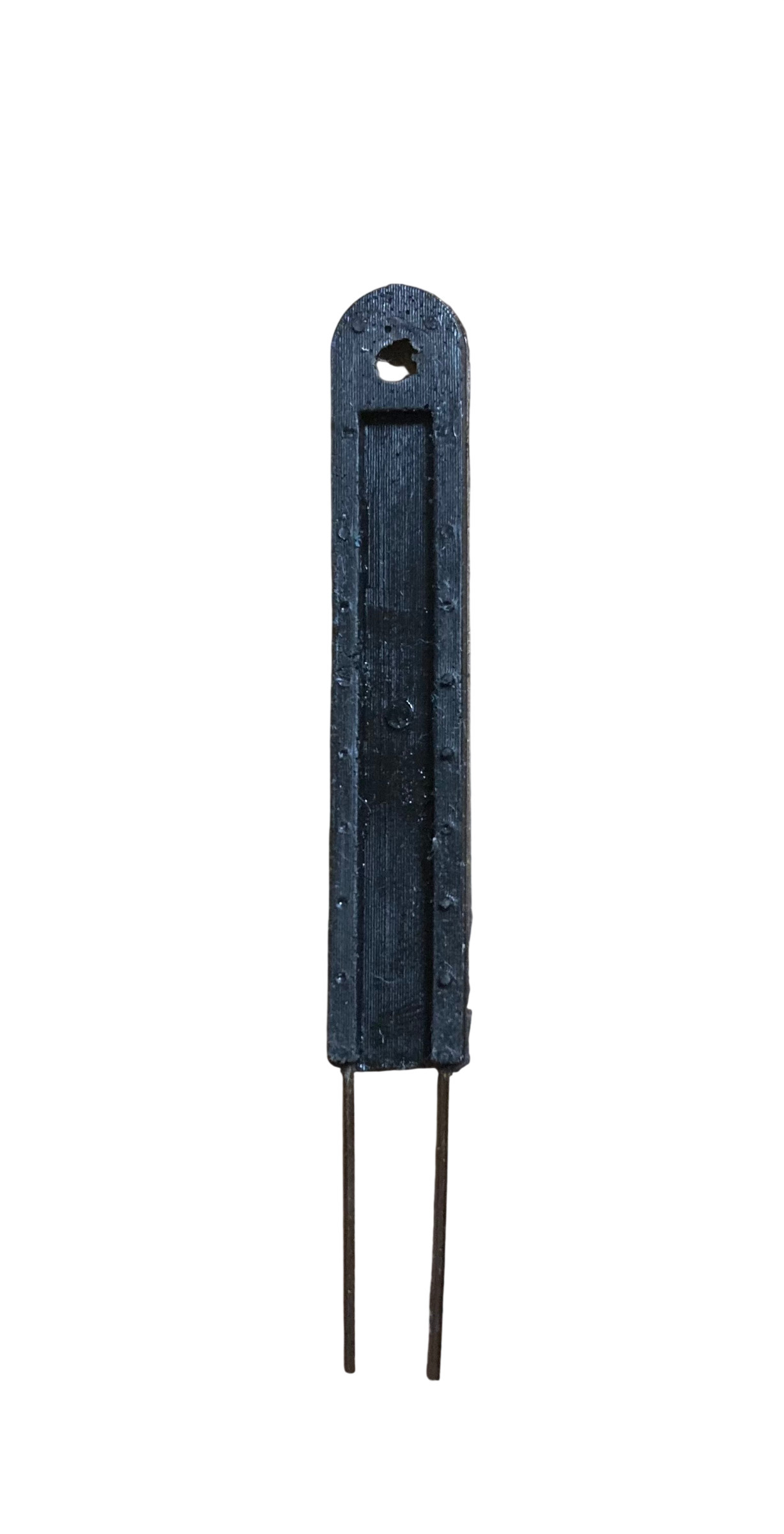

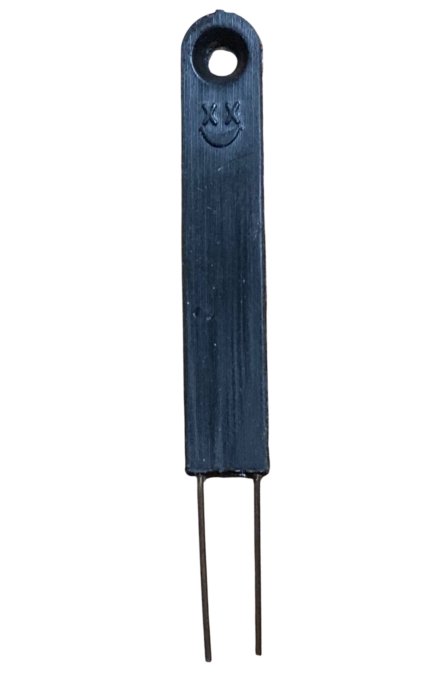

    I decided I wanted to make some Eblade eye covers since i need one for a marker. Decided to cad out a mold last night and made some. Still a bit rough around the edges before post-processing, but once i get it dialed in they should be pretty neat. Going to make them in different colors to match my markers . Thinking Red and uv reactive neon green/glow in the dark next.

    Nice! What are they made of?
    • Iseeo_0you
      Iseeo_0you commented
      Polyether urethane

      Looks good. Making the mold seems easy enough but how did you hold the wire in the right spot? Also, was this a kind of injection mold style design or something you just poured. Given the front and back features, guessing it's the former.
      Feedback - SnapshotPB
      • Iseeo_0you
        I injection molded it not poured. I built a jig into the mold to hold it in the correct place as it was injected. Still could use some refinement though.
