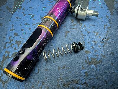

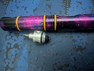

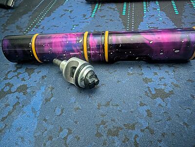

    Trying to chrono and my Karni is just going wild +- 100fps and then constant leak down the barrel. Threw it back in the gear bag and this is what I found taking it apart today. Hardly seeing a problem here. Valve stems are supposed to be 10 pieces, right?

        Oh man, what valve is that?

          Genuinely no idea, I have a few in the toolbox and this one ended up in my hand first. Just ordered a Lazarus valve to try that out though. If that ends up not being good I'll just move on to the next valve I guess.

        Wgp plastic cupseals are not aging well.
        I've had three fail on me this year

          Orrcale valve and springs. Set the reg at 250 and the IVG # 3truns in ......300 FPS back out IVG 1/2 turn 285

            Ordered a laz valve and I'll try one of the lightest hammer springs to see how that goes with it. I do have some other valves I can use if it doesn't work out.
