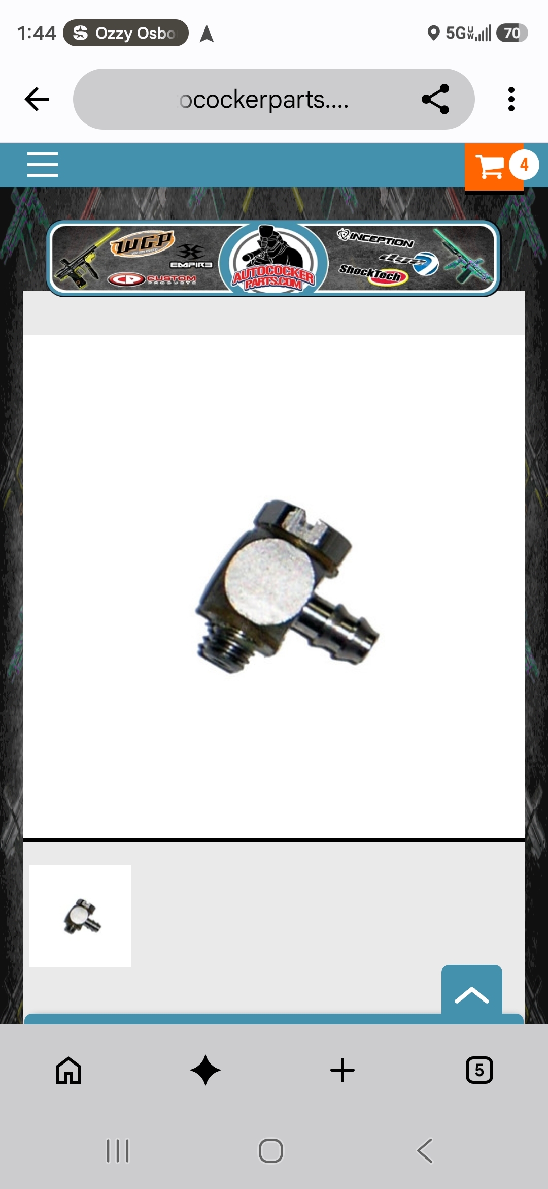

    I have a similar leak from these style of air fittings. Swapped them for the straight barbs and solved the leak. I have looked but have not found just a replacement seal for these swivel style.
    • Buff_phroggie
      Buff_phroggie commented
      Aliexpress has replacement ones. I hate to say it is probably cheaper and easier to replace them
