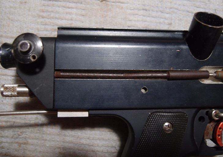

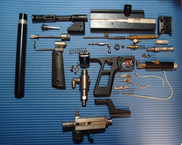

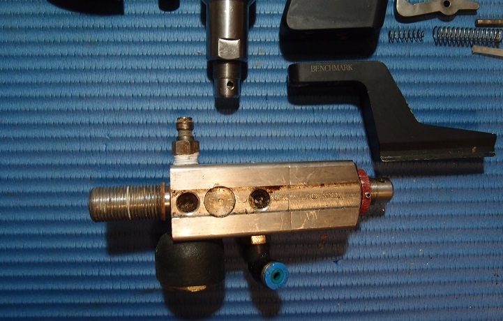

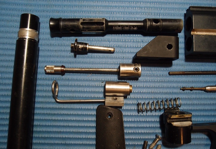

    This was a Craigslist find..... It came apart fairly easy and will take a bit of cleanup....
    - The grip frame mounting screws needed some heat to get them to come out, one needed a slot cut as the hex was rounded out.
    - The bolts mounting the drop to the frame also needed some heat.
    - Everything else came apart with no issues.
    - The low pressure hoses were brittle.

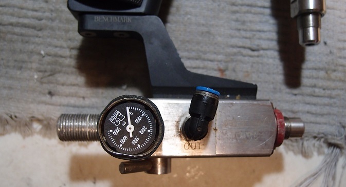

    - Total weight: 5-pounds, 8-ounces.
    - The Apocalypse tank reg weighed 1-pound, 8-ounces by itself.

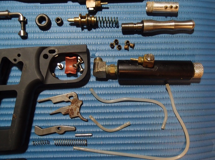

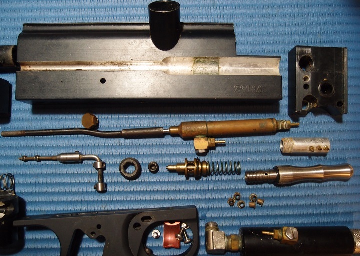

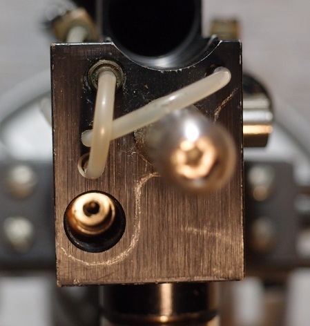

      Cleaned and started to reassemble.......
      - LPR seems to be working...
      - replaced the valve, cup seal material was cracked, new one seals fine.
      - had to double up on the vasa to body orings. When the relief for the 3-way was cut it impacted the oring groove. I doubled up on the orings (one inside the other) to put more pressure on the outer one to seal the cut. Seems to have worked, it was leaking beforehand.
      - replaced the 3-way orings
      - needless to say, the AA HPR will need some work to get it apart for a rebuild.
      - waiting on more low pressure hose to be able to test further.

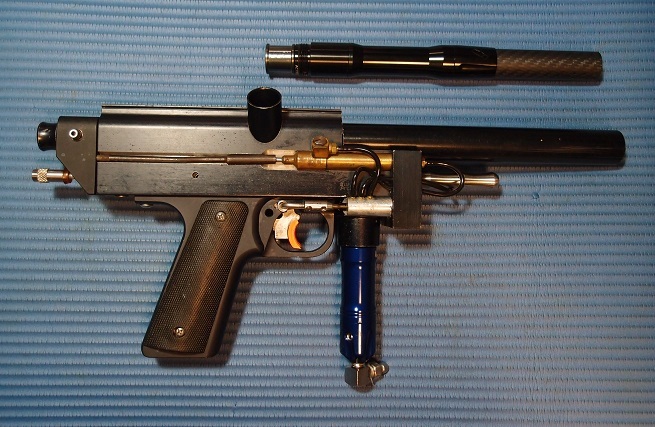

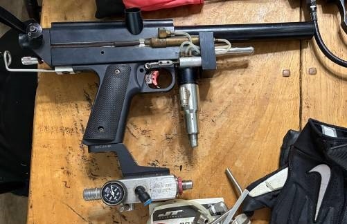

        Update:
        - Disasembled
        - Cleaned
        - Replaced bolt orings
        - Replaced the switch orings, used 003, as 002 was too small
        - Replaced the valve guide and cupseal, the original seal was cracked, used a similar stock WGP valve.
        - Replaced the Rock piston oring
        - Replaced all lpr hose
        - Replaced front block orings
        - Set IVG all the way out
        - Used a CP HPR for testing, set to 400psi initially
        - PWR barrel with a .677 insert to match my reballs
        - Reassembled using everything else that came with it
        - Set initial timing: backblock position, cocking rod length, bolt clearance, timing rod length

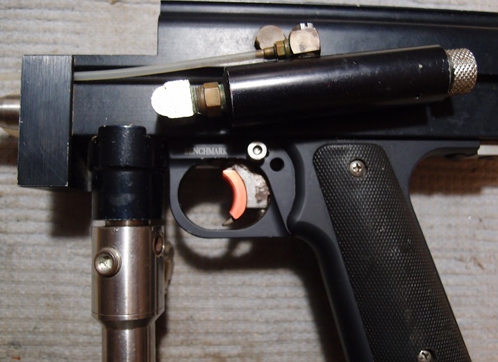

        Results:
        - HPA tank at 750psi output
        - Very slight leak at the lpr barb
        - No other leaks
        - Timing rod adjustment for proper cycling
        Time to dig out the chrono and see if it will shoot at field speeds and cycle reliably.
        Results:
        - Cycles fine, not the fastest Autococker but reliable.
        - The gun is shooting between 280-285 FPS, reliably. With the HPR set at 400psi, and the IVG adjusted all the way out.....
        - Crazy stuff.......
        Things to do;
        - Fix the leak at the LPR barb
        - Source a permanent HPR for it.... The Air America it came with will need some work to get apart...
        I'm happy with it......
