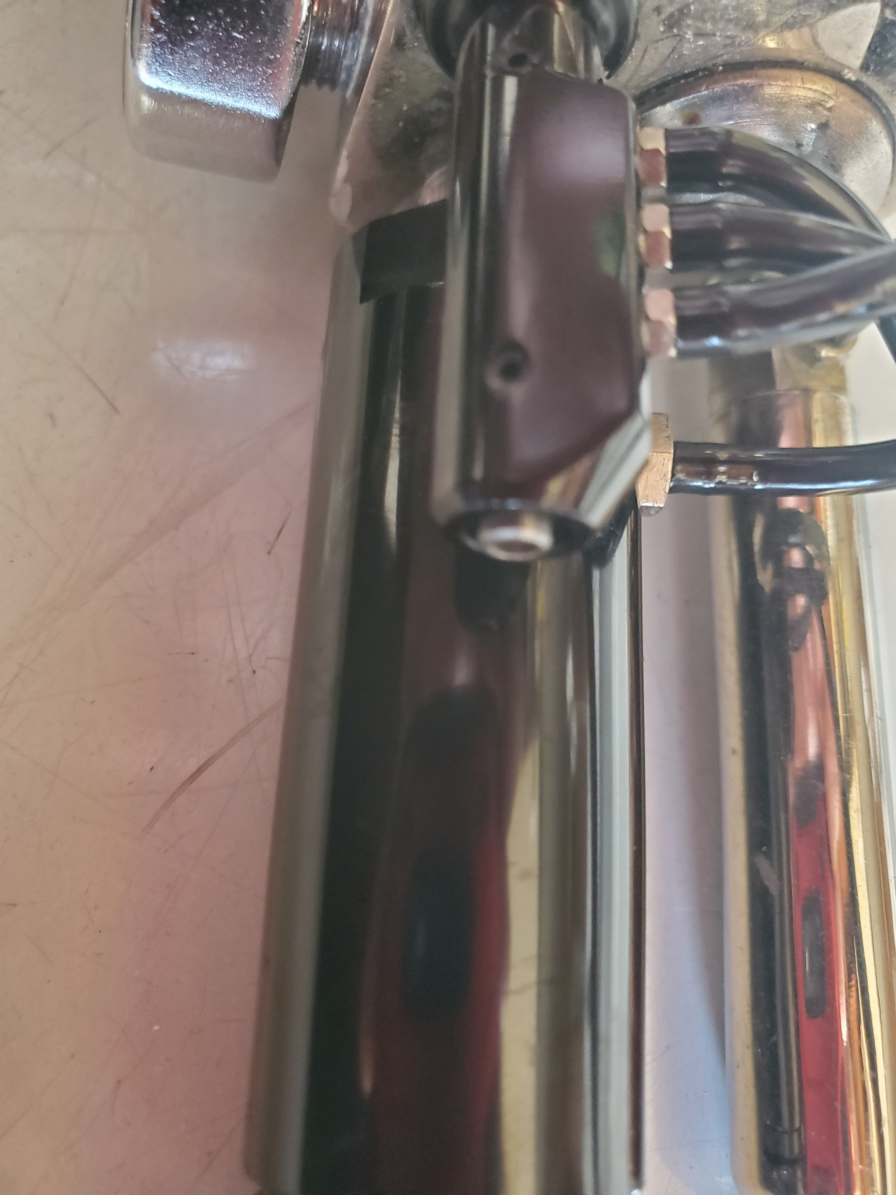

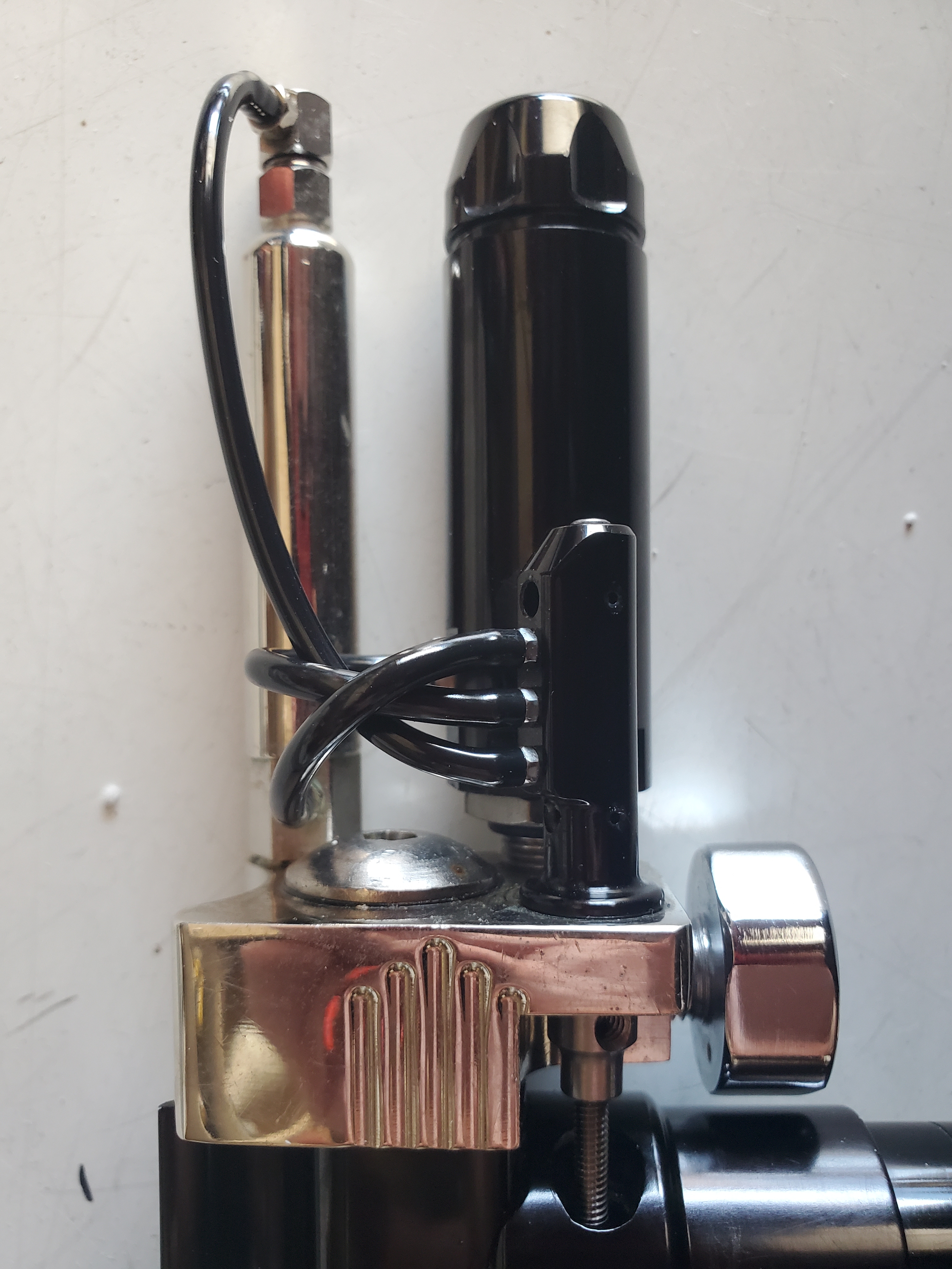

    Ok so what is wrong here. Air leaks out of the 3 way. I replaced the orings. It's all inception pneumatics.
    I bought the marker like this, Hoses on wrong? Too short trigger bar?
    Slider trigger frame, not hinge

    Looks like the 3 way is out a lil far. Screw it in flush should get you real close.
    Without seeing the frame we can’t tell you if the hoses are oriented properly. Hinge and Sliders are setup differently.
    • flyweightnate
      • 1918
      • Dallas, TX
      In some cases a bad ram lets air past the piston, through the hose to the backside of the 3 way. Disconnect the ram front hose for a quick check on this oring.
