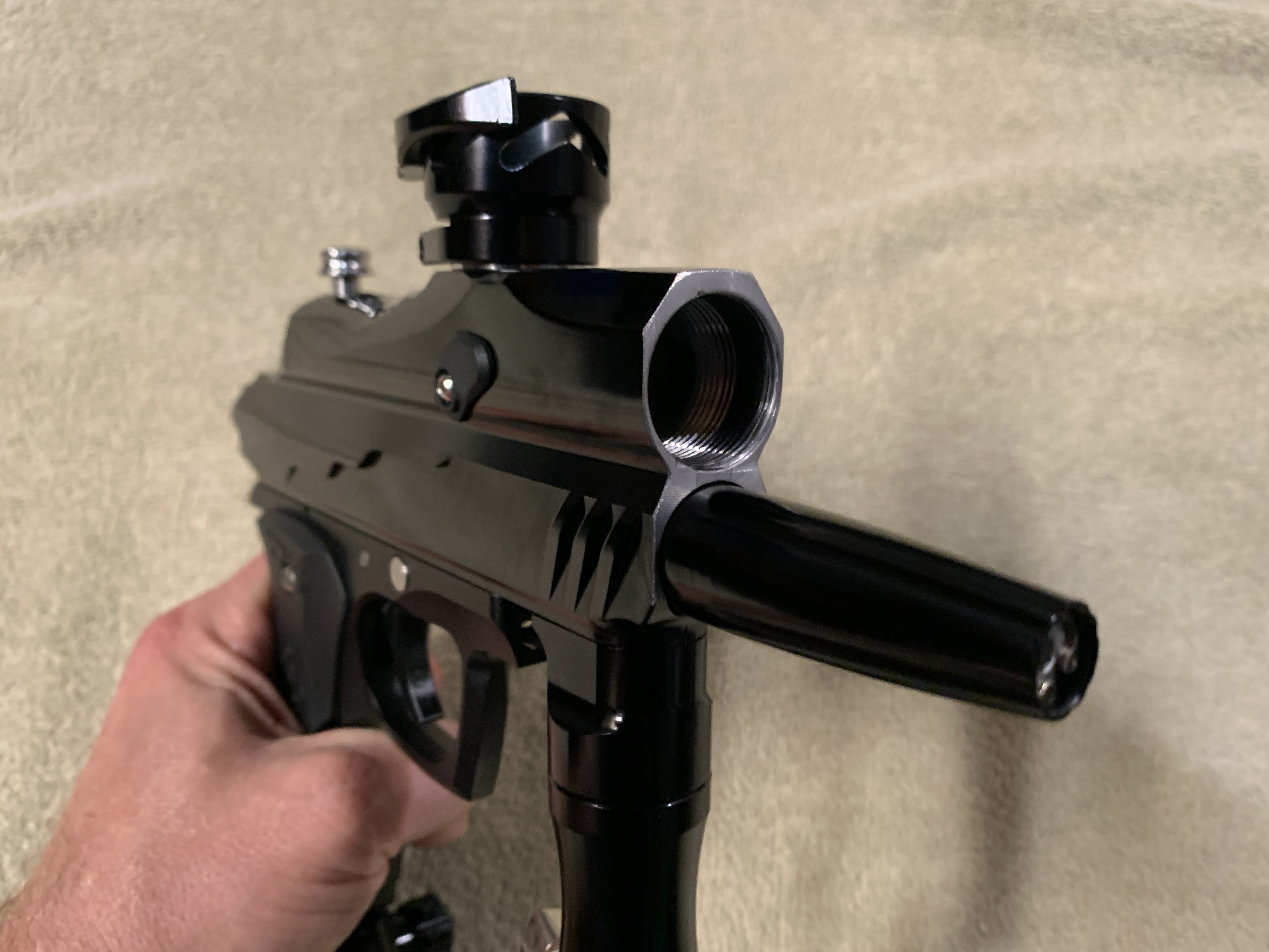

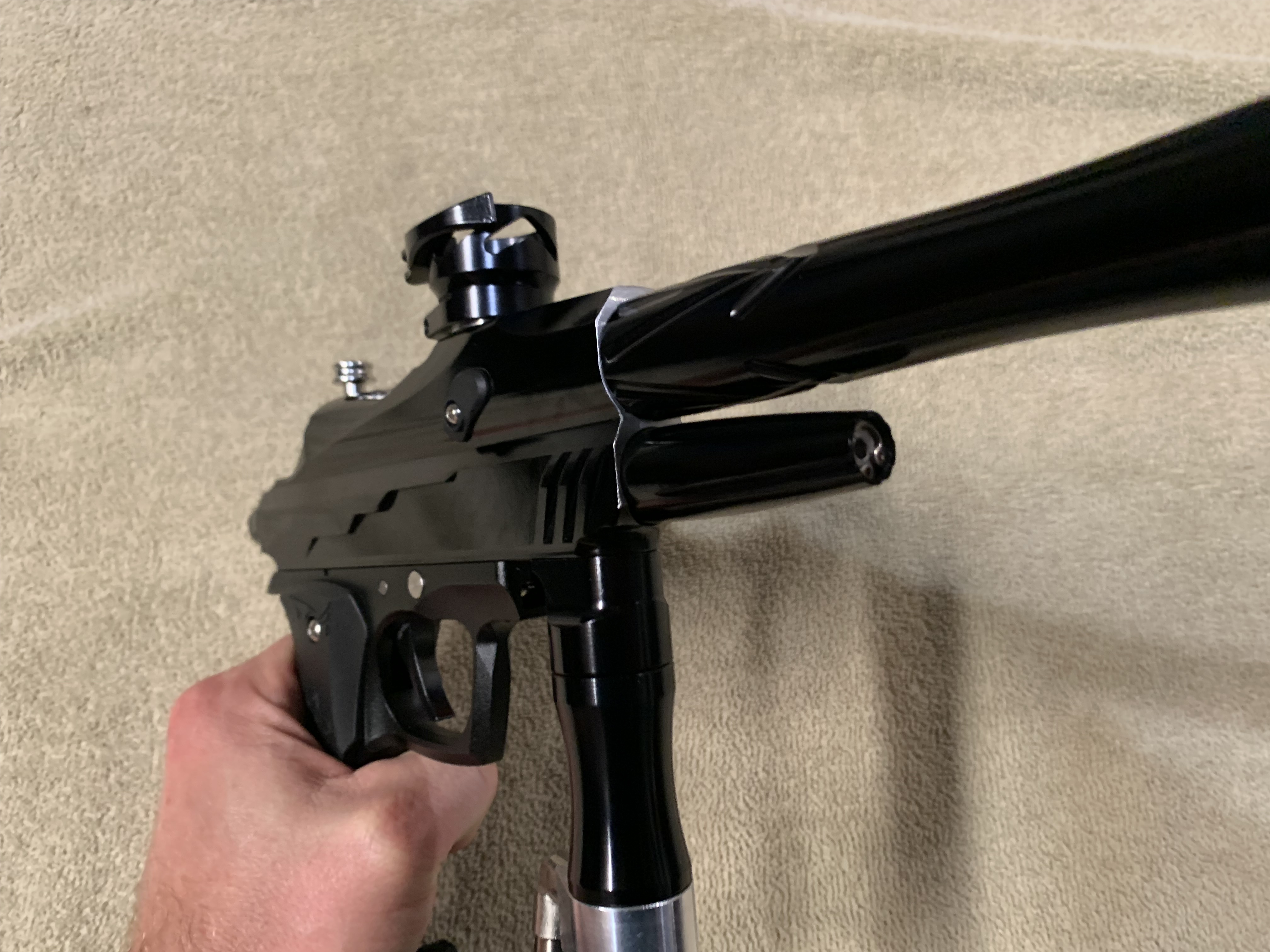

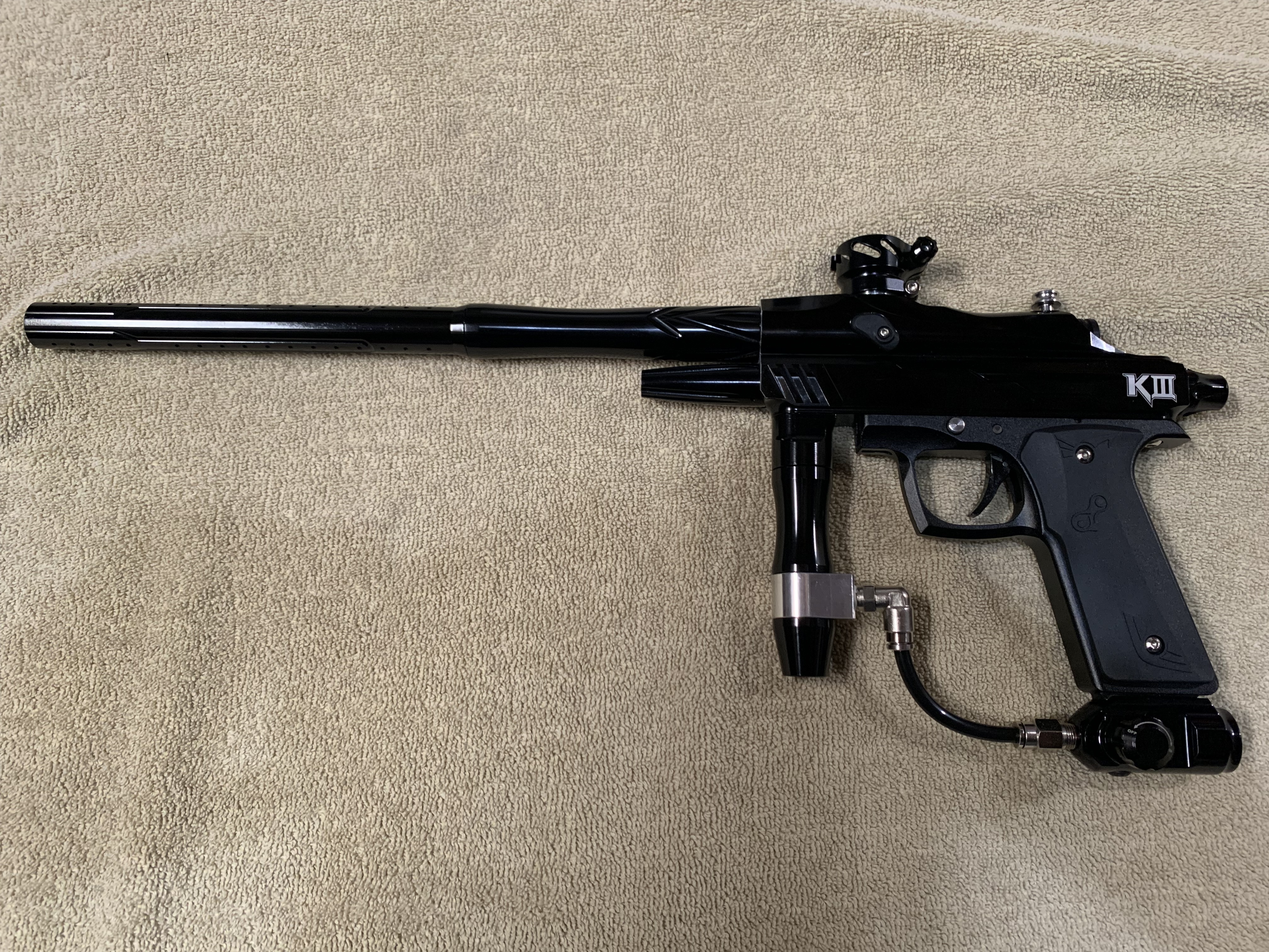

        3. If you're able, mill the front of the body rearward and tap the barrel threads deeper about .300". This will allow the bolt to push the ball into the barrel before releasing the air blast. Pictures attached below.

        One other note: You'll see in the pictures, mine has a custom regulator swivel. The stock one cracked at some point when airing up the marker. Due to all the o-rings and fittings near that location, it took me a while to figure out it was a crack. Hopefully, this doesn't happen to you or anybody else.
