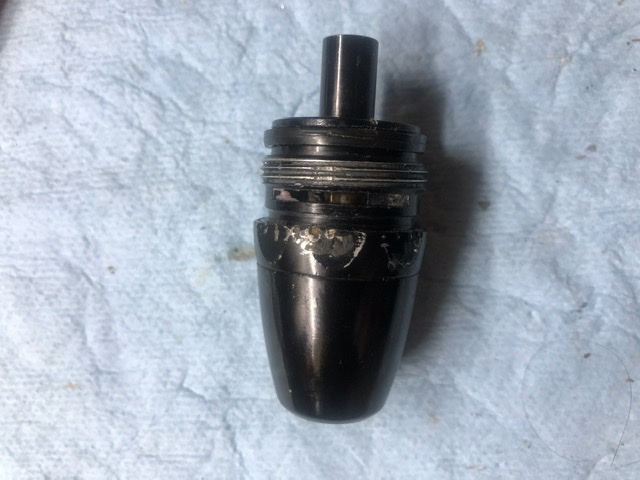

    I recently procured a Dark Timmy. The lpr is creeping badly, and I can’t figure the best way to separate the lpr. I think it’s a 2k5.
    Click image for larger version  Name:	D88A3192-1B52-41AA-8A3F-5E2608485C31.jpeg Views:	3 Size:	75.9 KB ID:	36363

    Got it to open without damaging further. Adjustable wrench and rubber bands for grip.
    Fixed the creep issue, replaced orings and new grease. Been plugged in air for a while and pressure didn’t rise. I now need pressure settings. What is the lpr and hpr supposed to be set at?
    Found the factory pressure windows:
    LPR 70-80 psi
    HPR 200-280 psi
