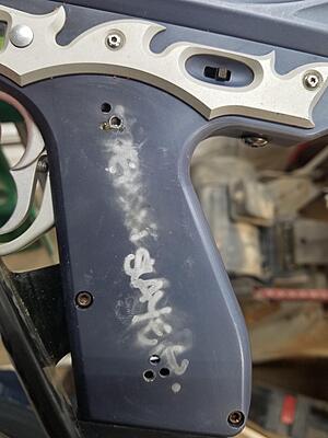

            Picked it up, navy dust fade with silver accents, a volumizer behind the LPR, a Sidewinder set to 85psi, Shocktech bolt, Hybrid ram cap, Equalizer 2.6 firmware (WAS?) and shot right out of the box with a reball. (Any way to force the eyes off on these?)
            Removing a grip, I saw this. The seller mentioned that he purchased from a pro up north a while ago. Anyone recognize the name?

              If a reball is in the breach, it should fire with the eyes on, right? So no need to turn the eyes off for that part, or was it just a general question?
              In any case, yes, it is possible to turn off the eyes on the WAS Equalizer boards, or at least I believe that was the case for all versions/firmware. The menu accessible with the two buttons flanking the display, should be fairly intuitive. Also, you can find several manuals for Intimidators (and others) at https://pbmanuals.com/
              I can't remember what firmware I have on my Equalizer - I'm at work at the moment - but the menus and functions were pretty much like in the manual at https://pbmanuals.com/.

                THOSE ARE BUTTONS!? Well, that should help matters...
