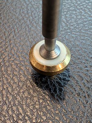

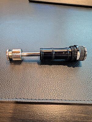

    After getting it back together I still have a pretty good leak down the barrel so I pulled my valve out and gave it a polish following Myrkul's steps. I also flipped the cup seal over assuming that it's omnidirectional but still have that pesky leak.

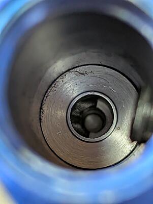

    I had a little free time yesterday and went to my local shop (Critical Pursuit Games) and Dane made a great observation which is obscured by the HRP adaptor in the picture above, but when I put the valve back in sent it a little to hard on the lock screw and actually pushed the valve out of center. So I backed that screw off a bit and moved the valve around just to help the o-rings re-form, and now I am down to just a little breath of a leak down the barrel.
