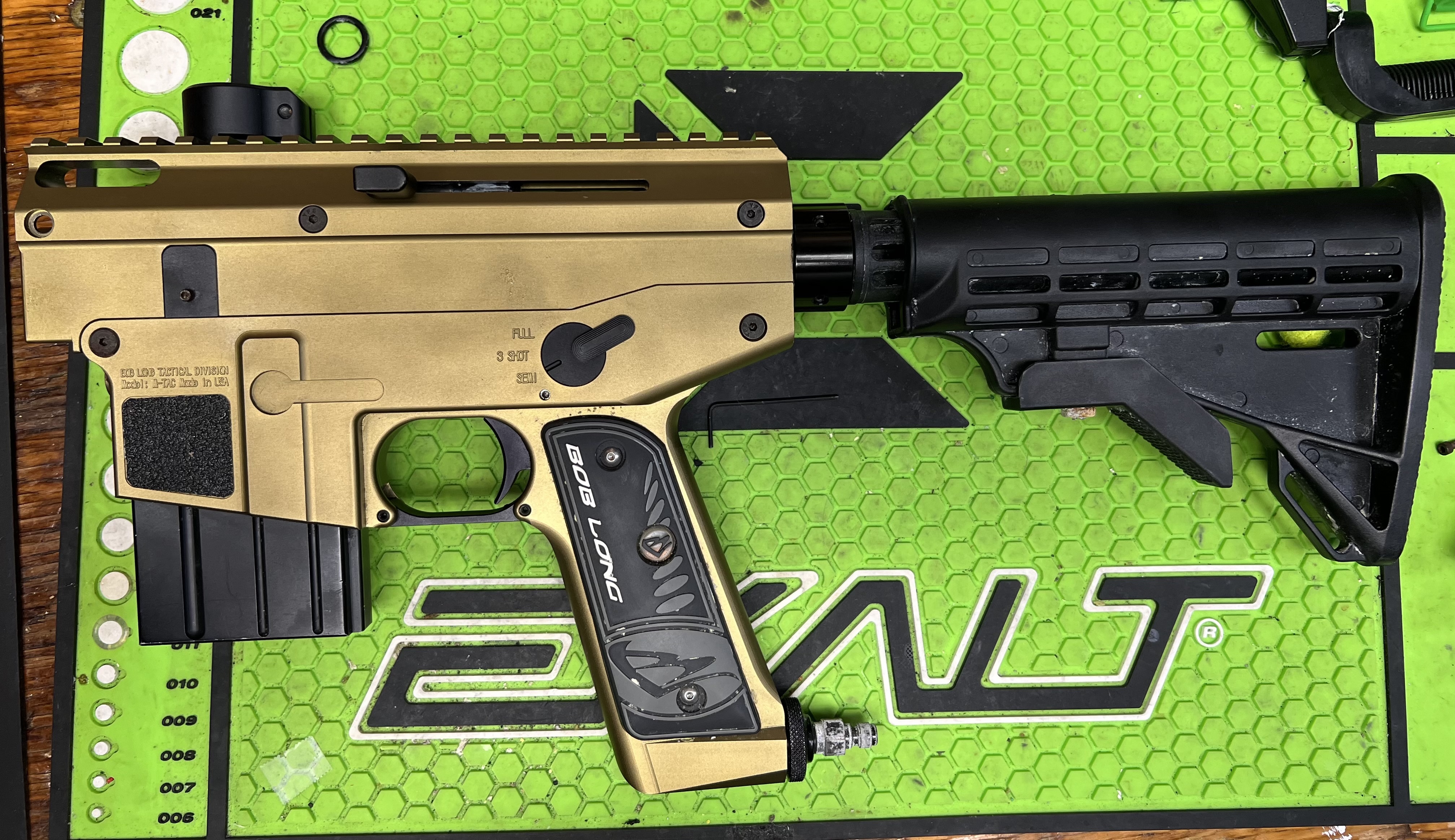

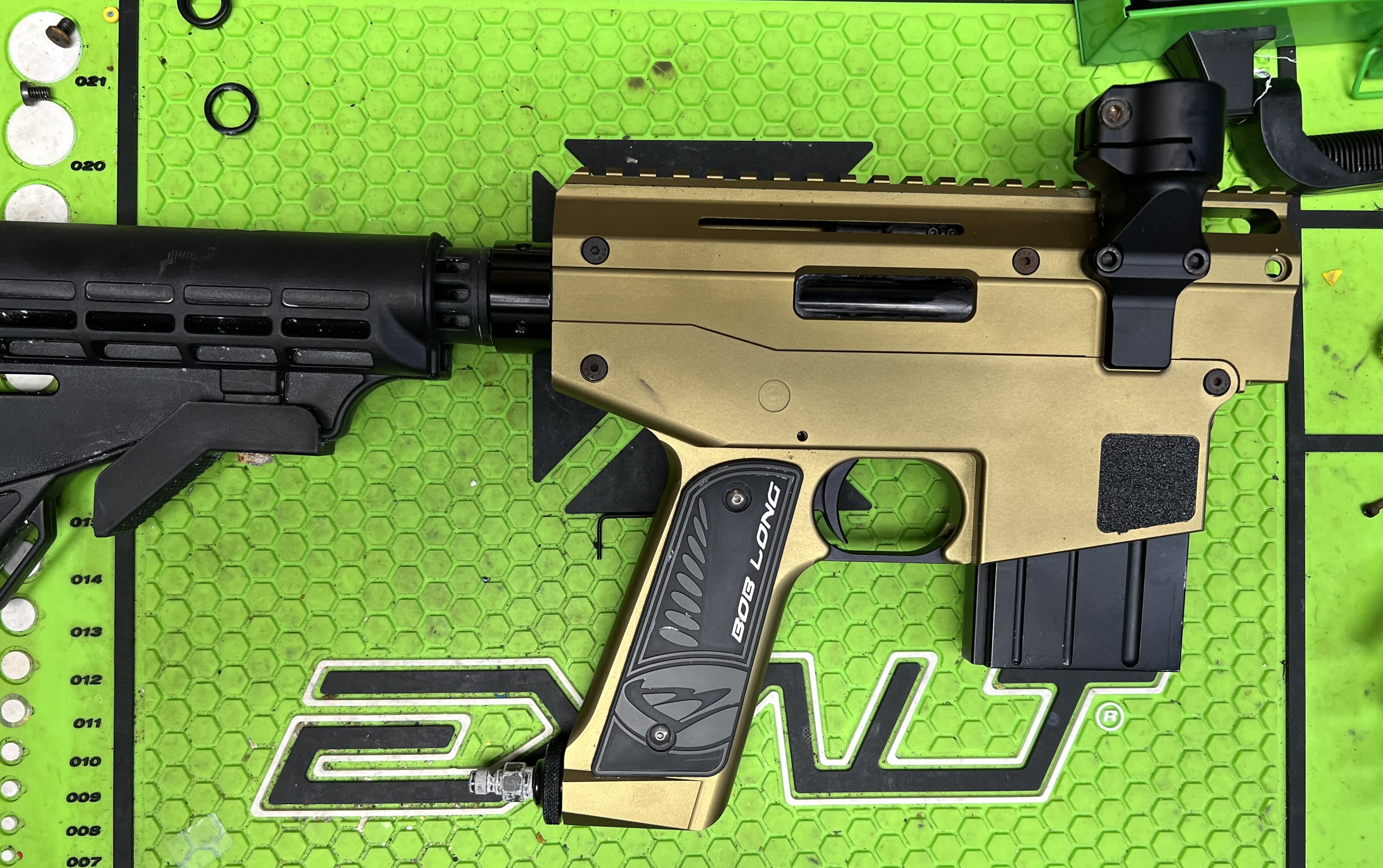

    My fourth Bob Long in a row is a Bob Long M-TAC, a Marq -based tactical shooter using the Proficiency Engine. Featuring an offset feedneck, aluminum uppers and lowers and capable of using 4c eyes.

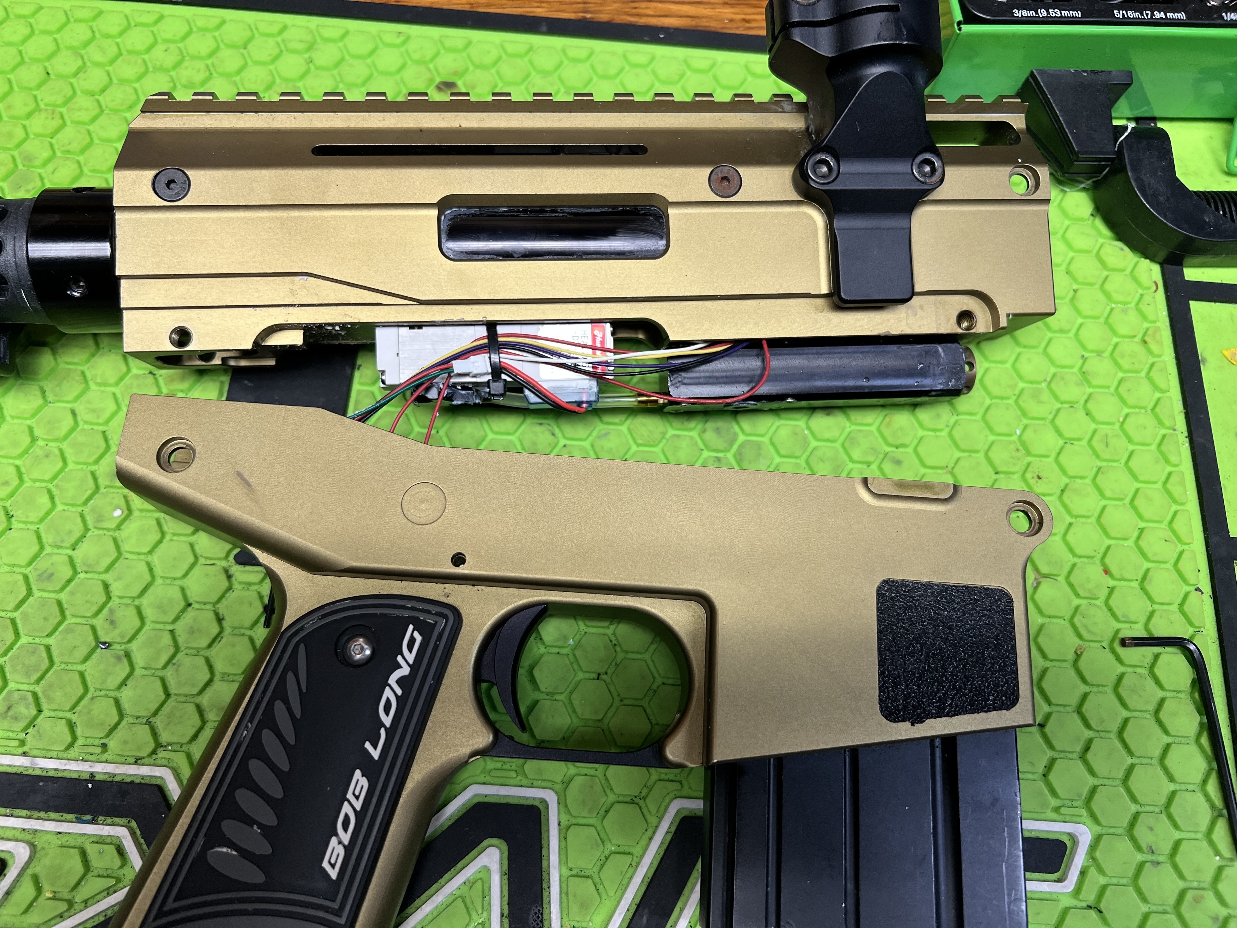

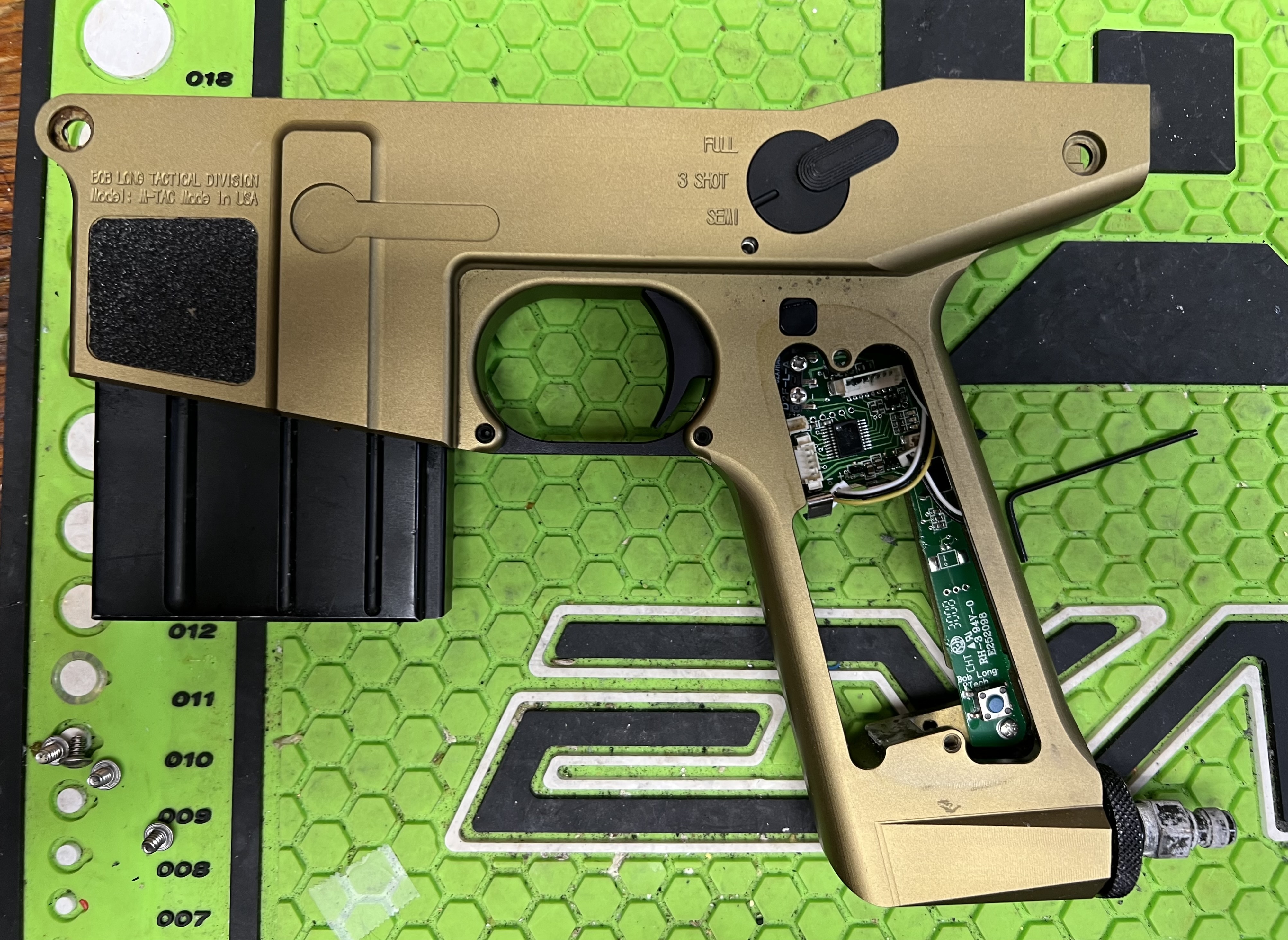

    First step is separate the upper and lower section. So removing four small bolts you can split the receiver.
    Click image for larger version  Name:	IMG_4216.jpg Views:	0 Size:	3.30 MB ID:	724059

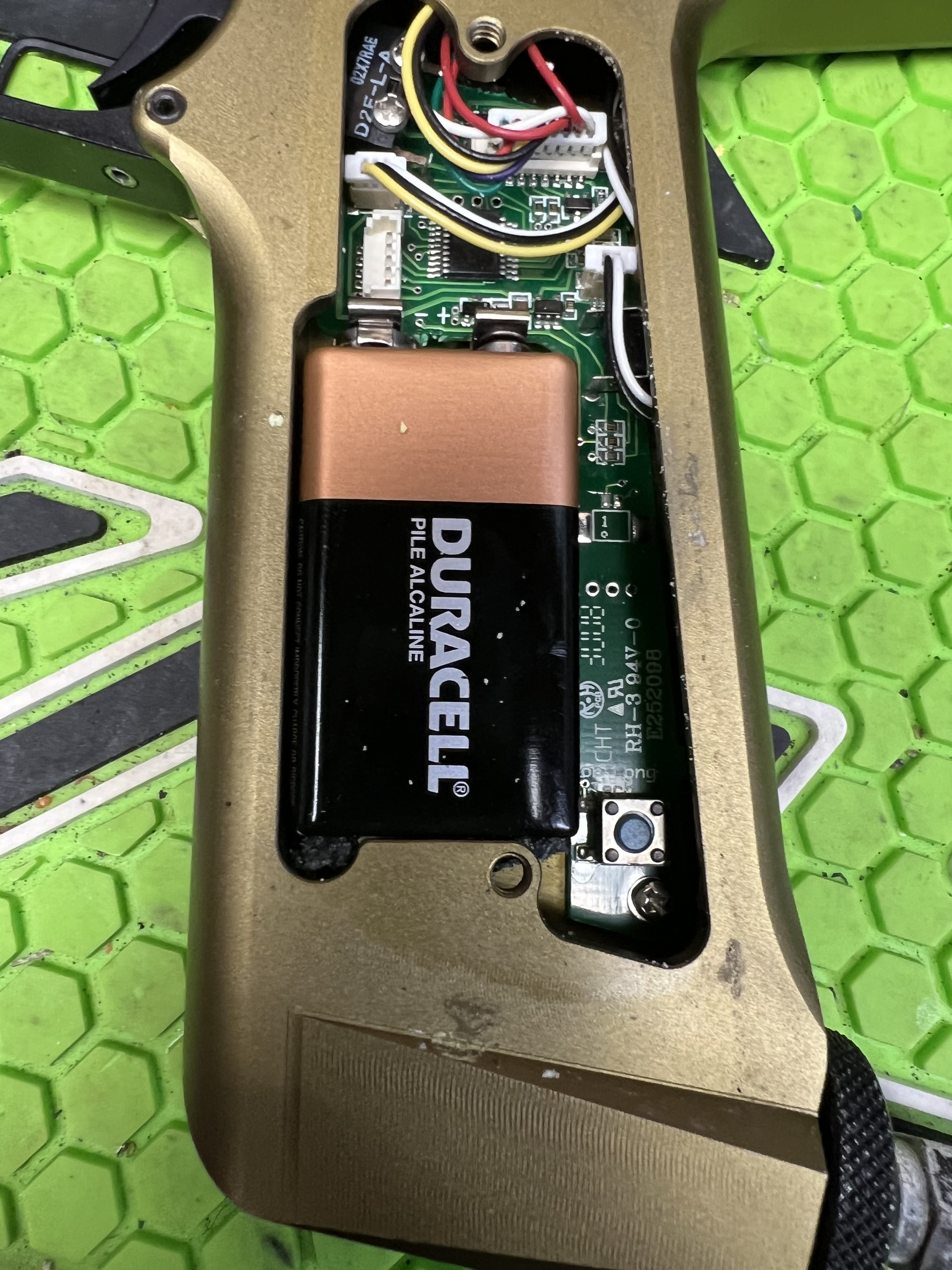

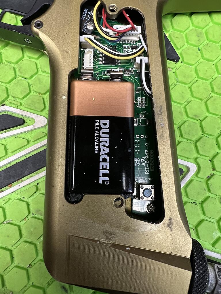

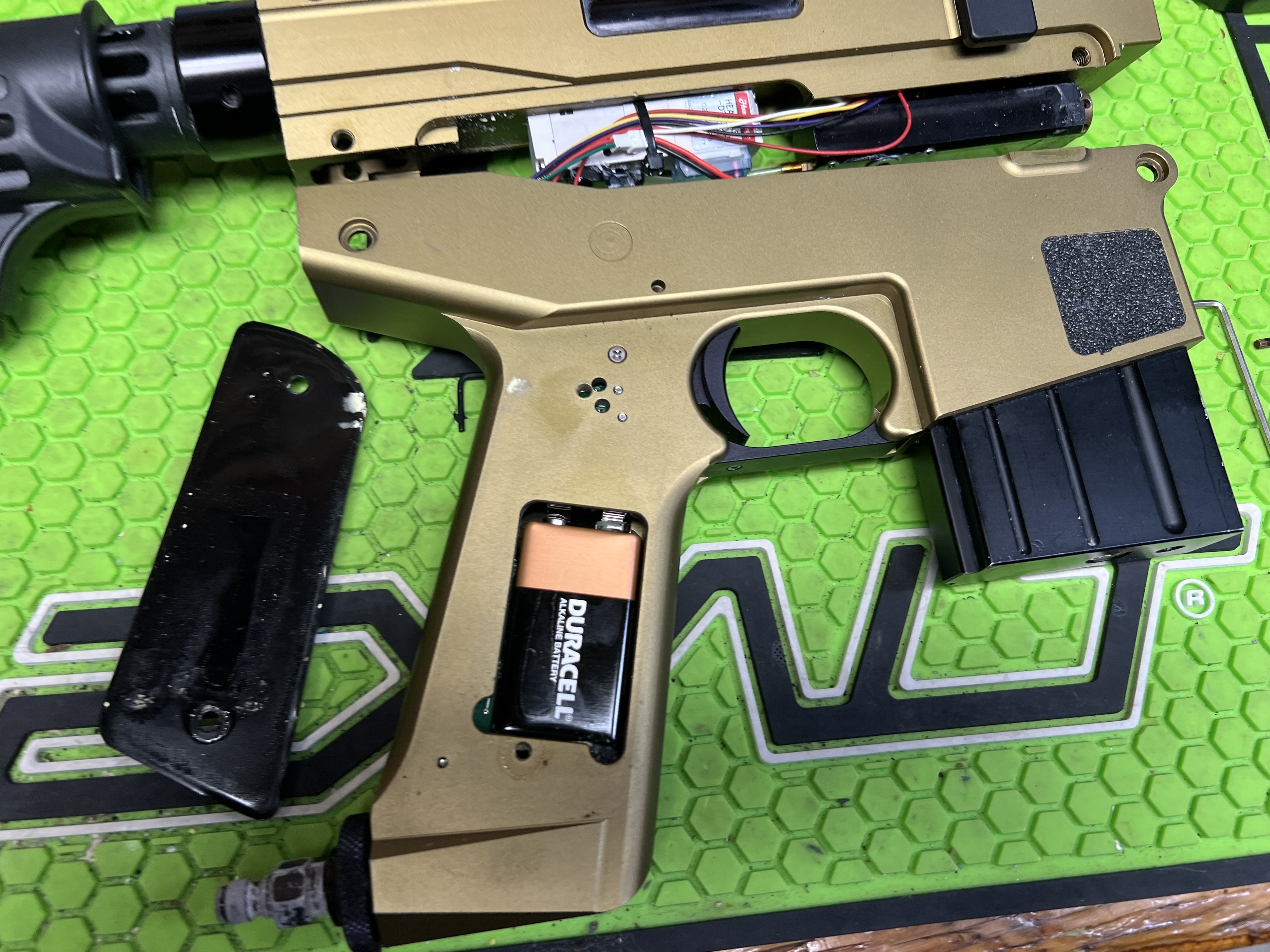

    Now I need to remove the grip frame to get at the board. And oh look, another battery!
    Click image for larger version  Name:	IMG_4217.jpg Views:	0 Size:	2.47 MB ID:	724058 Click image for larger version  Name:	IMG_4218.jpg Views:	0 Size:	1.94 MB ID:	724056

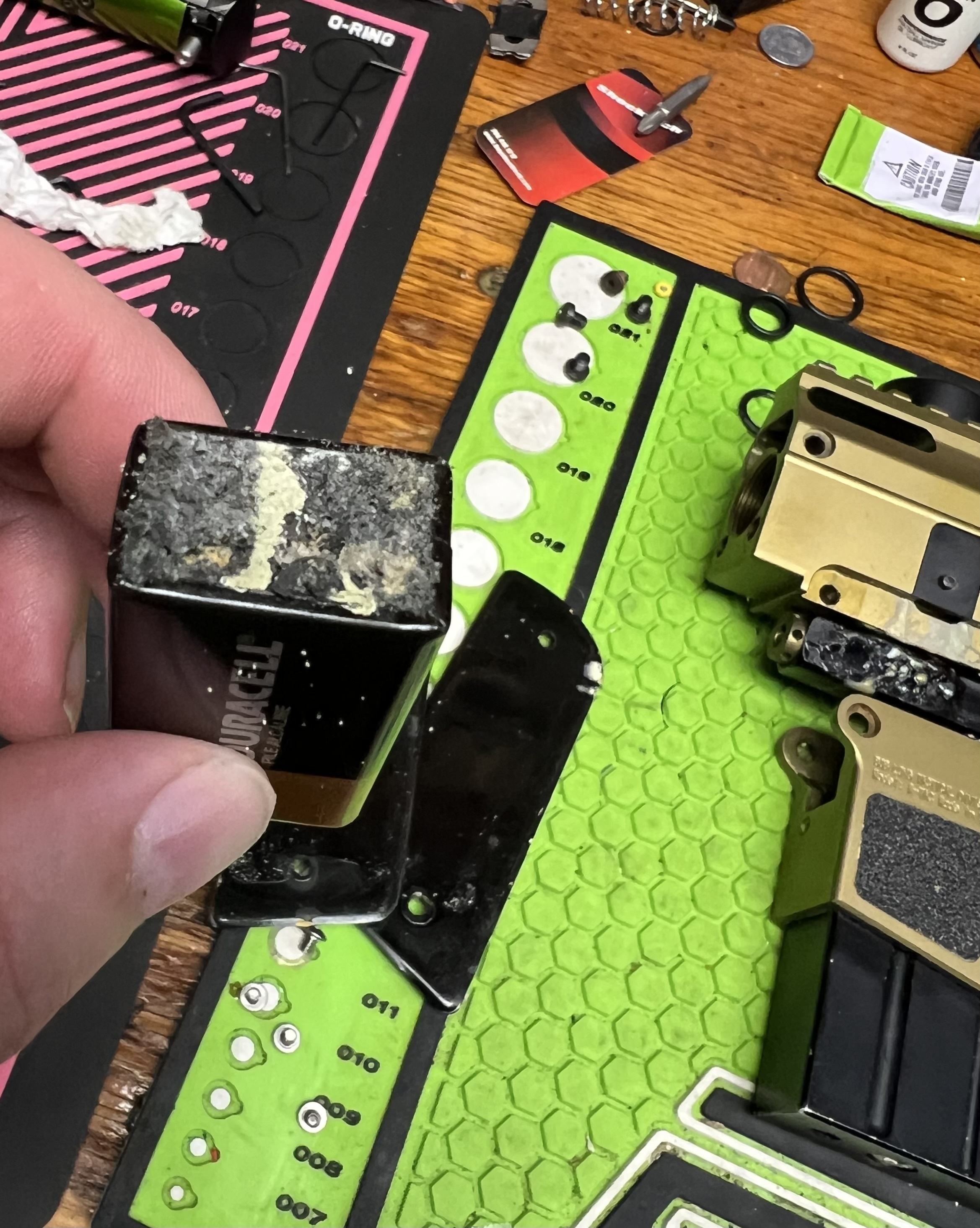

    And this battery’s bottom has completely corroded off. Never seen that with a 9 volt before.
    Click image for larger version  Name:	IMG_4219.jpg Views:	0 Size:	1.19 MB ID:	724057
      • 4560

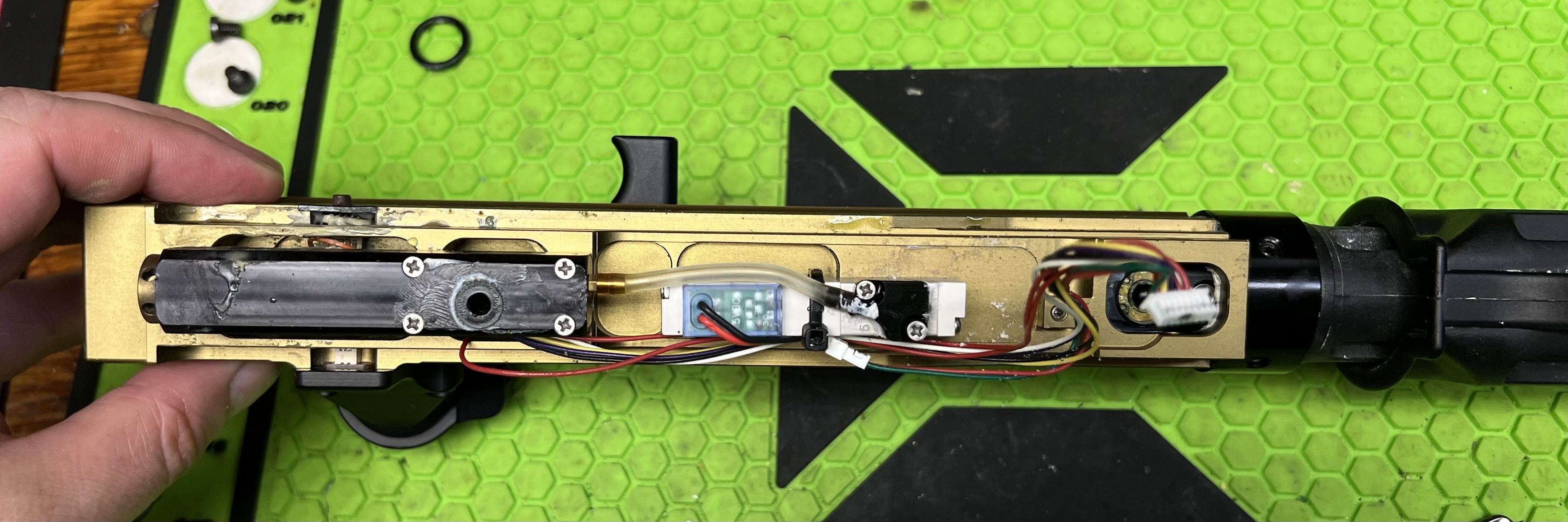

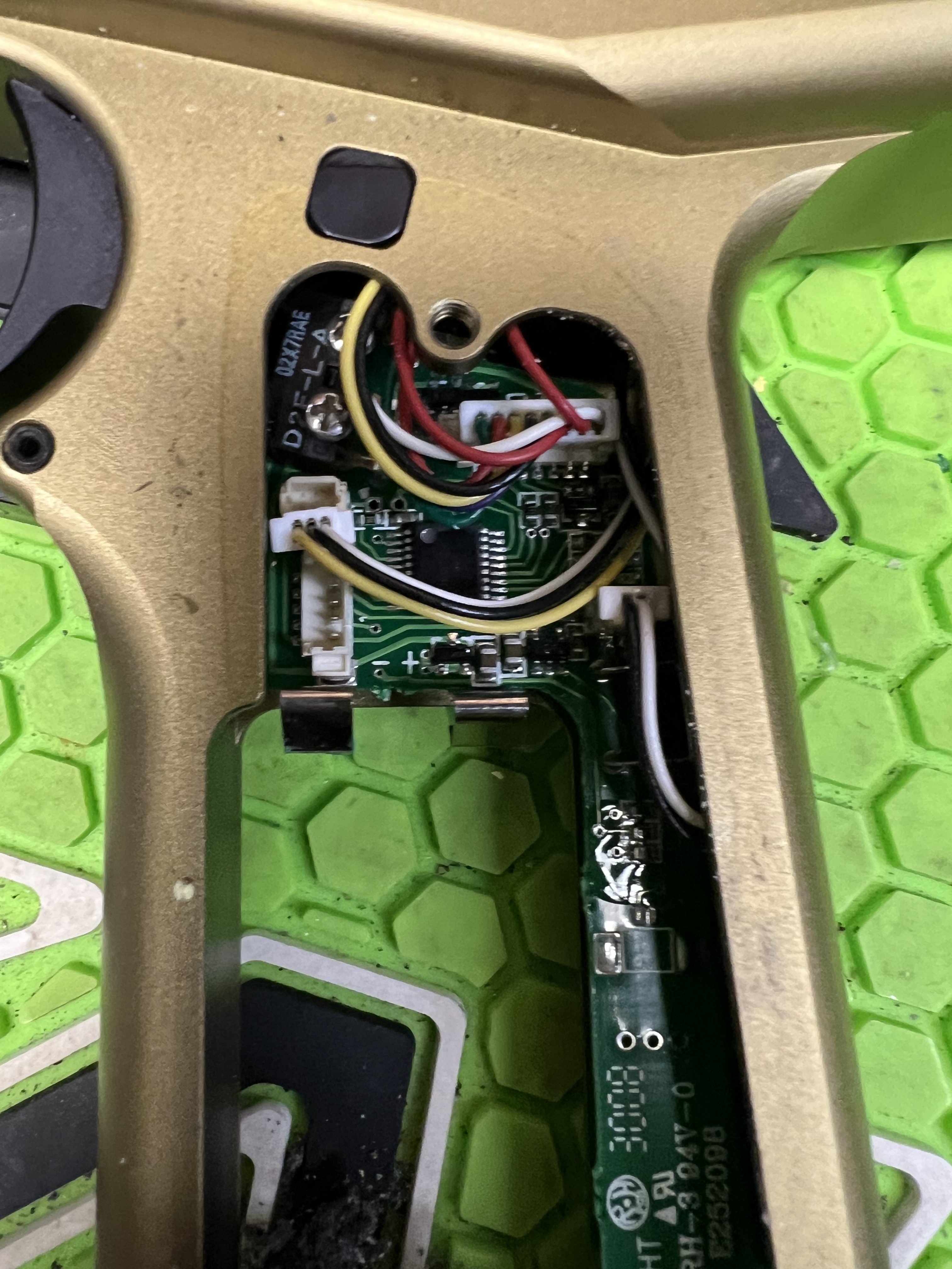

      So now I can see the board and I can disconnect the solenoid and eye wires.

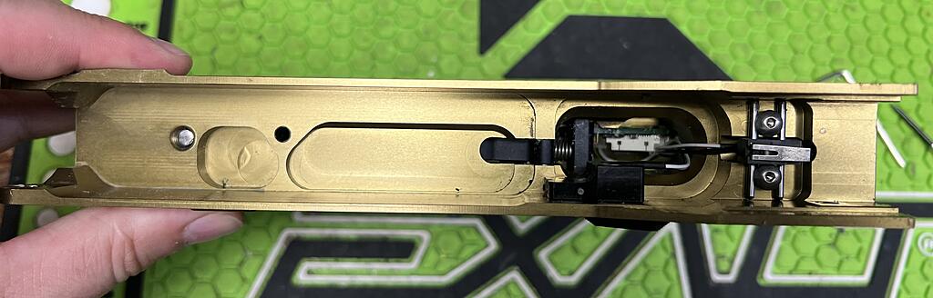

      And now the halves are separated and we can see how the lower receiver connects:
ID:	724062 Click image for larger version

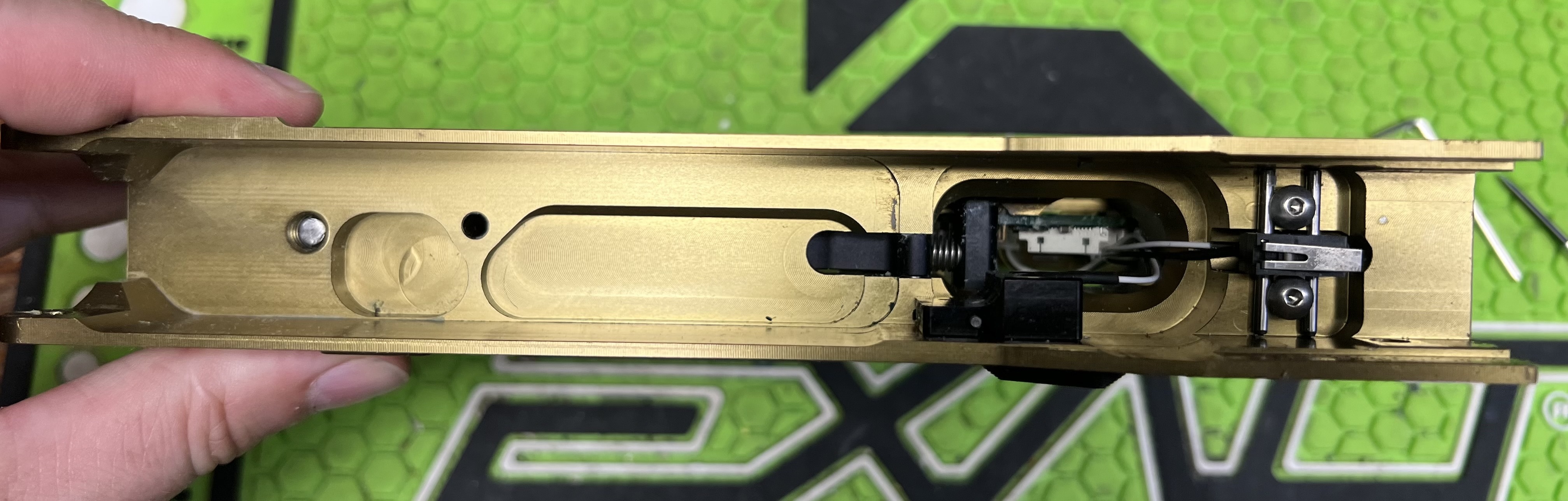

      And here is the bottom of the upper have, including the solenoid:

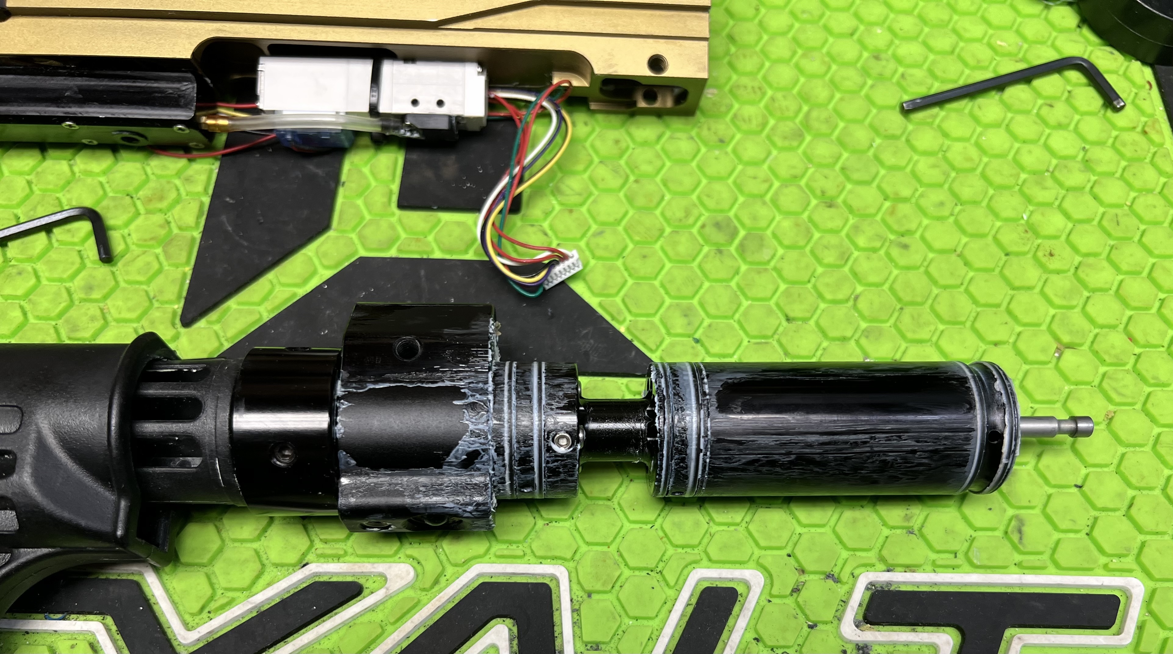

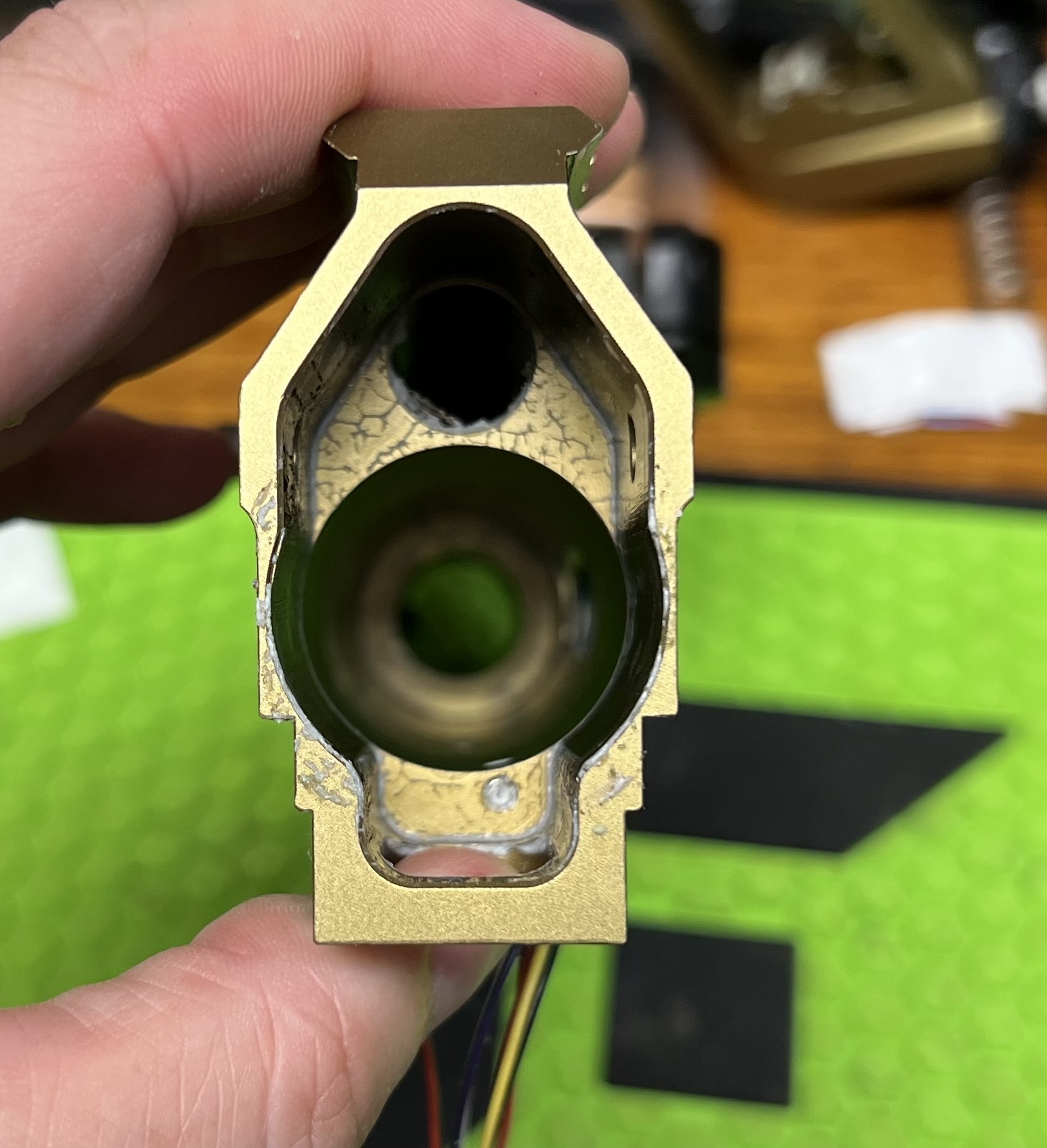

        Next step is to try to get at the bolt engine. So to do that we need to remove the stock, so the two body bolts need to be removed. Once removed the bolt engine slides out with the stock as a solid unit.
        And now the body is empty, aside from the detents and eyes.

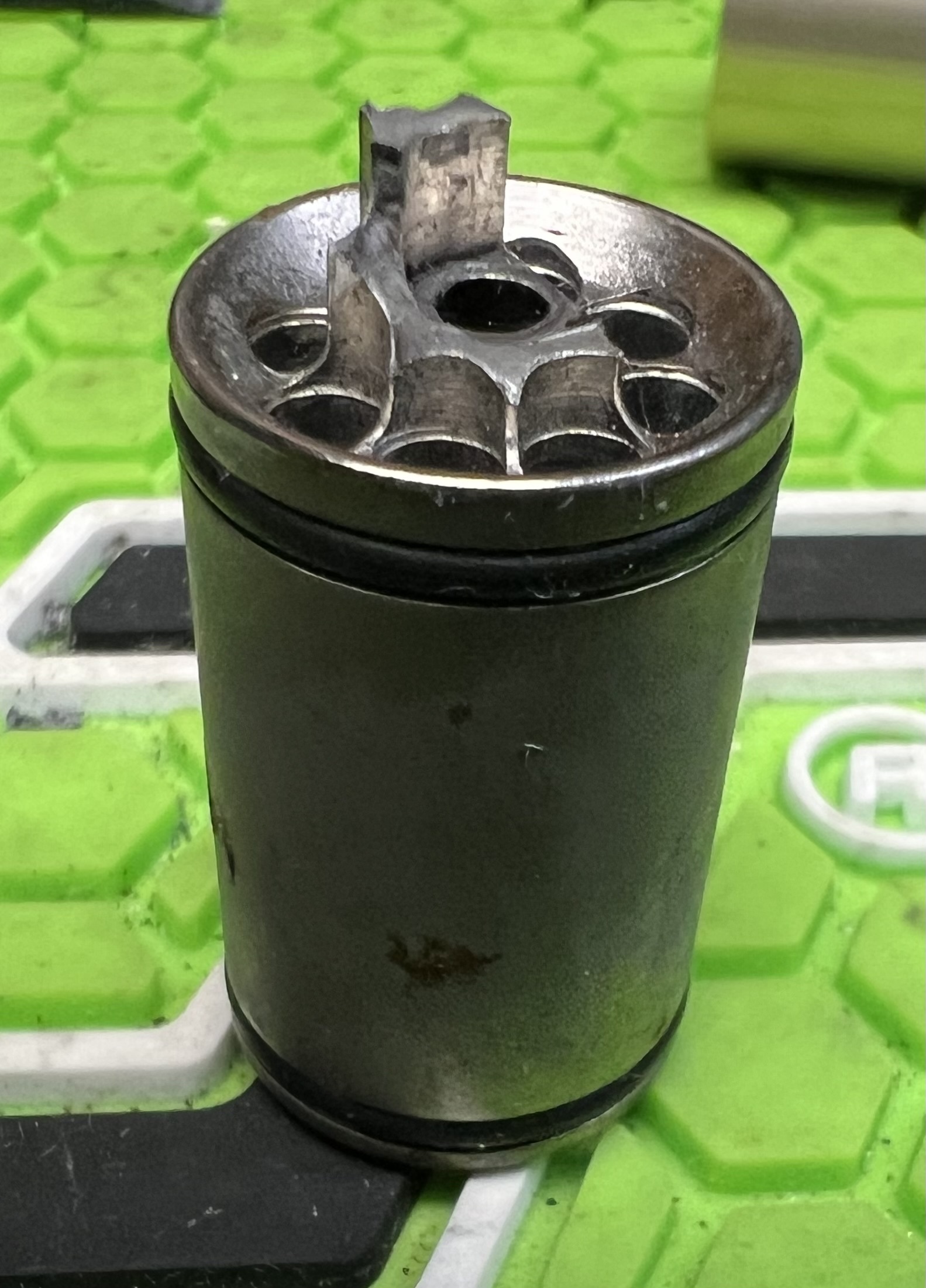

          Cdn_Cuda commented
          Seems like I’m missing the bolt…. Hopefully it’s in the case. There was a bunch of extras with it.
        • RPP
          RPP commented
          Yes. Missing the bolt "tip".
          Cdn_Cuda commented
          It's always just the tip.... I was thinking having a rod in the middle of the drivetrain seemed awfully strange.

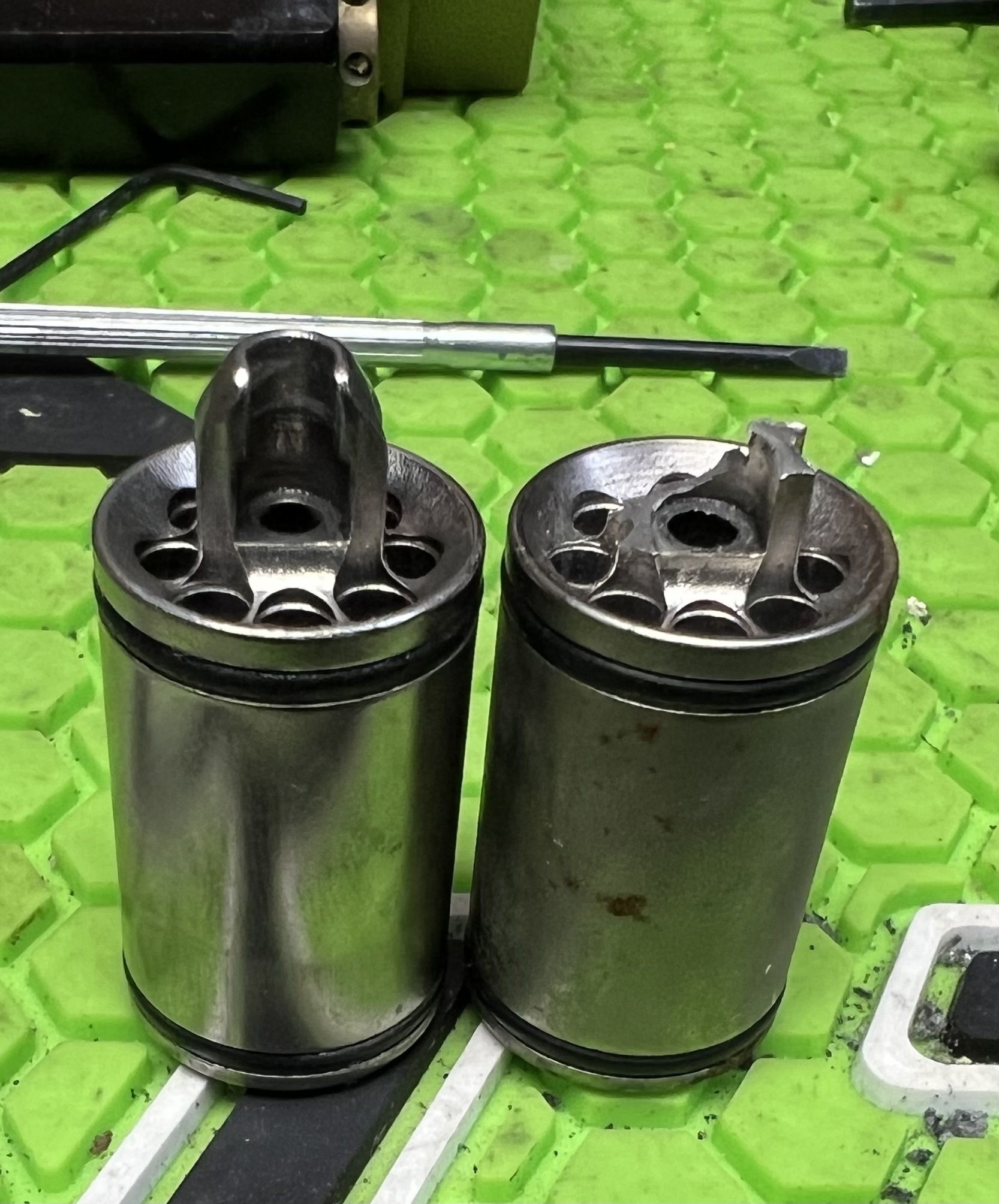

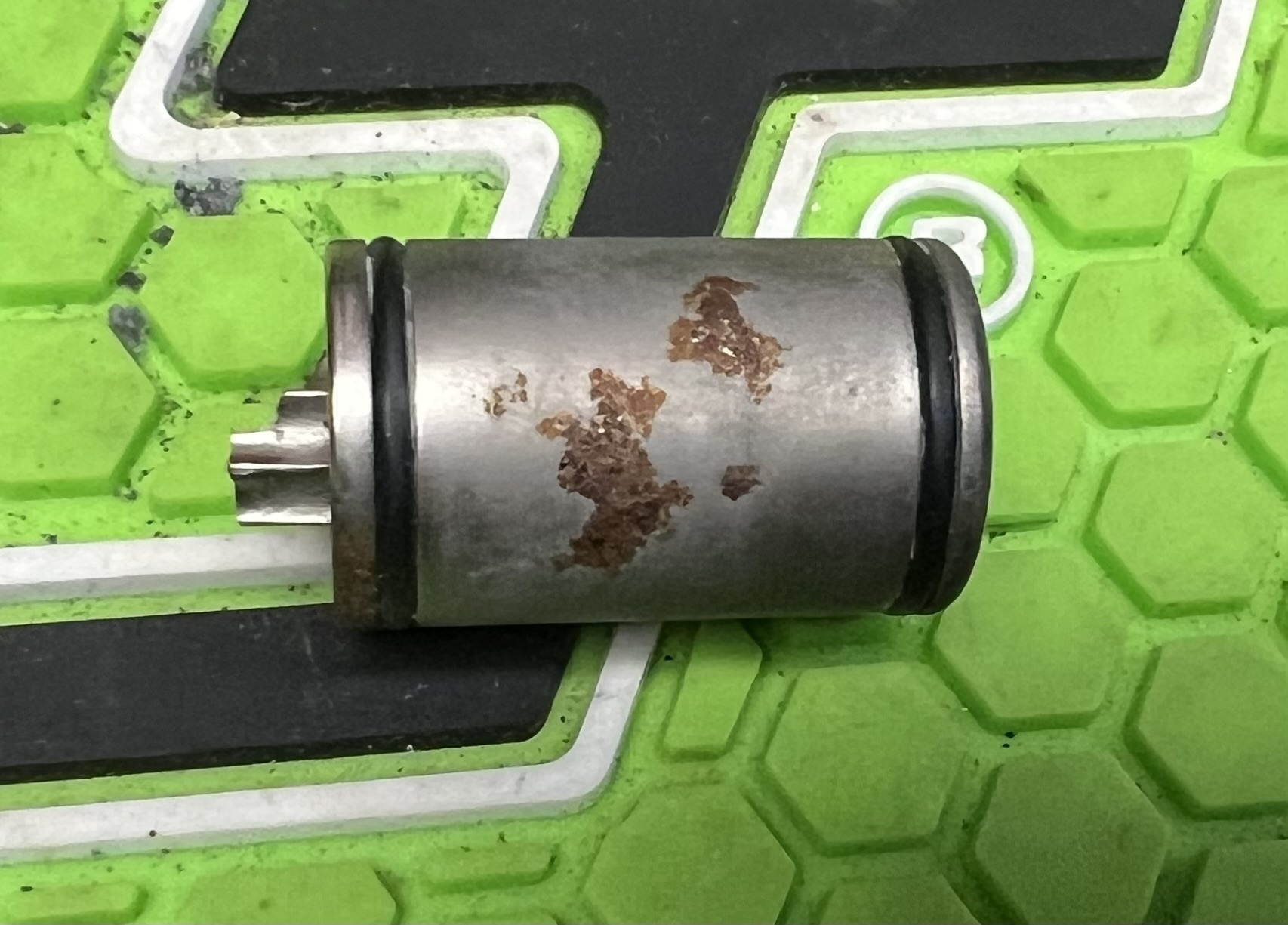

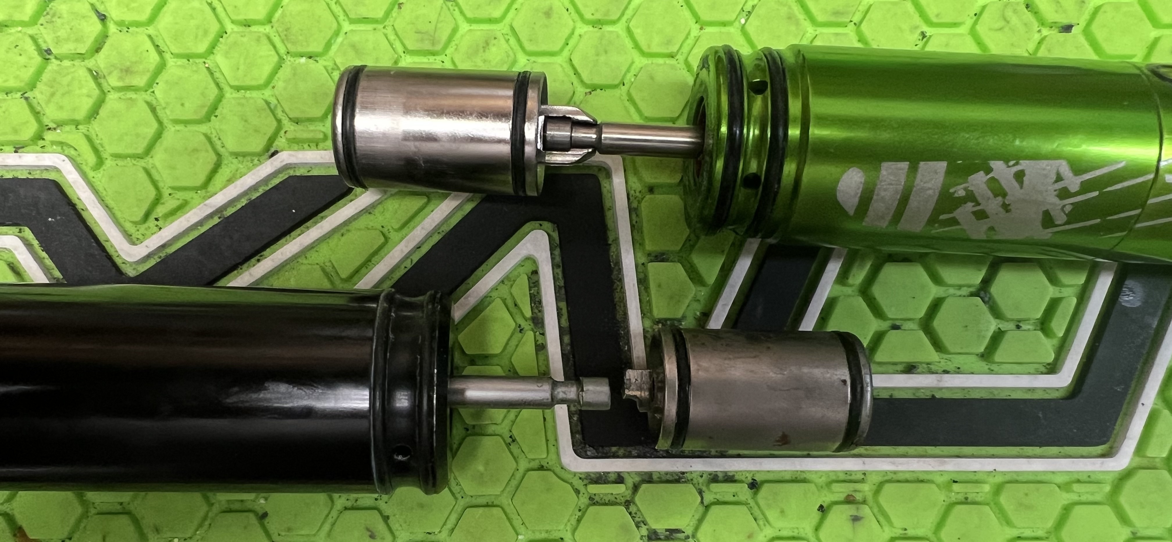

        Good news, bad news! I have a bolt, but it’s broken. Likely the reason it was not in the marker. Good news is it’s the same bolt as in the Bob Long Victory I am also working on, so I can just use that bolt.

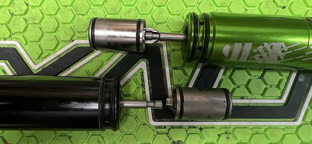

            So here is what the bolt is supposed to look like:
            Click image for larger version  Name:	IMG_4235.jpg Views:	0 Size:	600.1 KB ID:	724298

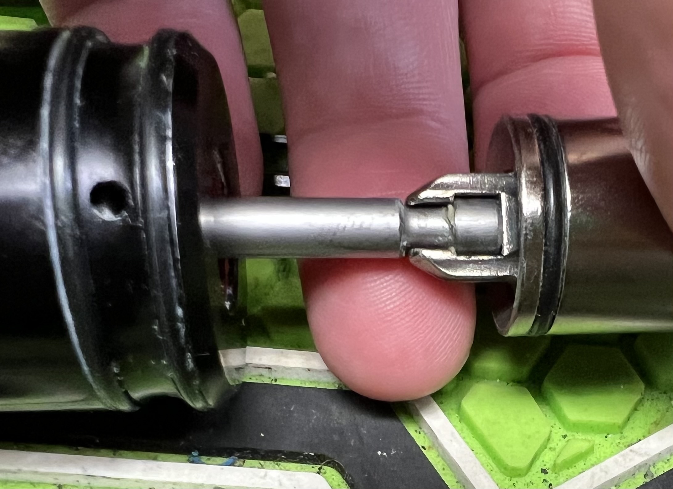

            And this is how it connects to the engine, just kind of cupping the shaft.
            Click image for larger version  Name:	IMG_4236.jpg Views:	0 Size:	517.0 KB ID:	724297
            Can’t say that this is my favourite bolt design.
            • Frmrspec
              Cursed to tinker
              • Jun 2022
              • 583
              It always seemed janky to me but when you consider the breech is holding everything inline, it doesn’t seem as janky.. plus screwing the halves together on the VIS is annoying AF
                • 6381
                Originally posted by Frmrspec
                It always seemed janky to me but when you consider the breech is holding everything inline, it doesn't seem as janky.. plus screwing the halves together on the VIS is annoying AF
                No it still seems janky to connect the bolt that way. The few I've seen I've always been concerned that that's a weak point and here we have proof that it is
                  • 4560
                  Trbo323 agreed. High rate of fire + janky connection = failure. And it looks like trying to source another bolt tip is a difficult task.
                    • 4332
                    It's only weak if you make it impact something other than paint.
                    Half the time I saw these break were because some dope shot with a squeegee in the barrel or breech to muffle sound while dry firing​
                    • Frmrspec
                      Cursed to tinker
                      • Jun 2022
                      • 583
                      Just don’t take a look at the proficiency engine quick disconnect lol.. that one was like an .08” ball
                      but in all seriousness it wouldn’t take much to make a threaded version of what you have.
                        • 6381
                        Sure but, the majority of other markers don't break the bolt if you have a squeegee all the way down the barrel.
                        They also don't use this slide on connection thing either
                        If I were a detective wondering if it's a jenky connection that could be weak, I'd call that a clue
                          • 4332
                          I've never broke this version.... The earlier marq quick release bolts I have, they were even thinner but Bob stopped making that design.
                          To be entirely honest though neat looking fast and somewhat efficient the marqs in general were atrocious
                          Each version had so many quirks that eventually they nuked the poppit idea and went fully spool valve....which has its own quirks. While I was sponsored I only used the marqs because they wanted me too, I generally ran older timmys unless I knew there was a photographer at the event
