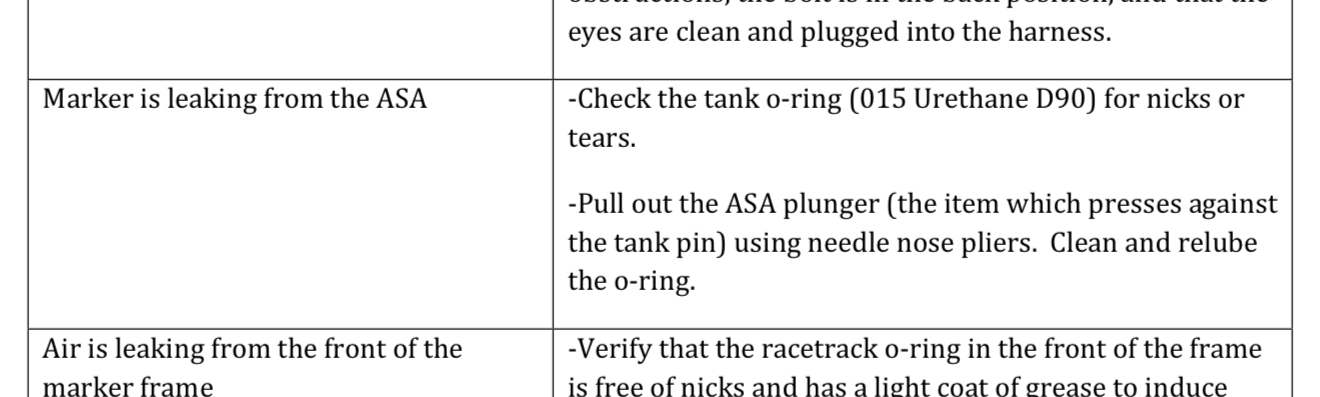

    What's the most common cause of a G6R to be leaking out of the asa?

    That’s right from the manual I think if u take the asa off there’s an oring there too ( asa to frame oring )

        Did you get anywhere with your leak? I have a leak on a 2k11 ASA that I can't figure out. I have replaced all the orings. I can't tell if the leak if from the air transfer hole or the pin hole on the ASA when it is on the gun. All I know is it is leaking between the ASA and the bottom of the frame.
          • 6380
          Did you use the Urethane D90 oring? It’s stiffer different oring than a standard black bunna.
            I used a 70 duro buna like the manual calls for. I will have to order a 90 duro buna or urethane because I have neither. Are you talking about the ASA plunger oring?
              I was talking about your tank oring
