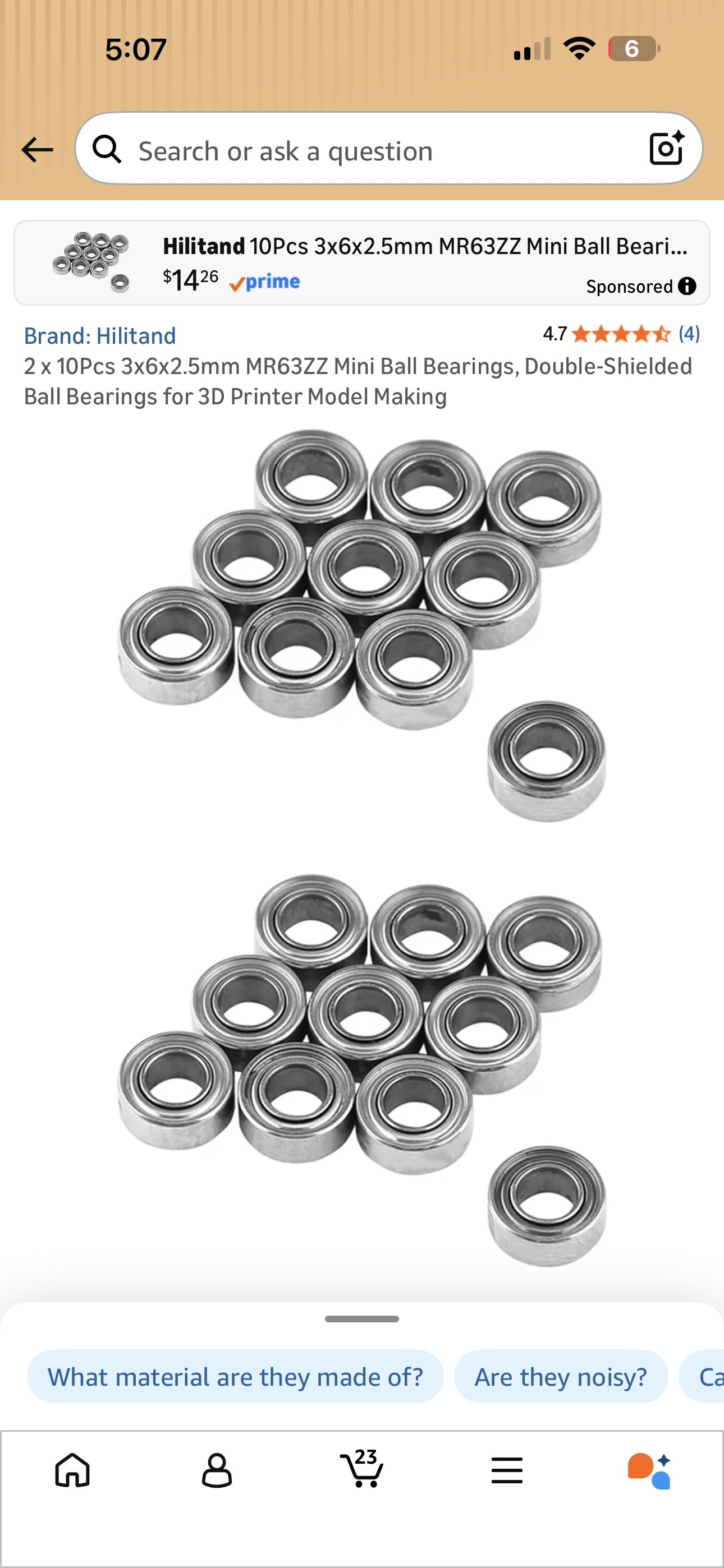

    Can anyone help me confirm if these are the correct size for an mvp pump arm… these are the numbers I got with my calipers but the center is small and I may not have got a proper measurement . I’m not gonna buy them from blastlegacy at 5$/each .. I’m in Canada and it would end up costing close to 100$ after shipping for a set of 12’.

    Are you able to measure the rod/pin/dowel that goes inside the bearing? That would be easier to measure with calipers.

      No need, I can indeed confirm these are the correct bearings , if anyone needs a set , I recommend , they’re dirt cheap, and the difference it made was worth the 15$

        Nice, good info. It's always good to find the cheap (sometimes better) mass-produced spec part for paintball without paying the boutique paintball markup.
